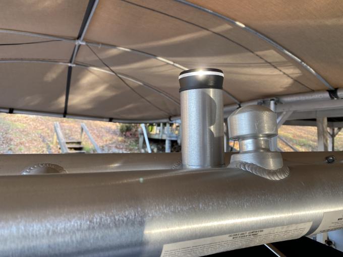

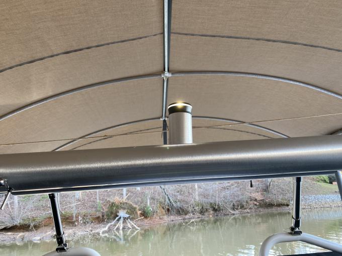

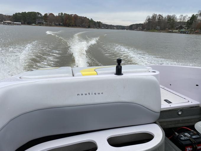

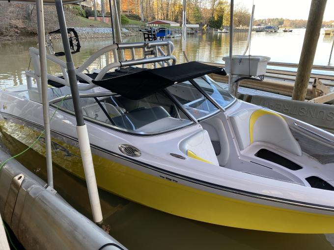

I also went ahead and installed the tower all-around white light today, and removed the original telescoping stern light (which I will repurpose on the Blue Bomber). Wiring for the tower light was fun, but it is done now, and everything works!
Did you have to replace the top center section of the tower for that? What brand light is that? I like the way it looks!

That’s the Roswell light that comes with the tower. I believe they sell it on their website
https://www.roswellmarine.com/product/anchor-light/

No story, really. The boat originally had the optional telescoping stern light. That's a cool option (I had it on my 2003 210). I figured I'd just remove it and splice into the existing wires for power to the tower light. The weird thing was that there were THREE wires for the original light. I guess maybe one runs the motor that raises and lowers the light. I had to use a meter to figure out which wire was which (since I had already cut them at that point), but I eventually got it all figured out.Please do not PM me directly asking for advice on how to repair your boat. While I would love to help everyone, I simply do not have time to respond to all of the inquiries. Please post your questions on the forum, so that all of our members have a chance to answer.

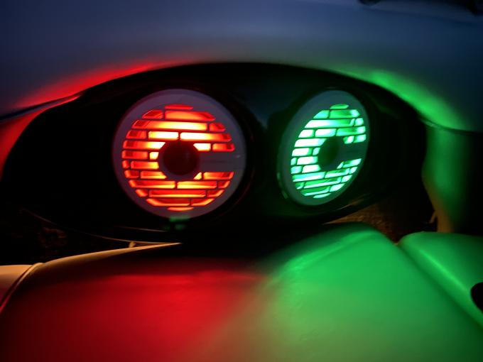

Did some interior cleaning and reinstallation, along with the Roswell R1 speaker installation today. The inside is finally starting to look good again!
Here's the nose piece with the speakers installed.

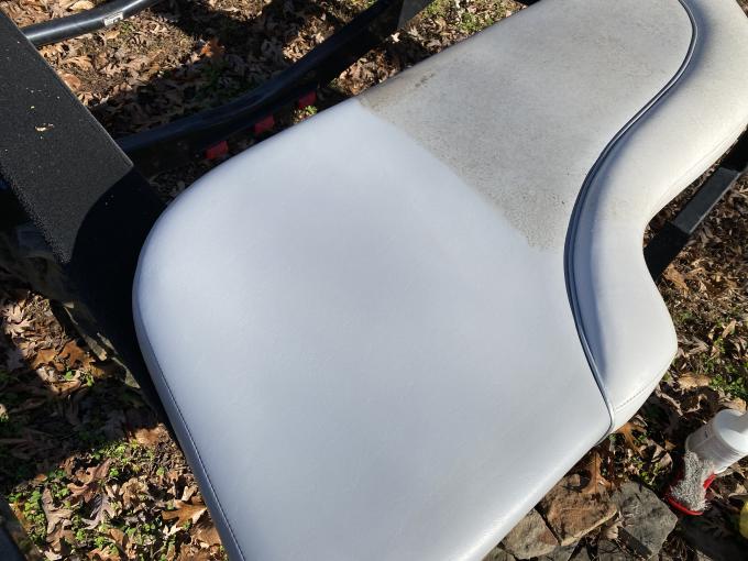

Here's the cleaning difference on one of the interior cushions. Spray Nine Marine is the stuff!!!

Got the Roswell R1 speakers configured for the season too!
