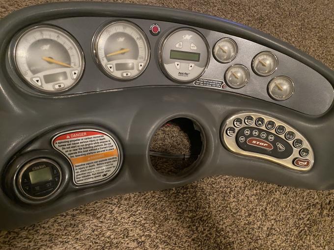

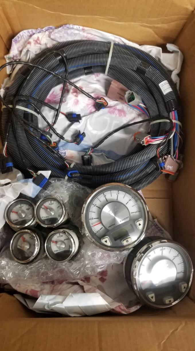

Since the 2003 voltmeter and tach are unobtainable from dealers these days, and the gauges I have are quite weathered, I went looking around for a complete replacement set from someone who had done a gateway bypass. I found a full set of gauges from a 2007 that will fit great, look great, and they are plug-and-play with the 2003 gateway!
These gauges are now on their way to me, and I should have a fully-functional dash again soon! (Oh, and I can use one of the blue rubber seals from the wiring harness that will come with these gauges to replace the crushed one from my harness, too.)

So, I got the new set of 2007 gauges, which should be a direct replacement for the original gauges in this boat, but of course none of them work. I assume the guy that sold them to me had a bad gateway, and maybe it fried his gauges while it was in the process of failing. I am going with the assumption that he didn't know they were bad, and I have asked him to take them back for a refund. We'll see...

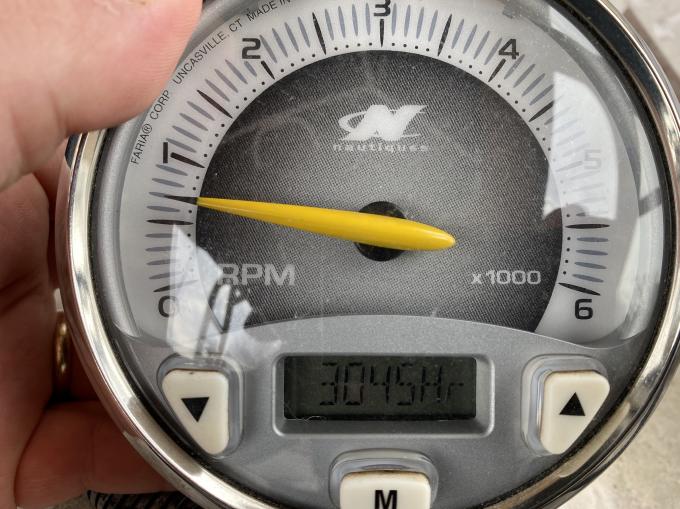

The new tachometer works fine, which proves that my gateway is good. The only issue with the tach is that the decimal point is out on the display!!! This causes it to look like the boat has 3045 hours on it instead of 304.5 hours! Race City Marine has two others that I can try though, so hopefully one of those will be perfect. Now to find the voltmeter...
No decimal point!! 3045 Hours (should be 304.5)!!

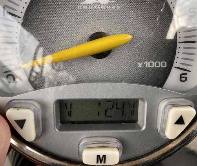

No decimal point!! 124 Volts (should be 12.4)!!

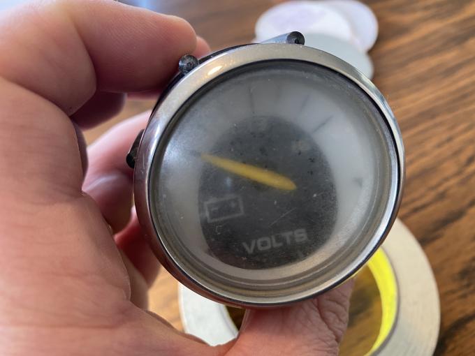

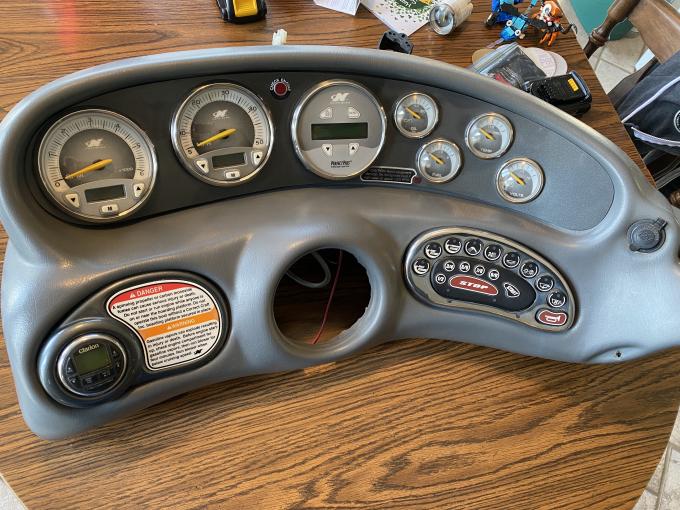

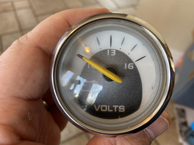

Ok, dash is ready to go back in the boat now. Tachometer has been replaced with a fully-functional unit in good shape, Voltmeter has been replaced with a fully-functional unit in good shape, and the rest of the original gauges have been polished up with a headlight restoration kit (which worked quite well).
Here's the old voltmeter before and after:
And here's the finished dash, ready to go back in the boat.
