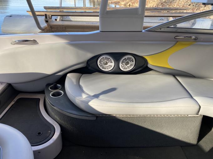

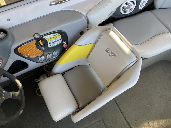

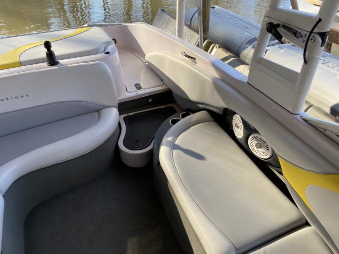

Here are some interior pictures. It still needs more scrubbing, but it is starting to look good!

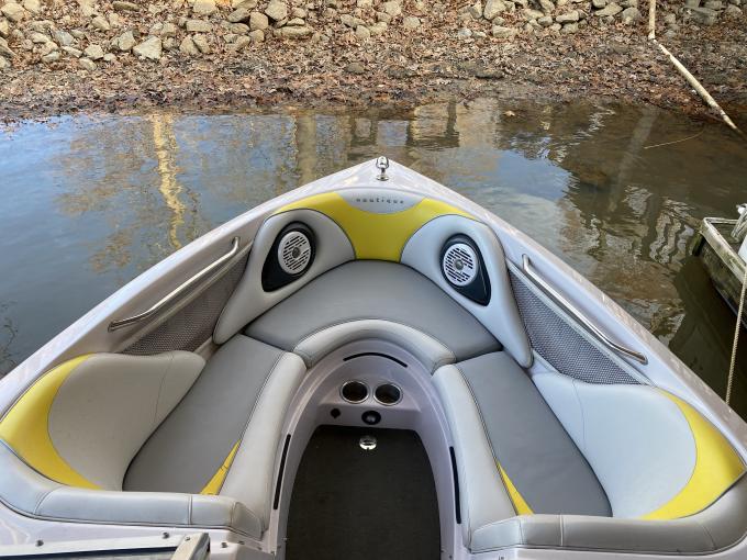

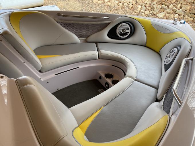

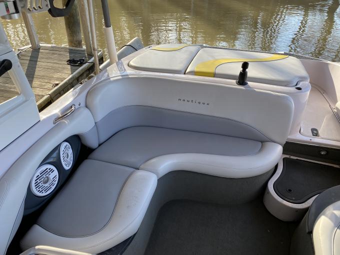

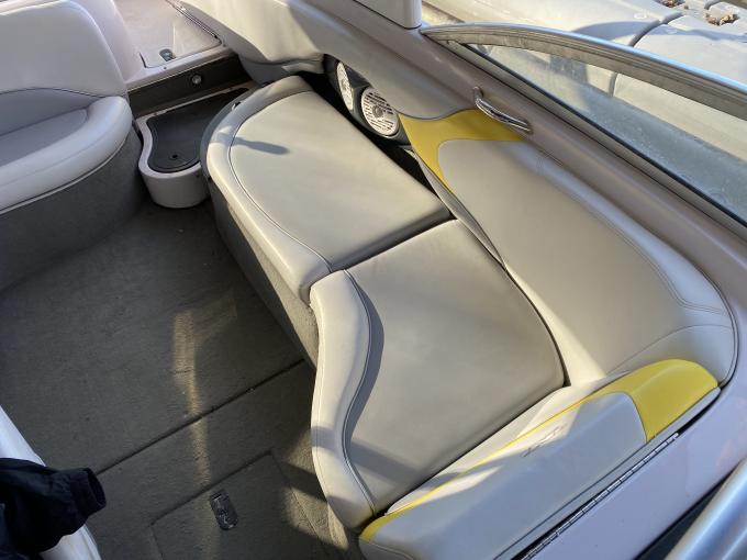

The bottom bow cushions had some cracking in the yellow vinyl, so I had those three reupholstered locally. They came out great, and the yellow is perfect now.
This was probably not a cost-effective repair, since the only issue with those cushions was the small bit of yellow, but they look great now, and the next owner will appreciate it.

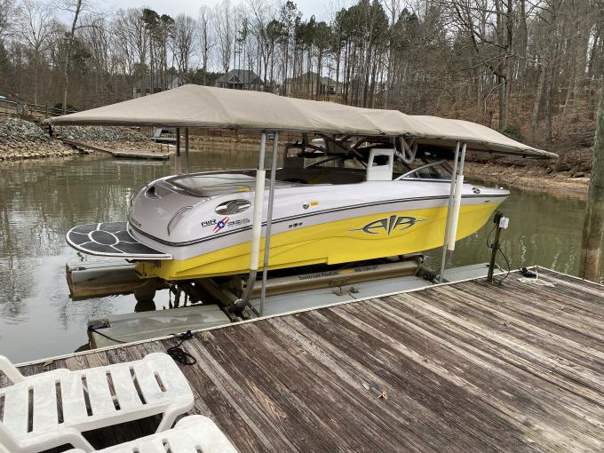

I had to move my lift to the other side of my dock today. They're draining down Lake Norman right now, and the right side of my dock is sitting on the dirt! I love that this lift can just be pulled around and tied up wherever.

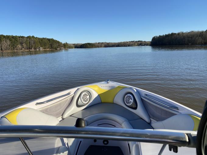

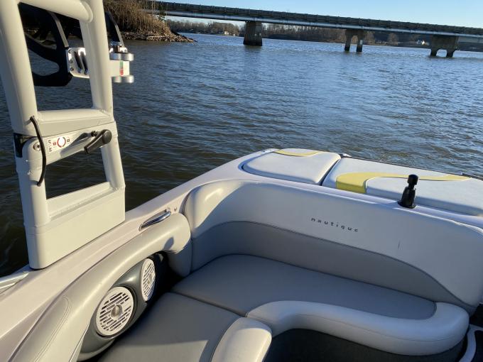

Did a little more test driving in this boat today. It was too nice today to just let it sit on the lift!
It looks great Jeff! There are not many Nautiques that I don't like, but they look especially good after renovation.Ski on dude!
