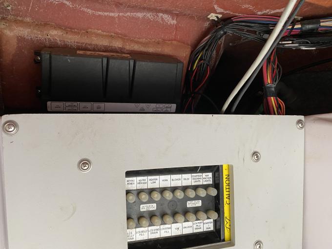

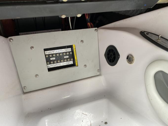

I did get the PME box remounted in its proper place. It was loose behind the dash when I got the boat.
You can see the gateway box behind the PME. I was very concerned that the replacement engine we're installing wouldn't work with this gateway, since the engine is substantially newer than the original engine. PCM confirmed today that the new engine will work with the existing gateway, however PerfectPass will no longer work. We'll be converting this boat to Zero Off.

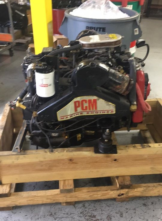

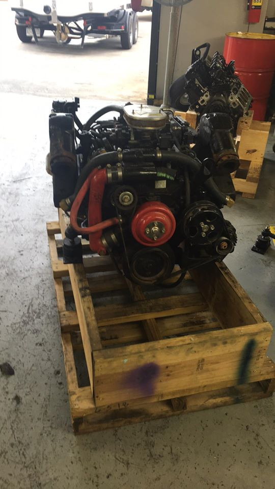

This boat is at PCM right now, having the engine replaced. Can't wait to get it back!
Old engine is out!
New one should be installed soon.
What's a cracked block motor worth? Does it have value as a part out?

There are plenty of good parts on that engine. I'll be bringing it home to part out.Please do not PM me directly asking for advice on how to repair your boat. While I would love to help everyone, I simply do not have time to respond to all of the inquiries. Please post your questions on the forum, so that all of our members have a chance to answer.

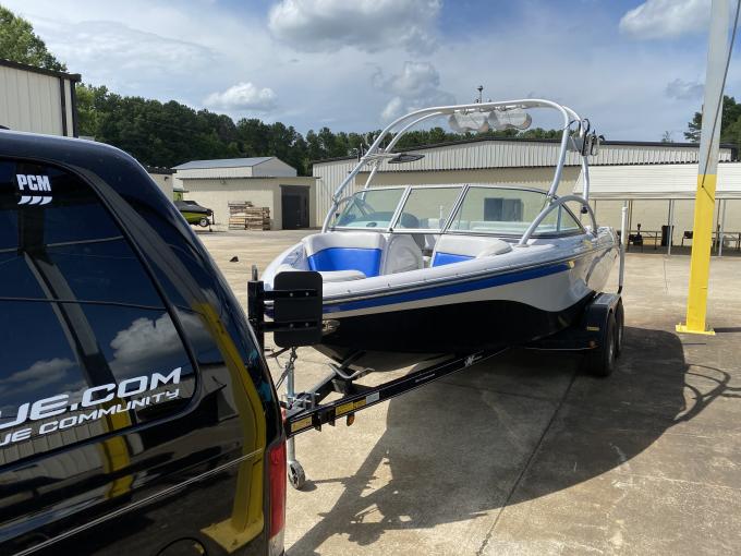

Well, the pressure is on to get this one wrapped up quickly! The new owner is coming to pick it up on Wednesday!

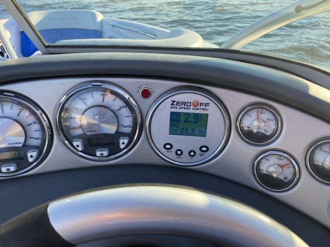

I just picked it up from the guys at PCM today, and the new engine they installed seems to be working great. It has a total of five hours on it!

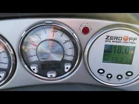

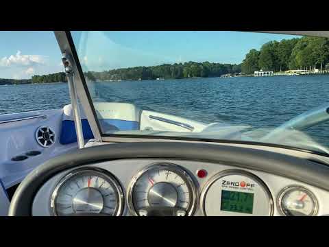

The Zero Off conversion is complete, and works great. This is one of only a very small number of boats from this era that has Zero Off. Only a replacement engine will allow ZO to be installed in boats this old.
I took it out for a test run this evening, and will wrap up my list of things to fix tomorrow and Wednesday morning.

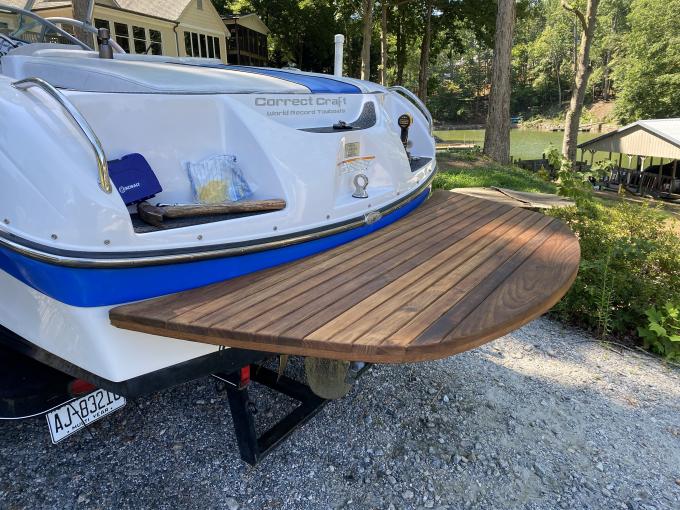

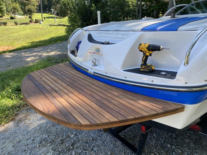

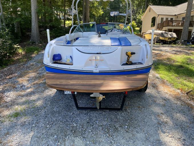

I just mounted the new teak platform using all new brackets.

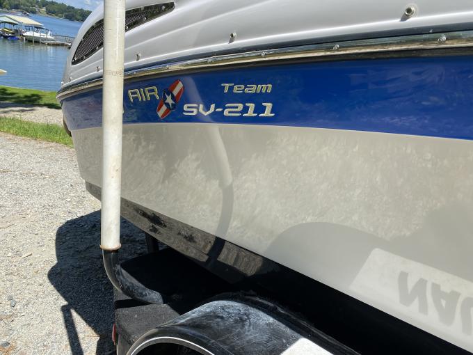

Got the small side decals on. The new owner doesn't want the big side Air tribal graphic installed.

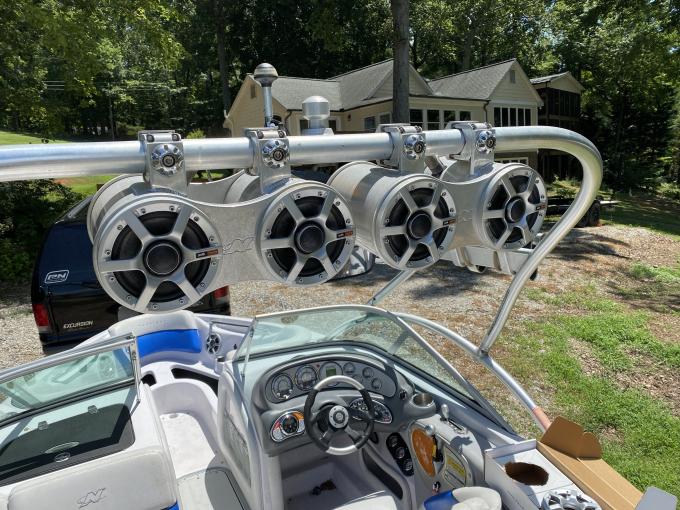

Tower speakers have been replaced with a set of known-good spares from another PN member. No more blown tweeters!

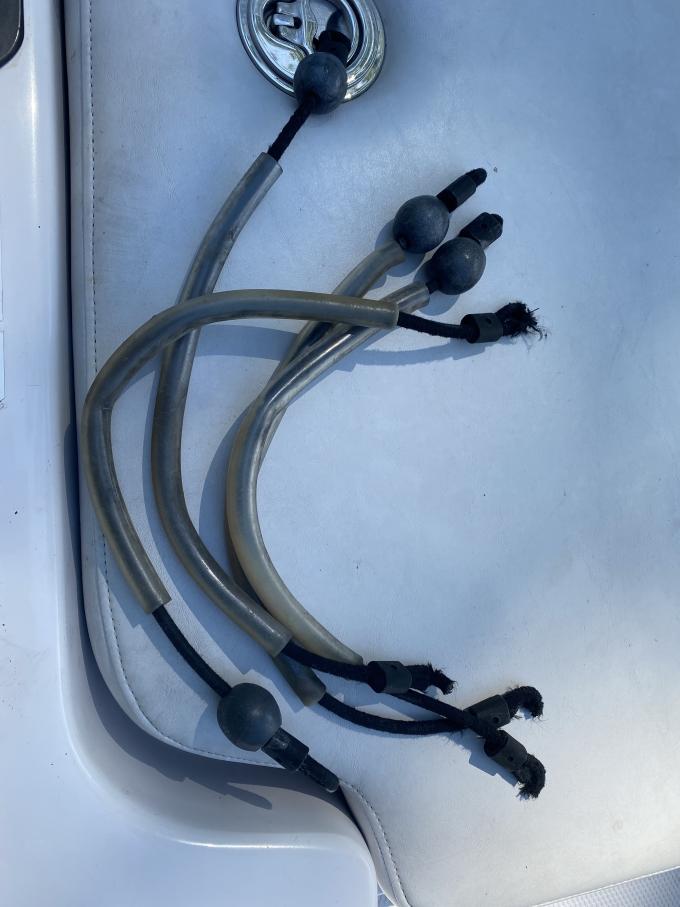

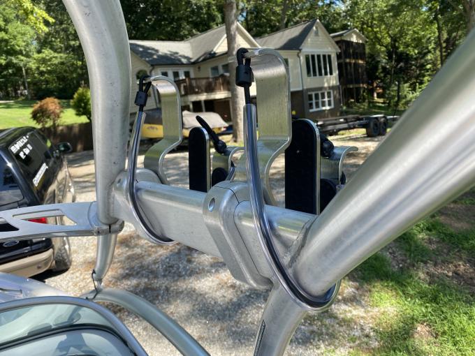

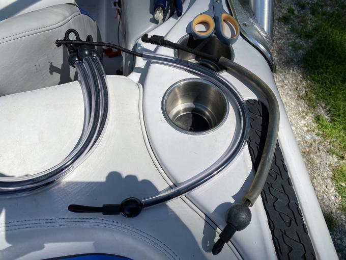

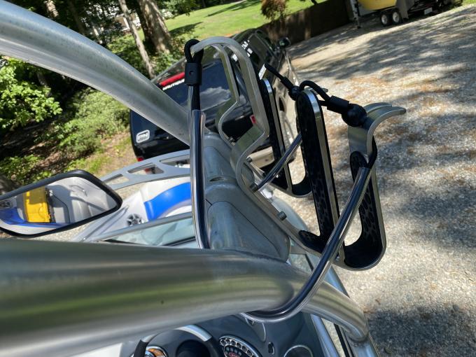

Just completed rebuilding the Flight Clips with new bungees. This was not too difficult, and the kits from NP are only about $25 per side. If you need new bungees on your Flight Clips, you should do this!
Here are the old ones:
Here are the new ones next to an old one:
Here they are installed:

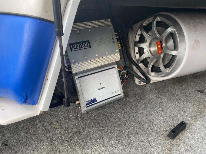

The interior speakers and the subwoofer were not working on this boat, so after troubleshooting the original Clarion 480M amp, I just decided to replace it with a Kenwood KAC-M8005 Marine amp. Once I did that, everything worked just fine. Still needs a good cleaning, but at least we have full audio now!
Originally posted by fsts2k View PostDid the amp power on but not give any output?
I would have replaced it with a used 480M if I could have found one. I like to keep things stock unless I am really doing an upgrade. I couldn't find a 480M, so this Kenwood class D was a good alternative, and it took the same type of connections that the 480M did, so it was an easy swap.Please do not PM me directly asking for advice on how to repair your boat. While I would love to help everyone, I simply do not have time to respond to all of the inquiries. Please post your questions on the forum, so that all of our members have a chance to answer.
