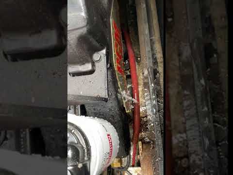

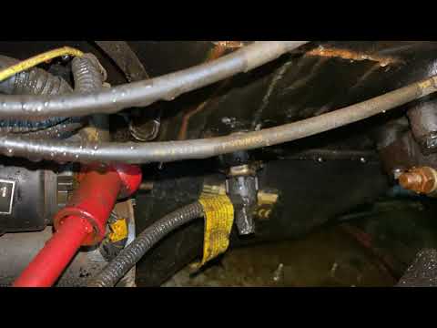

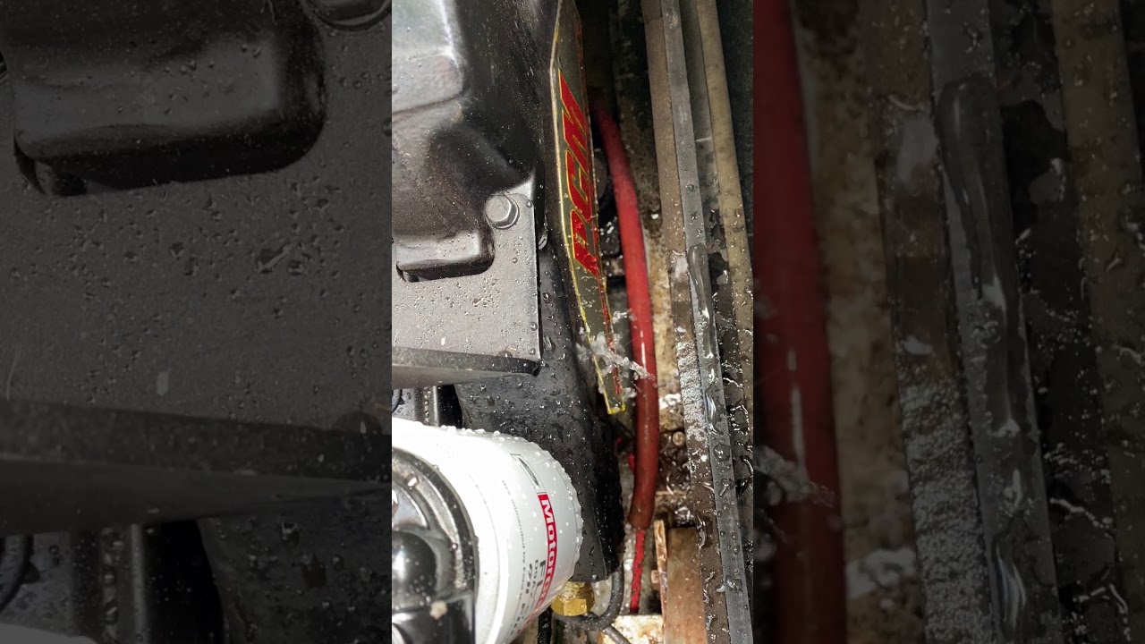

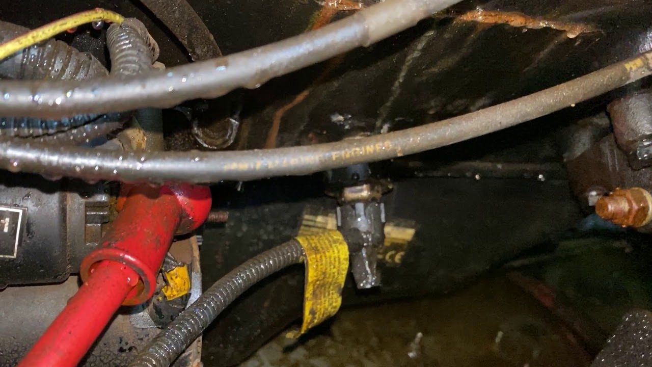

After all of the electrical work I did, I dropped the boat into the water on my ramp, and started it up. It was leaking water from the back of the engine, but I found a hose that wasn't connected properly, and I easily fixed that issue. I started it up again, and it started leaking water from the side of one of the exhaust manifolds. There is a freeze plug there under the decal, so that gave me a really bad feeling when I saw water there. I pulled the decal off of the side of the manifold and found the freeze plug loose and stuck to the decal. Not cool. I popped the freeze plug back in and started it again, and there was water coming out of a big long crack in the block.
Yep, whoever had this boat before me did not winterize it properly, and the block is ruined.
Looks like this boat will be getting a replacement engine...
Here's the crack. At the time of this video, the engine had been off for about ten minutes, and it was still leaking from the crack.
Here's the blown freeze plug under the decal on the manifold.
