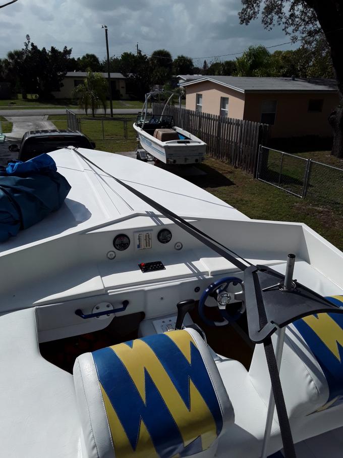

just brought home a 1979 ski nautique in need of a rebuild.
the driveline is intact, all hardware is accounted for.
the electrical is just old and dirty but looks like half a rats nest, the stringers and floor is totally rotted as well as the seats.
