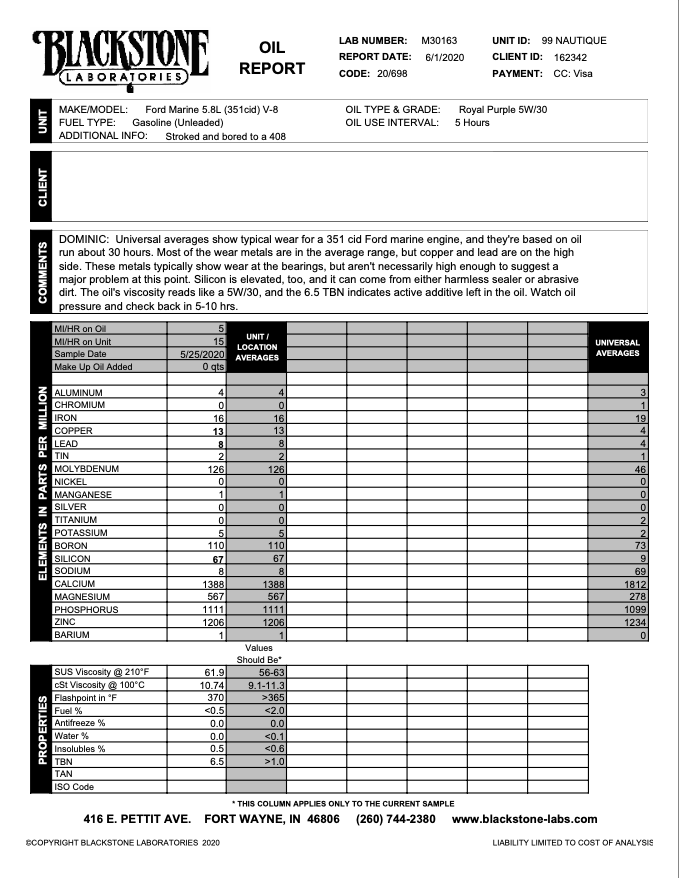

                        The oil test came back today from Blackstone. I think the writing is on the wall but I’m not sure.
                        “Universal averages show typical wear for a 351 cid Ford marine engine, and they're based on oil run about 30 hours. Most of the wear metals are in the average range, but copper and lead are on the high side. These metals typically show wear at the bearings, but aren't necessarily high enough to suggest a major problem at this point. Silicon is elevated, too, and it can come from either harmless sealer or abrasive
                        dirt. The oil's viscosity reads like a 5W/30, and the 6.5 TBN indicates active additive left in the oil. Watch oil pressure and check back in 5-10 hrs.”
                            Do you have a link to the oil testing place you used?

                              #209
                              Search for Blackstone oil test. Popular service, should be an easy hit.

                                #210
                                Here is how they deliver the results and what they test for:
Name:	Screen Shot 2020-06-01 at 8.27.23 PM.png
