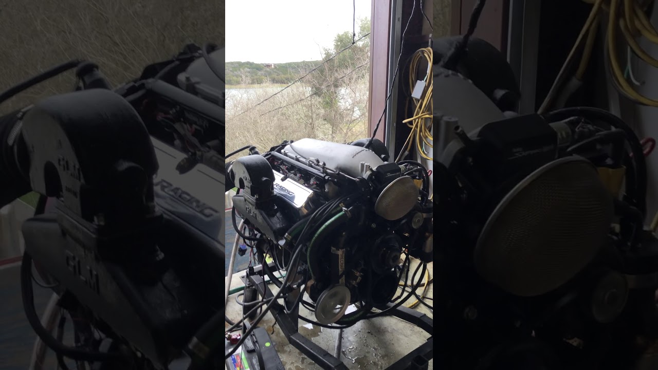

                        Originally posted by dhmcfadin View Post
                        Bob got the new intake manifold intalled and I got to see the engine on the dyno. The intake swap transformed the hp and torque curve. I lost a little torque down low but widened the power band significantly. Peak HP 438.2 at 5500 rpm. Peak TQ 460.2 at 4200 rpm. At 5200 rpm I gained 90.2 hp and 91 ft lbs over the GT40 intake. Below is a video of the dyno run. Doesn't tell you anything but it sounds nice!
                        dhmcfadin I was looking at your dyno charts and don't see how you came up with the 90 hp and 90 ft lbs gains with the Holley over the GT-40. I'm not nit picking. I'm just trying to understand from where the numbers came. I assume you used the factory engine specs to compare the rebuilt engine dyno runs.
                        The power band maybe not as good as it is with the Holley intake, but the HP/Torque curves you got with the GT-40 look like a perfect match for a tow sports boat. Clearly from the numbers, the Holley flows way more air and will keep screaming all the way to the rev limiter.
                        I know you went with after market pistons and increased the displacement to 408, but what else did you do? Just heads and cam? Did you get to 408 by stroking it, boring it, or both?

                            #163
                            So the dyno chart was comparing my 408 with a GT40 intake and my 408 with a Holley High-Ram intake. All other parameters equal. Yes, the gt-40 made torque more like a ski boat engine but what you don’t see is below 3000 rpm. The gt40’s torque ramped up quickly and fell off quickly. The power band was very narrow. I was willing to sacrifice some peak torque for a drastically wider power band and more torque across the entire power band. Not talking peak numbers. I’m talking the overall power band. One of my goals with this boat was to run 53.1 mph. That number comes from adding 10 mph to this boats top speed when it was tested at Correct Craft. Why? Because I wanted to lol. No other reason. I wouldn’t have been able to get there with the gt40 intake.
                            I came up with my numbers by looking at the biggest power differences at the same rpm. At 5200 rpm, I gain 90.2 hp over the stock intake. At 5200 rpm, I gained 90.9 ft lbs over the stock intake. It’s this jump at 5200 rpm that will get me to 53.1 mph.
                            We got to 408 cubic inches by both boring and stroking. Every single internal component of the engine was replaced.
