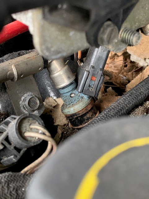

    The boat last ran in the water in 2015. That summer the engine started having issues. At cold start it would run fine, but as it heated up it would "bog" down like it wasn't getting enough gas. By the end of the summer it wouldn't even stay on plane once it was warm. (Not firsthand experience...this was provided by a friend who drove it last that summer). I suspect a bad ECM or fuel line issue per threads here at PN.

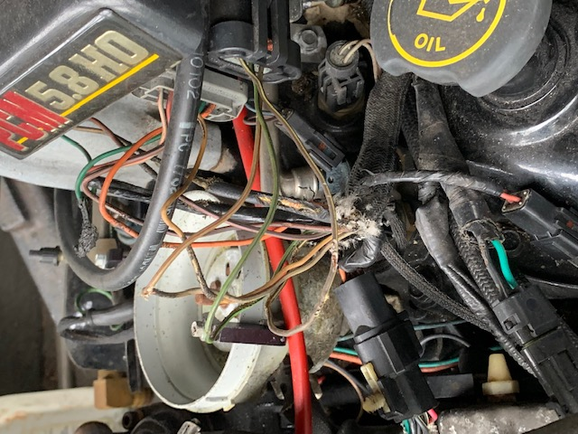

    The following winter mice got into the engine compartment and did some damage to wiring harness. The local Nautique dealer quoted $1800 CAD for a new harness and the summer camp who owned her just parked her as she was replaced with an '08 SV211. She's been parked ever since.

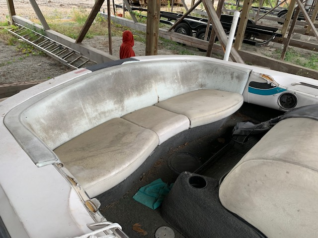

    The interior was already pretty bad in 2015, but has gotten worse as she has been in storage the last 4 years. Some of the vinyl appears to have been replaced at some point as the rear couch and engine cover are pure white without original accent colours.

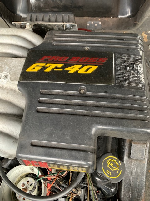

    As a 96, she has the PCM 5.8 HO ProBoss with EFI (351w @ 310hp). It appears that the transmission has been replaced with a newer PCM IRM40-2A at 1.258 ratio (vs original 1.23).
    She currently has a 4 blade prop. I also have the original 3 blade prop and a spare drive shaft. I'm assuming the drive shaft came off the original tranny.

    • Repair/replace wiring harness

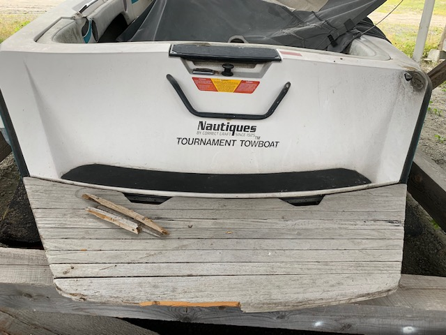

    • Sand and rebuild teak swim platform

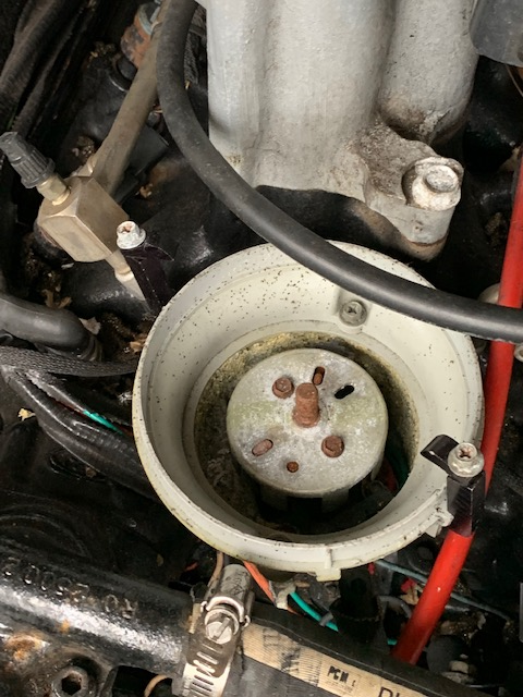

    1. The ProTec ignition system was only 93-95, correct? From what I can tell, the 96 did not use ProTec, but I'm not 100% sure. How do you tell if you have ProTec system? (Appears no ProTec according to Jeff in another thread)

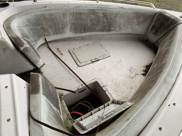

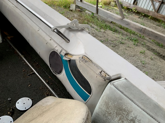

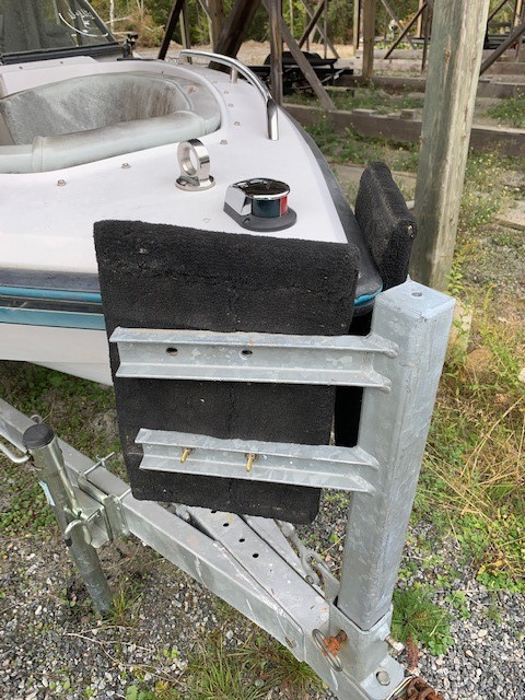

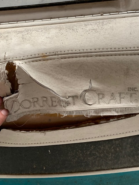

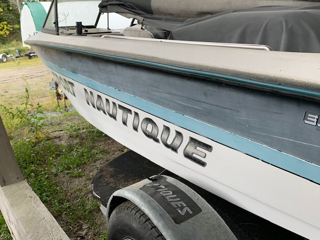

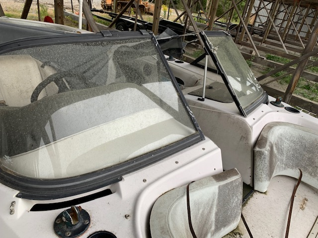

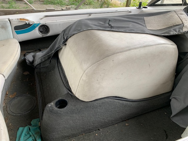

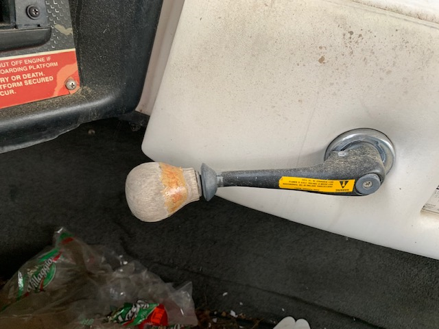

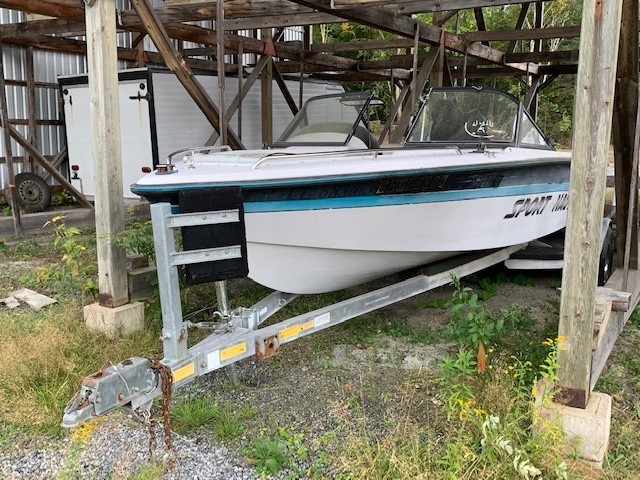

    Here are some pics of her current condition:

      Welcome! I had a 94 Sport Nautique which had a failing Pro-Tec, and more recently have a 95 super sport with a gt40 that gave me a few hiccups last year that Ultimately ended up being a bad ECM. You’ve got quite the project on your hands but with some elbow grease it’ll clean up! You have a GT40 engine so it is not a pro-Tec ignition. Rough running on a GT40 can be a lot of things, from fuel delivery (anti siphon valve, fuel pump, or injector issues), spark (distributor cap, plug wires, plug, pip sensor, ecm, etc), to major compression or mechanical issues but I’d start by googling poor mans gt40 diagnosis and downloading the pcm gt40 service manual. Taken Together you will learn a ton about the engine operation and there are a ton of symptom/ fix descriptions between both resources.
      As for the tower, someone put the original FCT on your boat. I don’t believe the FCT was around prior to ‘98. Finding a diff. Tower that bolts up in the same holes will be tough since it was placed more or less by hand and there isn’t a standard mounting pattern. I’d plan to fill the holes and start over with a tower of your choice, like a new dimensions tower or Roswell aviator but those are speedy. The upside is you can get gelcoat patch kits in your hull color from nautiqueparts and with a little care, prep, wet sanding and buffing (you are doing this anyway) you won’t hardly know there were any holes there.
      Keep the progress pics coming!

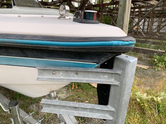

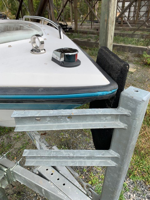

            Trailer Woes
            So yesterday was a beautiful fall day and I had a quick business meeting in a town nearby where the boat is currently stored. I've been really wanting to weigh the boat to see if there is any signs of soaked foam under the deck. I'm not worried about rot since she is fully synthetic, but I have read other stories here about cracks in the thin fiberglass deck that still results in significant hull water.
            I started my day with a quick stop at Home Depot to get some bolts to reattach one of the Ram-Lin bow rests. I also grabbed a chain. I don't know the story, but one of the support panels was missing (found it inside the boat) and the boat was resting up on top of the bow support pillar(see pics below). I used the chain and attached one end to the truck and the other to one of the transom lift rings. It took 1 small pull of the truck to pull the boat backwards about 6 inches on the trailer and back into the correct position. I then reattached the missing bow support panel on the trailer.
            Next I dugout the trailer lift winch (not sure what you even call that) as it had sunk about 10 inches into the ground (visible in pics). I hooked the trailer up and pulled the boat out of the shed it was in for the last 4 years. I was surprised the tires were still mostly inflated as it was hard to see them before I pulled it out. The leaf springs in the trailer are in desperate need of replacement but I had enough clearance between the wheel fenders and the tires for the 8 mile run down to the nearby quarry to weigh the boat.
            I was pretty optimistic about how things had gone so far as I pulled onto the road and headed to the quarry. I took things super slow as I was on bumpy back roads and knew the leaf springs were mostly shot. With 1 mile left to the quarry scale, I glanced in my rear-view mirror to see the left wheel start smoking like crazy. It was definitely an oh sh%t moment! At first I actually thought the tire had caught on fire. My mind started racing to remember if I had seen a fire extinguisher in the boat. I pulled over and luckily the smoke faded pretty fast. The leaf had given up all it had left and the fender was resting completely on the wheel. So much for everything working out...
            A quick text and my buddy who runs one of the boat repair shops came over with a commercial shop jack. We jacked up the trailer an put some 2x4's between the axle and frame and secured with some duck tape. I cut my losses on the boat weighing goal and we towed her back to his yard. He's going to use their boat fork to move her to a temporary trailer so I can replace the leafs and surge brakes and service the hubs and drums.
            In all of the hubub, I meant to measure the leafs. Does anyone know if Ram-Lin used the same leaf length in all of their single axle trailers?
            The adventure starts!

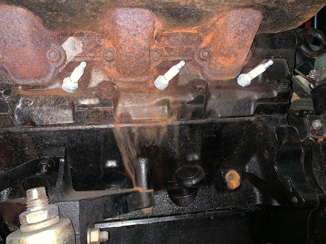

                    Okay, I want to update you guys on the project. A lot has been happening the last few months as you may have picked up on other posts both here and on CCF. I'm getting super excited about how all the pieces are coming together.
                    In the fall, once we got the boat hoisted off the trailer, I brought her home and replaced the leafs. I also decided to pun in new brake assemblies. I scraped the rims and sprayed them with Rustoleam rust paint. Looking good!
                    Then we pulled the engine, dismantled her and sent her off to the re-builder. In the meantime, I brought home all the cast pieces and repainted them. I decided to use Por15 on all the cast black parts. I used their 3 step system with Cleaner/Degreaser, Metal Prep, and lastly the Por15. I will say this....I am so impressed with the Por15. and I only ordered a pint which was more than enough for this project. The only large piece I did NOT use Por15 was the intake manifold. I just scuffed it and sprayed it with Duplicolor Engine Enamel Black Gloss.
                    The valve covers were a bit of a gong show. I wanted to make them Ford Racing red. I started with the cover with the oil filler spout. First I used cheap spray on paint stripper. Nothing happened. Then I went to local auto body shop supply store and bought their strongest aircraft stripper. It worded better but still didn't come off easily and required loads of 3M green abrasive pads. I wished I have never started stripping it. Sprayed with Zinc Chromate to etch, followed by some old Merc filler primer, then finished with Duplicolor Engine Enamel with Ceramic RED. I baked it per Duplicolor instructions for 2 hours at 300 in my BBQ grill outside. Came out amazing. Onto the second valve cover, I decided not to strip it. There were some rust spots. I used a dremmel to grind all surface rust out. I scuffed paint, primed and painted. Unlike the other one, I after letting red paint cure overnight, I felt it needed another coat so I added it. Then I baked about 3 hours later. HUGE MISTAKE. Within 10 mins, the paint blistered like crazy. The paint job was completely ruined! (Sorry was so frustrated I forgot to take pics). So in the end, I put the aircraft stripper on it and started all over. The original black paint on this valve cover was completely different from the other one though, as the stripper took all layers of paint off down to the bare metal in about 20 mins. Way easier job to strip. Then I did it all again, and let the paint cure for 24 hours before baking.
                    Next we started putting the engine back together. My buddy owns a Mercruiser shop, so we did it there. He lead this stage but it was fun to watch it come together. Note for anyone else doing this. We ordered the following parts for the block re-assembly:
                    FEL-PRO 17875 Marine Timing Cover Gasket
                    FEL-PRO MS95953 GT40 Intake Plenum Gasket
                    FEL-PRO 17260 Marine Cylinder Head Gasket - Main Gasket set, had lots of stuff
                    MOTORCRAFT EV68C PCV Valve - used Ford part number instead of PCM, way cheaper
                    FEL-PRO 17998 Single Oil Pan Gasket
                    ARP 554-9703 Black Molley SB Ford 351W CM 12pt accessory kit
                    Also got a new distributor and rotor cap, new spark wires, new 100 amp alternator, new belts, manifold riser gasket ports and screws, and used wiring harness from Peter6000 (thanks again man!). Also replaced the ECU (Thanks to t.franscioni who let me ship the Moates chip to him for programming with the latest E300 tune for the GT40!) I got a ECM from ebay for $65 and put the Moates chip in. See my other post about some things I learned about this.
                    We ran into a bit of an issue with the new alternator. The kit from Skidim called for reusing the old Mando wheel from the old alt. But mine must have been replaced in the past because the shaft size (5/8 on new alt) did not match up. We went through my buddy's stock and found the exact pulley from an old Mercruiser alt that fit perfectly and met the PCM dimensions Skidim gave us.
                    Lastly, the ARP engine kit worked great (got it from Summit Racing) however the manifold bolts were about 1/4 in too short. My buddy had some extra in his shop that fit. Otherwise, I should have gotten these from Skidim.
                    Next steps are to get the engine in, get the carpet out and start wet sanding! Enjoy the pics so far...
