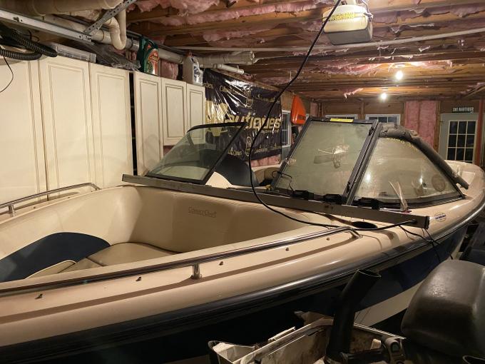

What ended up being the windshield solution? were you able to find a source for just the glass? NP only sells these old windshields as complete kits right, frame and glass? That scares me about these older boats I’m waiting for someone to find a glass only source and pick up some spare panels myself.
If you find a glass only source, please let me know! I have two complete frames without glass here now!
The solution for this boat was to steal the one I had on the Sport Nautique, because that windshield was actually for a Ski Nautique Open Bow.
On the NautiqueParts website, they show this windshield as fitting the Sport Nautique too (and that's why I bought this used one from a SNOB), but that information is wrong. The door on the windshield from a SNOB is too wide for a Sport Nautique. The Sport Nautique requires the 15.5" door and the SNOB is about 18.75".
It ended up working out OK for me though, since I needed a SNOB windshield anyway.
Now I just need to get NautiqueParts to update their website (and find a windshield for the Sport Nautique).Please do not PM me directly asking for advice on how to repair your boat. While I would love to help everyone, I simply do not have time to respond to all of the inquiries. Please post your questions on the forum, so that all of our members have a chance to answer.

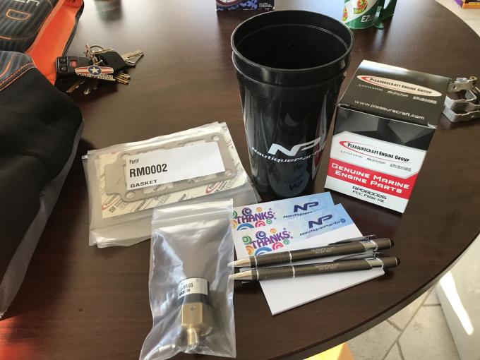

Mechanical testing is just about complete. I still need to install the oil pressure switch for the SLOW system, new riser gaskets, and the FCC filter, but other than that, it is time to move on to cosmetics! Took it out for an extended run today, and everything seems good!
Also got the new oil pressure switch, FCC filter and riser gaskets today from Nautique Parts.
I unhooked the oil pressure switch and tested the boat again and it worked. That's the good thing about the SLOW system. If you have a bad sensor, you can just unhook it until the replacement arrives, and everything will work fine.Please do not PM me directly asking for advice on how to repair your boat. While I would love to help everyone, I simply do not have time to respond to all of the inquiries. Please post your questions on the forum, so that all of our members have a chance to answer.
Replaced the oil pressure switch today, and now the SLOW system is functional again.

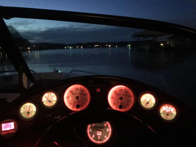

One thing that is concerning me is that the voltmeter is reading about 15 volts while running. I have misplaced my multimeter, so I can't check the true voltage at the battery. Hopefully the gauge is a little off and the alternator isn't really putting out 15 volts. I'll track that multimeter down tomorrow and figure out what's up there.Please do not PM me directly asking for advice on how to repair your boat. While I would love to help everyone, I simply do not have time to respond to all of the inquiries. Please post your questions on the forum, so that all of our members have a chance to answer.
Did some testing with the multimeter, and it looks like the voltage gauge is reading about 1 - 1.5 volts higher than actual. That's good news -- I'd rather replace the gauge than the alternator!Please do not PM me directly asking for advice on how to repair your boat. While I would love to help everyone, I simply do not have time to respond to all of the inquiries. Please post your questions on the forum, so that all of our members have a chance to answer.

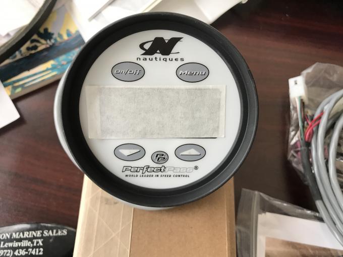

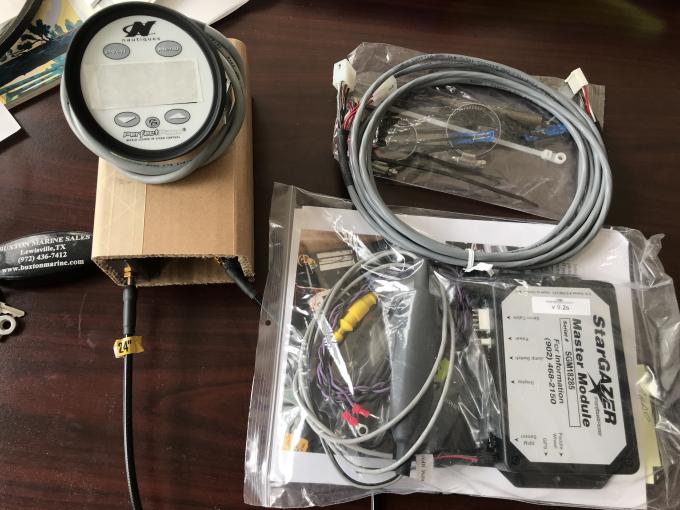

Here's the link to the write-up for the PerfectPass Stargazer installation:
https://www.planetnautique.com/vb5/f...tique-open-bowPlease do not PM me directly asking for advice on how to repair your boat. While I would love to help everyone, I simply do not have time to respond to all of the inquiries. Please post your questions on the forum, so that all of our members have a chance to answer.

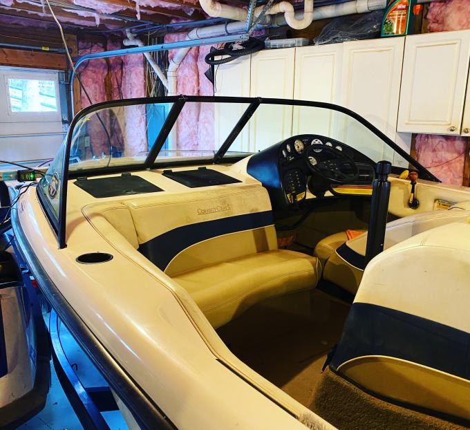

Well, the windshield on this boat ended up getting donated to another project, and I have been looking for a replacement for MONTHS!
I finally found one in White Lake's storage yard (no, I didn't steal it off of a boat). They sold it to me for a great price, and I test fit it on this boat tonight. I'm happy to say that it fits perfectly! The door that is on it right now is not correct for my boat, but I have the right (bigger) door.
Now to pull it apart and have the frame powder coated...
Windshield is on the boat now! The Windshieldless Wonder is now windshielded again!
