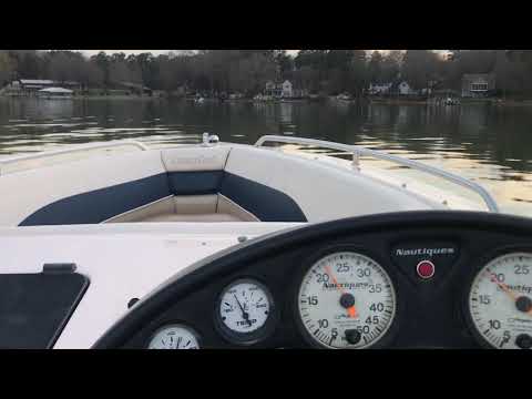

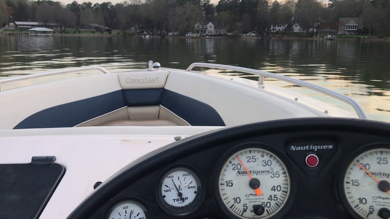

Drove it around for about 30 minutes. It seems to be running well. It does sputter at higher RPM's, but I think this is a fuel starvation issue caused by an old FCC filter. I drained the FCC, but I don't have a filter here yet, so I haven't changed it yet. I think a new filter will fix that issue. Below 2,700 RPM's, it runs great!Please do not PM me directly asking for advice on how to repair your boat. While I would love to help everyone, I simply do not have time to respond to all of the inquiries. Please post your questions on the forum, so that all of our members have a chance to answer.

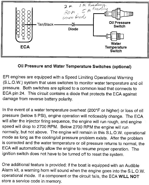

Got the high RPM sputter figured out. Turns out it was the oil pressure switch throwing it into limp mode. I'll still change the FCC filter when it arrives, and now I'll be replacing the oil pressure switch too. It is now running very nicely with the switch bypassed though!
For anyone interested, here's how the SLOW system works.
