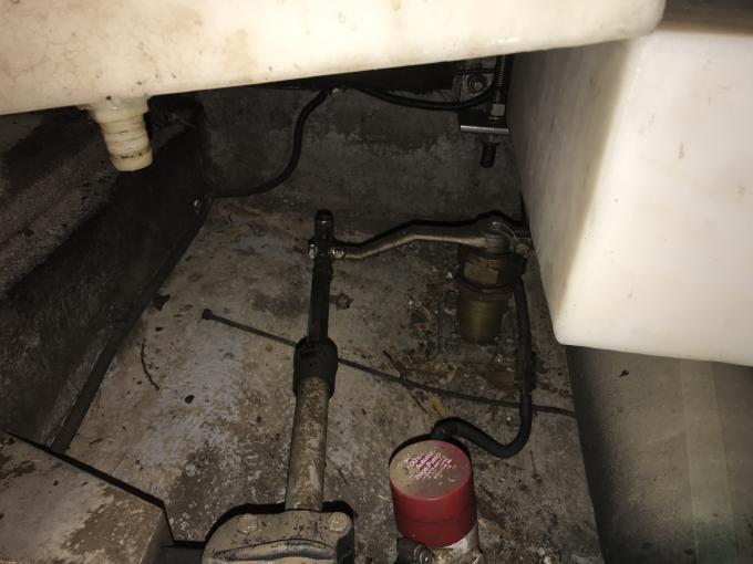

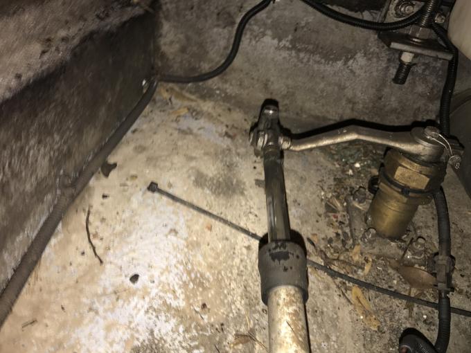

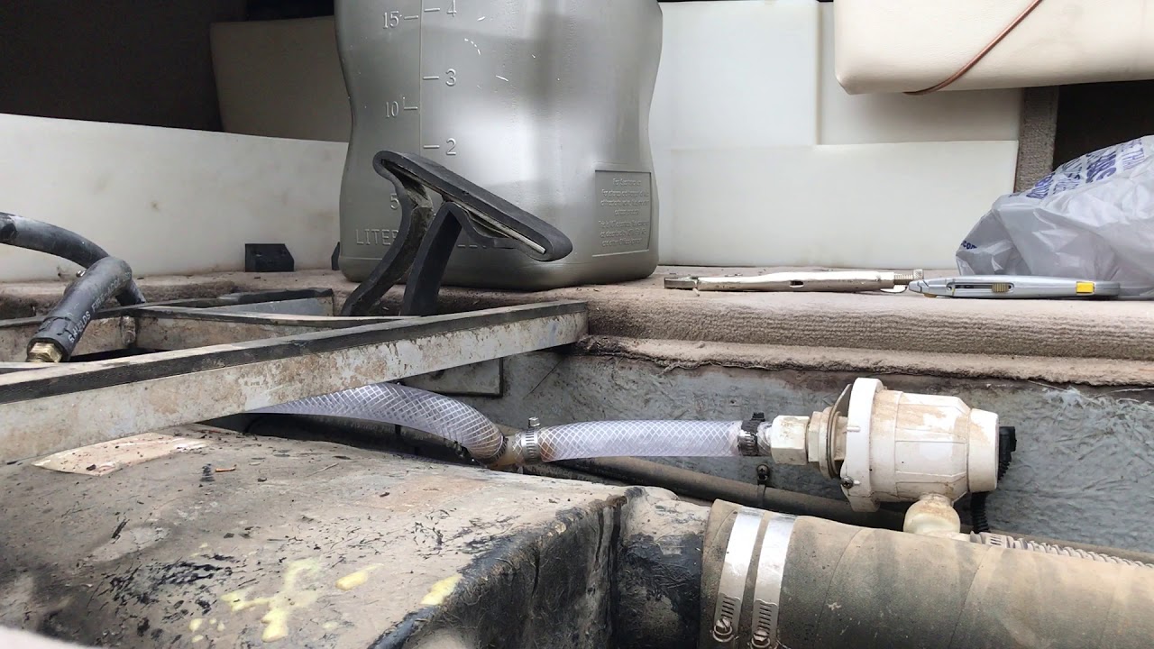

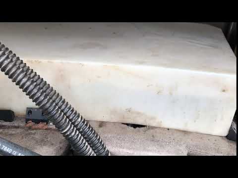

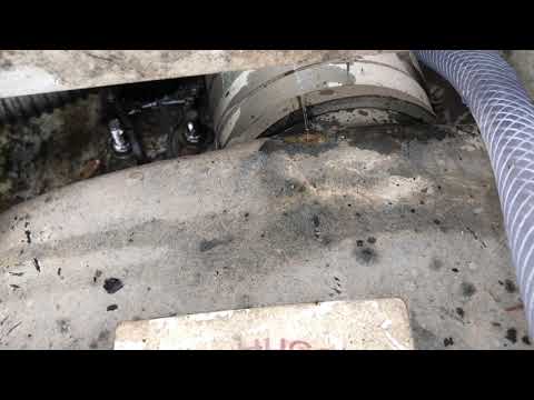

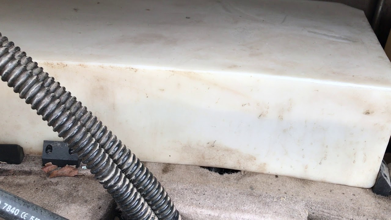

Same thing for filling. One pump, on a T, with the VENT controlling which tank is filling.
This totally explains why a cracked hose would cause so many problems. Since everything in this system relies on air pressure, a cracked hose that is allowing air to enter the system would totally stop it from functioning properly. One of the drain hoses on the starboard tank is completely shredded. I am going to replace it tomorrow and see if that fixes everything.
