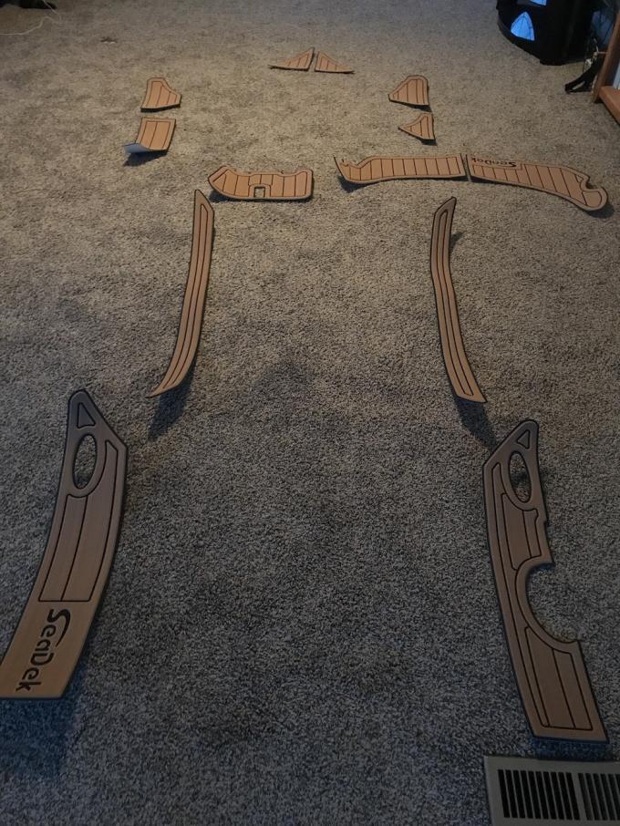

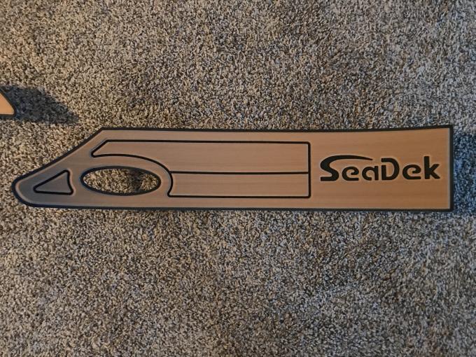

Just speaking from experience with SeaDek on this era of boats. I would not jump right in and order the pieces without having them send templates of it first. I had SeaDek done on my 2001 SAN and then took my buddies 2001 SAN to get done 6 months later and the only identical match was the glove box lid. I don’t think any boats were identical back then, especially if you have a tower and are doing a radius around the tower with SeaDek. His tower placement was at least an inch and a half off from mine.Originally posted by 2001 Python View PostWatching the seadek with interest.

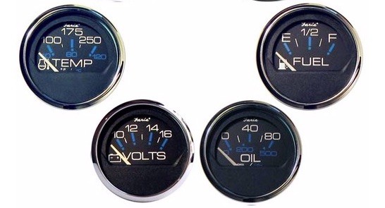

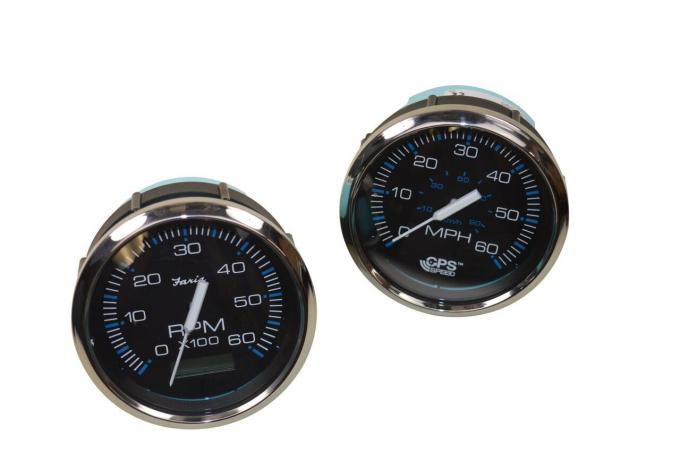

I have been looking for a reason to replace all of the small gauges in the dash anyway. This boat already had the speedometer/tachometer replaced to eliminate the failing digital versions that came with the boat originally. The gauges Nautique sent out as replacements for those digital gauges were Faria Chesapeake gauges, and they don't match the smaller gauges that are left in the dash once the original digital gauges are replaced.
Here's the dash with the original gauges.
Here are the replacement gauges that Nautique supplied for the gauge recall. As you can see, they do NOT match the remaining smaller gauges.
Since I have to replace the voltmeter anyway, I might as well replace all four smaller gauges so that they will all match the speedometer and tachometer. Here's what the matching small gauges look like. This will allow me to have a dash where all gauges match (and work!).

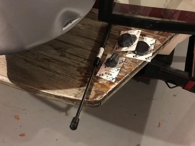

Just got home from a trip to White Lake. Pretty happy with what I was able to get.
I found a windshield door that looks like it will fit nicely. They actually had a used one, so that worked out great. Here's a shot of the new (used) one in front of the old (used) one to show the size difference.
I also picked up the remaining parts I needed to wrap things up. One gas shock, a couple of 2" dash plugs, and a 12-volt receptacle.

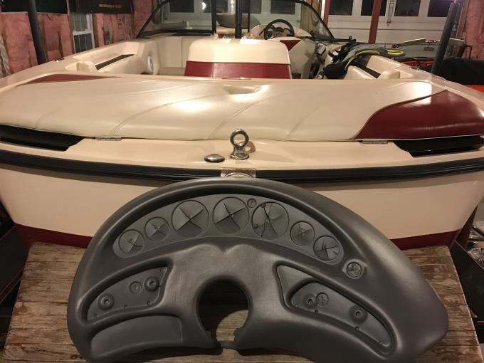

Now here's the piece I am really excited to have found. This is believed to be the very last brand new (NOS) dashboard for 2001-2002 boats. The idea of installing SeaDek on the old dash to cover the cracks didn't work out as well as I had hoped. I was very happy to dig this out of White Lake's stash! This one is for a 2002 (mine is a 2001), but the only difference is the hole for the 12-volt outlet. I'll just install one and wire it up, and we'll be good to go.

You’re gonna have a lot of people butt hurt about that dash board. Seems like at least once a month someone is on Facebook asking where to get a new one. Nobody could ever seem to find one. **** I don’t even need it and I’d buy it if I came across it.

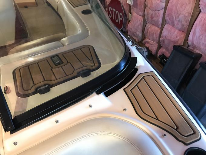

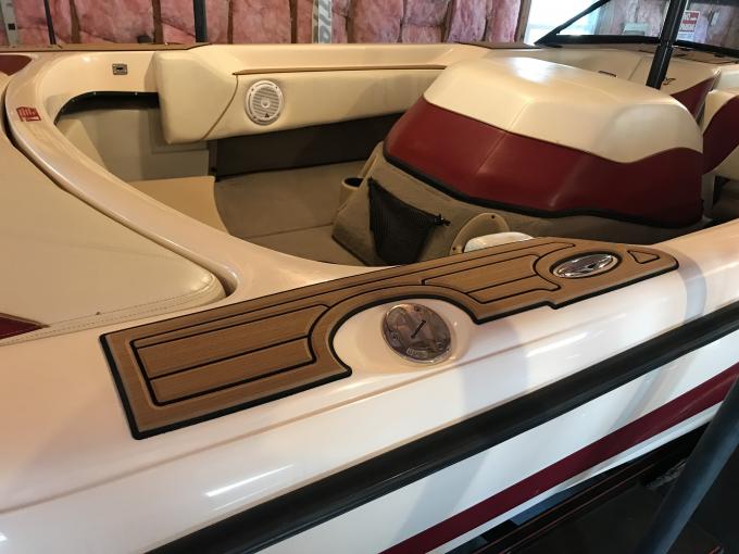

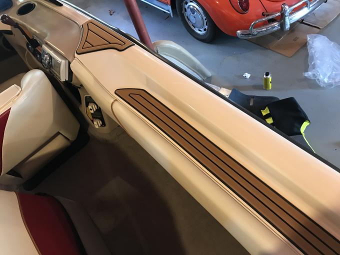

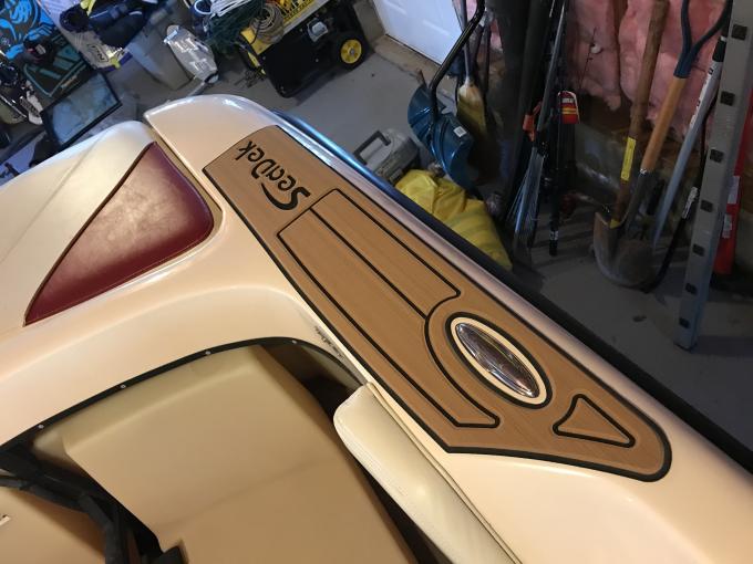

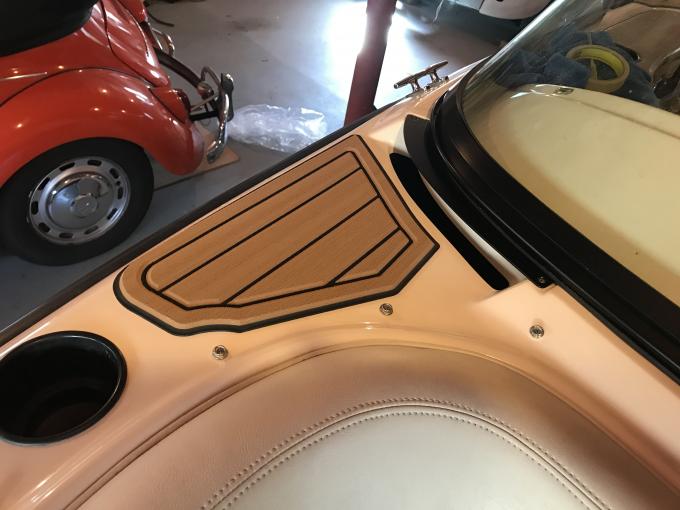

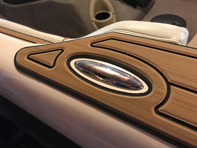

I just went out to work on the windshield, but I couldn't resist installing the SeaDek.
Maybe I'll work on the windshield later tonight.
Here are some shots of the SeaDek installed. I am very happy with how this turned out! It covered the tower holes nicely, and made the boat more functional on top of that.
