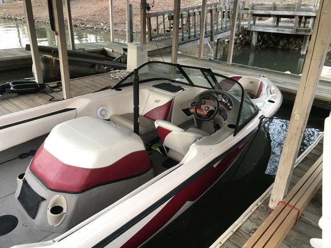

Nothing official yet. We just finalized the design, and it still needs to be cut. I'm not sure how long that will take.

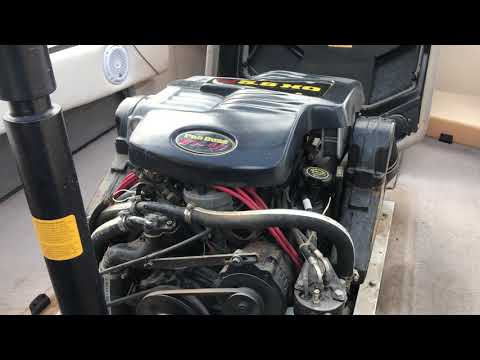

Got the engine running today, changed the FCC filter, changed plugs, changed oil and filter, dropped in a battery and went for a test ride! First time I have had this boat on the water, and I am happy to say that it runs great!!!
Still need to do some electrical work on the dash. Speedometer, tachometer, temperature and depth gauges work. Oil pressure, volts, and fuel do not.
Coming together Jeff . Just noticed you did not have the Sport Nautique side stern raised lettering will you be adding those ?
I don't think you can find the original black domed Sport Nautique lettering anymore. I think I've looked everywhere.
