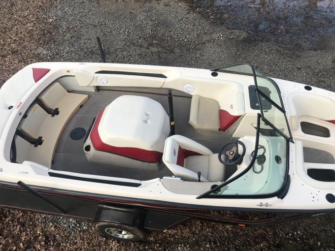

Progress is being made... Two steps forward, one step back.
The gelcoat has been fixed and buffed.

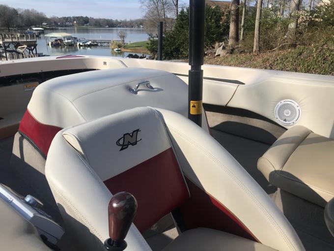

The upholstery and carpet cleaned up WAY better than I expected, so I may not order a new interior for this boat.
Newly powder coated vent covers are installed.

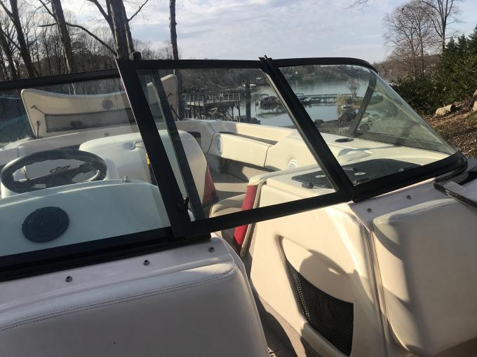

Windshield is installed...kind of.
The windshield I bought was from a SNOB, but it is supposed to be the same windshield as the Sport Nautique from that era. It looks like the walk-through door is the wrong size on the windshield I bought. It is supposed to be 15.5" wide by 23" tall. The one I currently have is 18.75" wide by 23" tall. I am trying to source just a door. Hopefully I can come up with something.
Jeff, I bet you could pull the frame apart, cut it to the right size(aluminum you can just cut with miter saw), and have the glass cut or get a new piece. Honestly I bet that is much easier than you think.
Yeah, I actually have the original windshield frame, and the door isn't too messed up. If nothing else, maybe I'll just straighten that out all the way and powder coat that and get some glass cut.
Maybe cutting the existing one would be better though, since it is all powder coated and everything.
I am checking with NautiqueParts and Nautique about just getting a new door though. We'll see.
