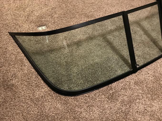

Going to be redoing my windshield very soon. Is that a matte black or a semi-gloss? Little hard to tell from the pictures. Was debating doing a matte silver to keep the burn factor down, but not sure yet. Looking great!
2001 Pro Air Nautique

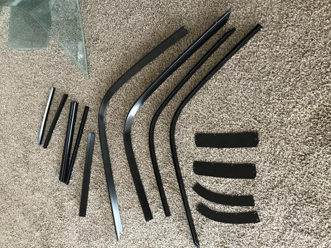

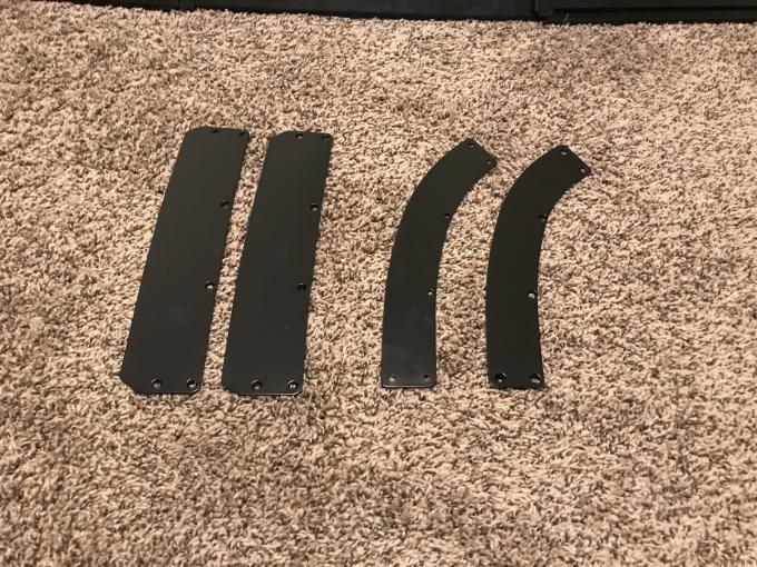

Ended up being about $280 with the blasting and the powder coat. I am very happy with that price.Please do not PM me directly asking for advice on how to repair your boat. While I would love to help everyone, I simply do not have time to respond to all of the inquiries. Please post your questions on the forum, so that all of our members have a chance to answer.
I was able to reuse all of the rubber that goes in between the glass and the frame, as well as the pieces that go between the frame and the deck. I just wash it in warm soapy water and it is good to go. The only replacements I had to order were the pieces that cover the screws that hold the frame to the deck. For some reason they were glued in on this particular windshield and the originals got destroyed during removal.Please do not PM me directly asking for advice on how to repair your boat. While I would love to help everyone, I simply do not have time to respond to all of the inquiries. Please post your questions on the forum, so that all of our members have a chance to answer.

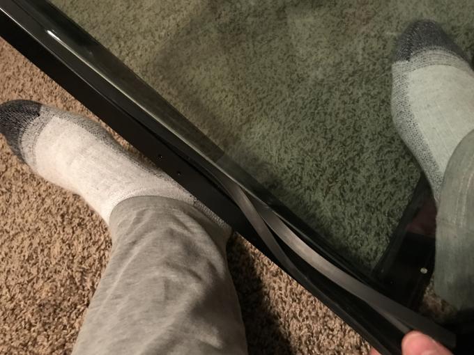

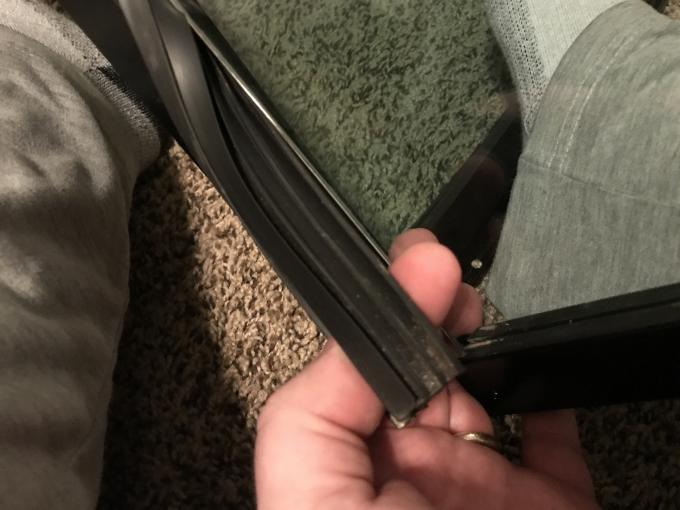

Jeff, what does the rubber look like between the glass and the frame? I don’t see it on NP.com so I’m wondering where I might get that if mine is in too poor of condition to reuse when I powder coat my windshield frame. Wasn’t sure if it was something generic that could be sourced locally or if you know of somewhere it’s available?
Amazing it was not all brittle and cracking throughout the moldingOriginally posted by NautiqueJeff View PostI was able to reuse all of the rubber that goes in between the glass and the frame, as well as the pieces that go between the frame and the deck. I just wash it in warm soapy water and it is good to go. The only replacements I had to order were the pieces that cover the screws that hold the frame to the deck. For some reason they were glued in on this particular windshield and the originals got destroyed during removal.
Here are a couple of shots I just took. I pulled the glass back out of the rubber so you can see what it looks like. The part where my thumb is is where the glass goes. The rubber surrounds the glass and fits into the frame.Originally posted by brit_hunsicker View PostJeff, what does the rubber look like between the glass and the frame? I don’t see it on NP.com so I’m wondering where I might get that if mine is in too poor of condition to reuse when I powder coat my windshield frame. Wasn’'t sure if it was something generic that could be sourced locally or if you know of somewhere it’s available?
I don't see it at Nautique Parts, but call them and I bet they have it or can get it.
