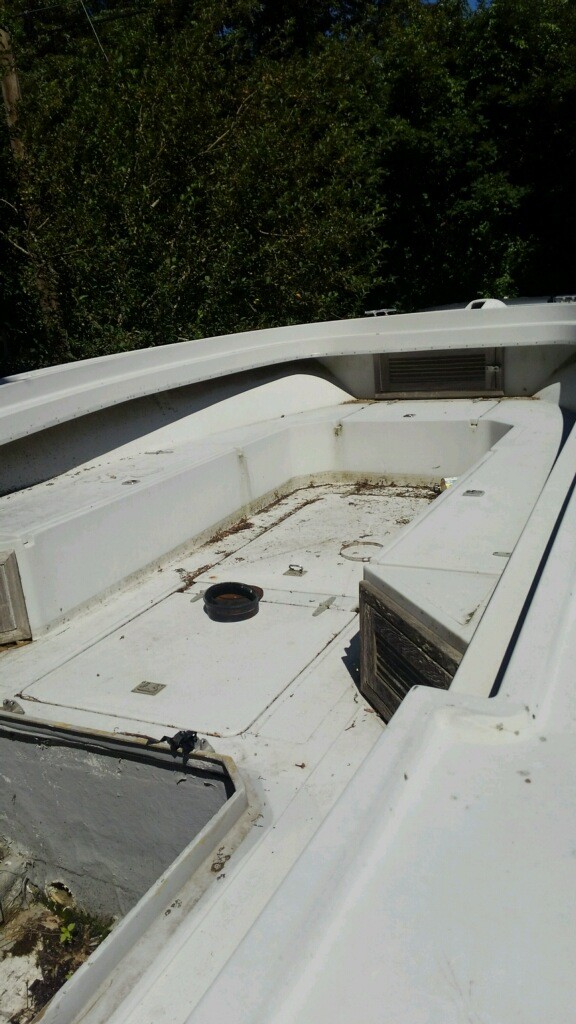

- Rework the entire top deck, which is pretty messed up. Lots of holes and raw fiberglass patches.
- Rework the entire center console

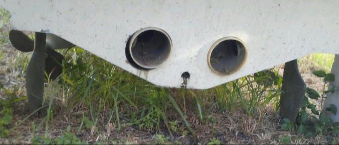

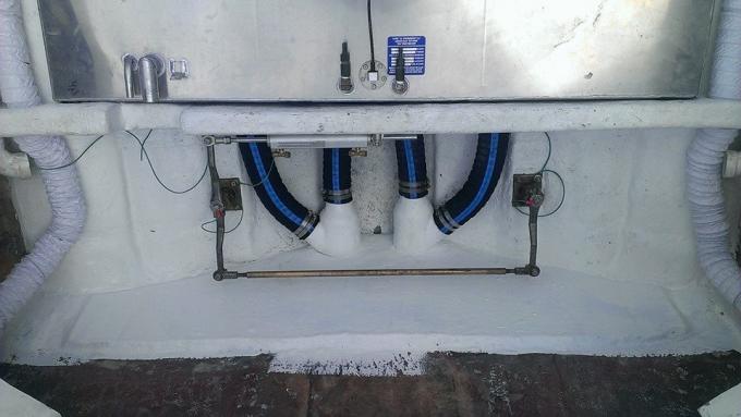

- Repair bad exhaust hole in hull (fiberglass and gelcoat) and install SS exhaust tips
Here's a shot of the bad exhaust hole.

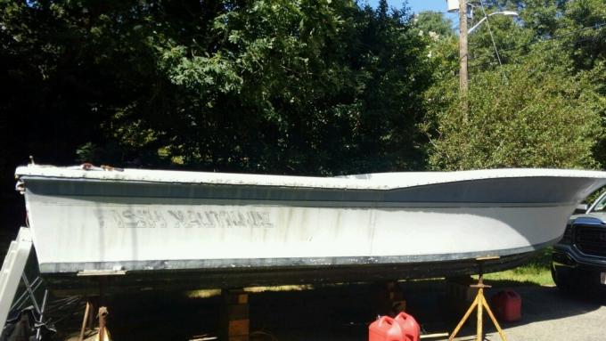

Here's the bare hull FN I just bought.
