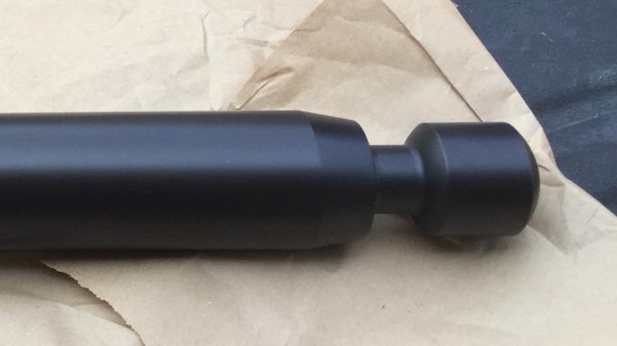

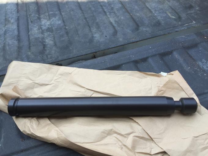

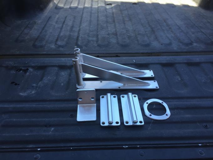

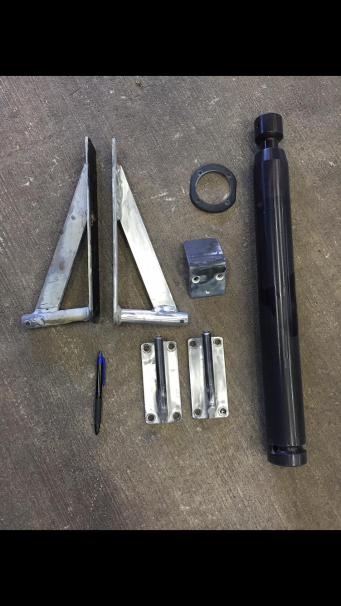

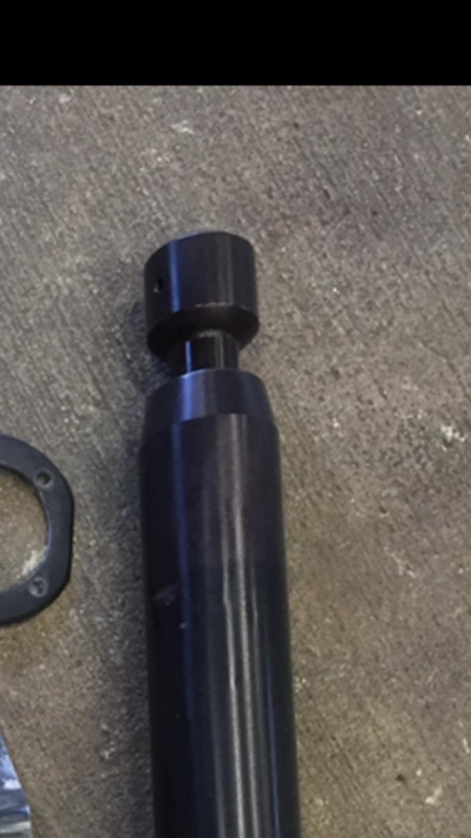

Haven't got the hoists made up yet to lift the top deck off yet. Been working on my tower, swim deck brackets and ski pylon. Stripped all the swim deck brackets and polished the up a little bit. Took the ski pylon to a plating shop to have it re-anodized. It was anodized with what they call a type 2 process according to the plating shop which is the standard most common form of anodizing. Problem with type 2 is it does not hold up to UV light and you can see how the tip of it that stuck up from the deck faded to a dark purple. To prevent this they suggested type 3 anodizing which is a thicker harder form of anodizing and supposedly is the "industrial form" of anodizing and has better wear protection and will not fade.... Long story short it looks really cool and I'm happy with the results. I'm considering doing the swim deck brackets but now kinda think they will look better in there raw aluminum form and clear anodizing is an option it doesn't actually come out clear but more grey so for now I'm leaving them in there raw state. The ski pylon trim ring was originally powder coated black so I stripped it and it's at the powder coat shop getting painted black again.

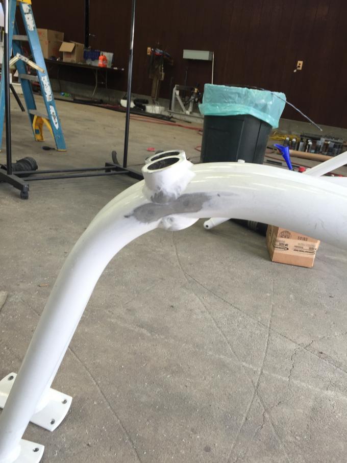

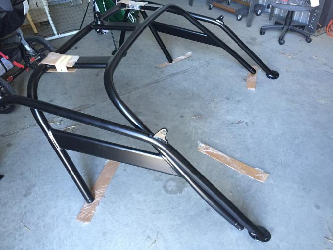

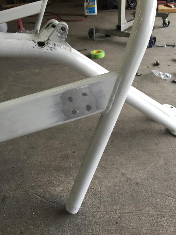

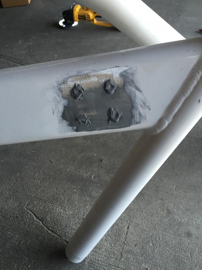

Got the tower back from powder coating today. It had holes drilled in it for board racks and for Bimini top mounts. I sanded the original white powder coat off those areas and used a product call Alvin Hi-Temp lab metal. It's kind of like a bondo that can be electrically charged and powder coated over. I'm going to be using the FTC2 flight clip clamps which were introduced in the 2004 super airs I think and enabled the mounting of the flight clips at any spacing and without drilling holes in the tower. For the Bimini top I'm using an under Bimini from tower biminis which like the flight clips uses clamps so no drilling is required. Nice and clean now (I did leave the tower speaker wire holes just in case). Went with a 20% gloss black so it has a kind of matte or satin finish now.

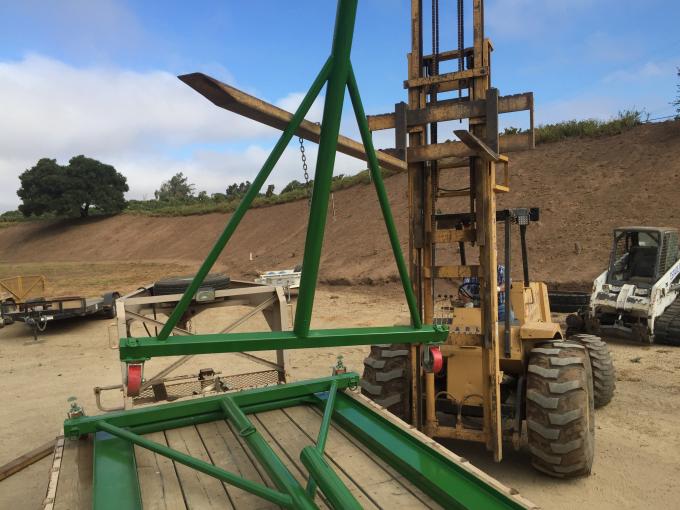

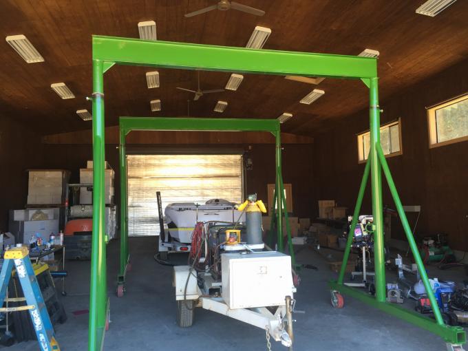

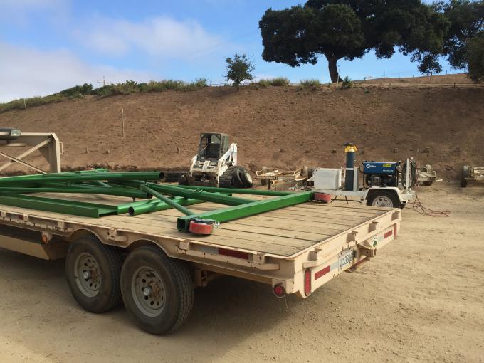

We were technically building the hoists for a shop on the family farm here where I work for lifting engines out of tractors and things like that. The timing happened to be right with where I'm at with my floor project and needing to lift the deck off. Originally I was going to try and forklift the topdeck off but when I knew we were going to build hoists for the ranch I decided to wait and use them because it would be a lot safer and more stabil.
