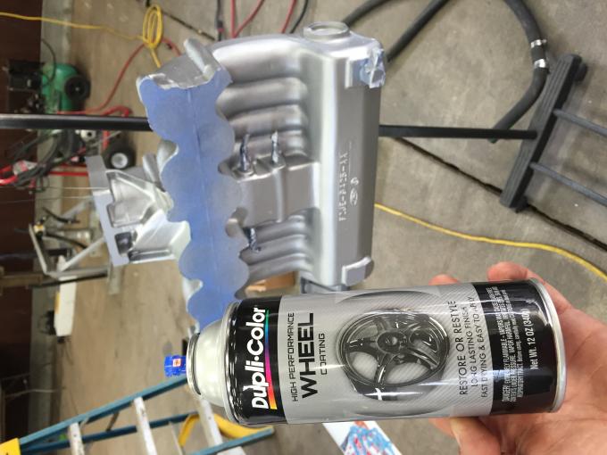

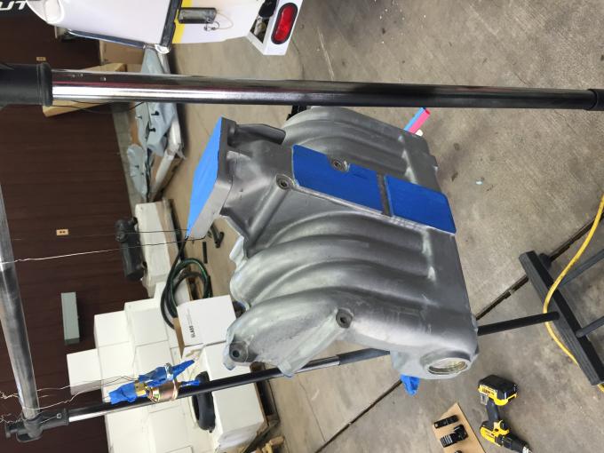

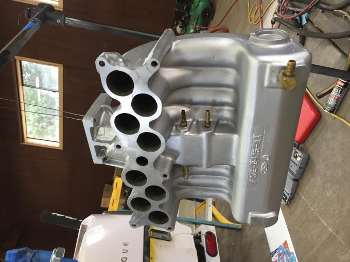

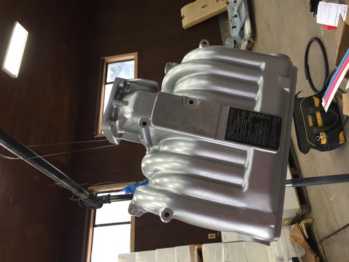

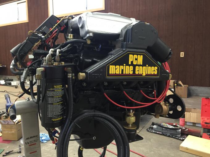

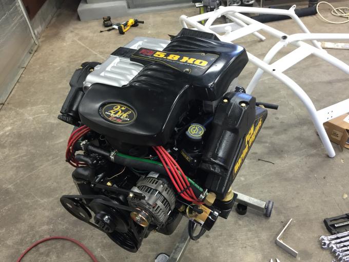

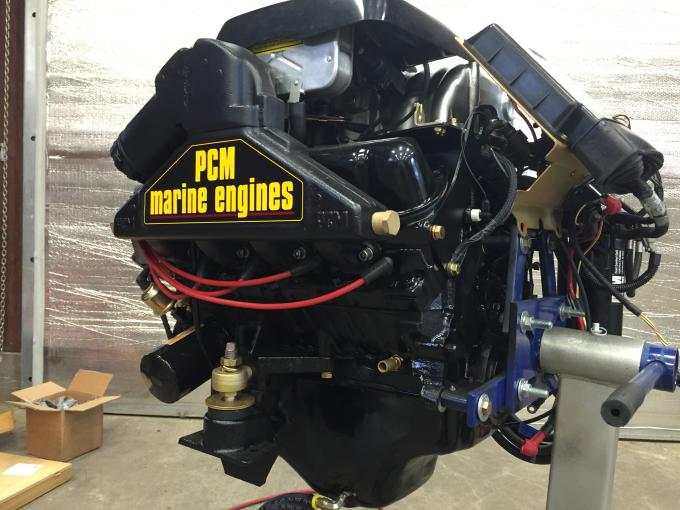

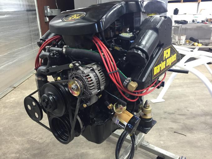

One last engine part to paint... Used a wheel paint just because it looked like a good color match and was heat resistant to 250F. Also did not require bare metal so was able to just scuff up the old paint that was on it with a scotch bright pad and spray over it. Color came out okay kind of a silver metallic similar to original.

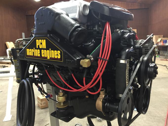

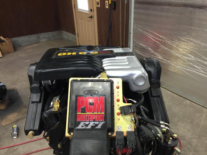

Ok engine is completed finally.... Just need to
Install all rest of the raw water hoses and tranny cooler which will go on after it goes back in boat.

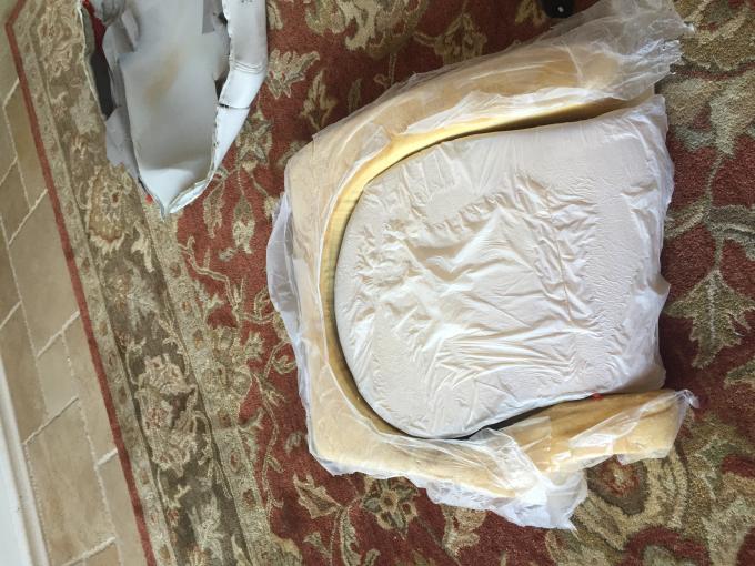

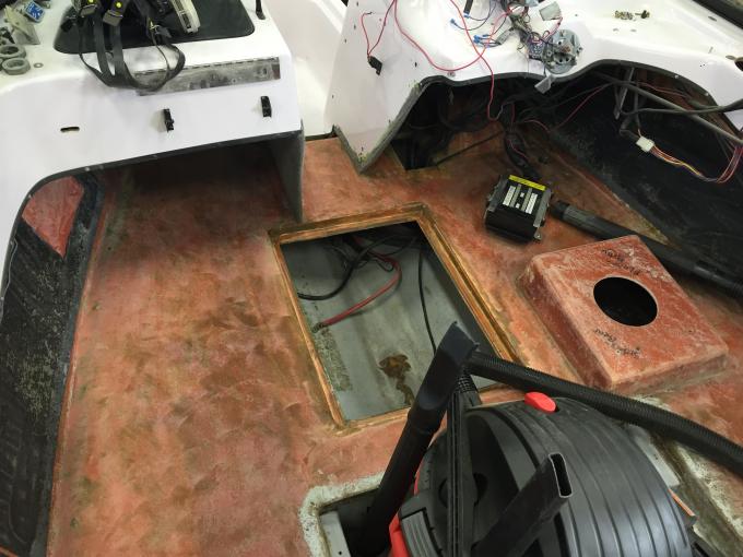

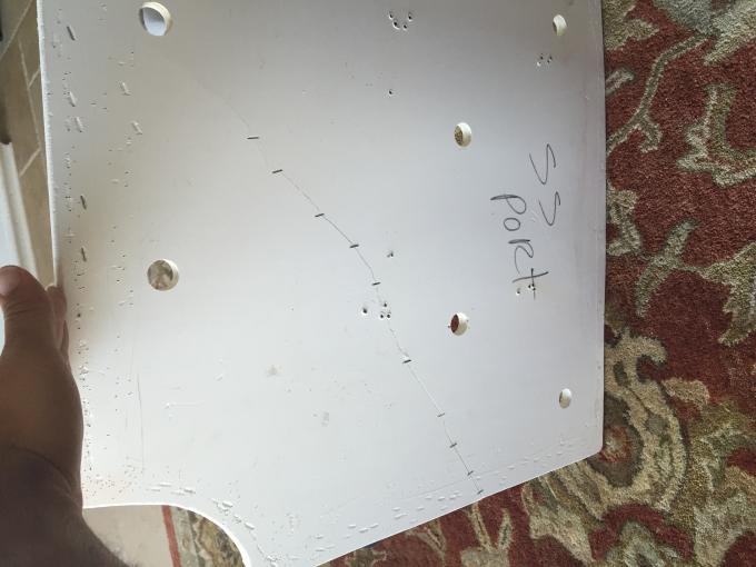

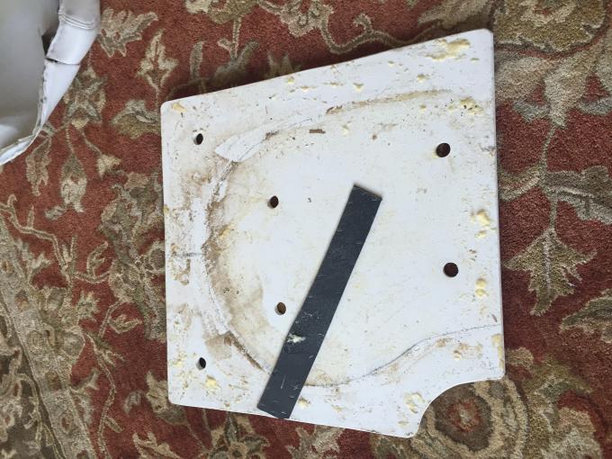

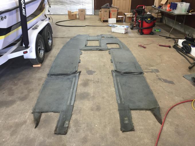

Iv got my roll of bulk carpet in from Christine's and am ready to trace the old carpet I removed but I'm pretty pumped on all this seadeck talk and projects I'm following on here so I'm going back and forth now between keeping it carpet or joining in on the sea deck craze. So i do what I always do when I need to kill time, pull staples and recover seats.... I came across a couple broken seat bases the the previous owner had tried to patch up when he did some recovering so I figure I could include my repair procedure in this thread. Below is the previous owners repair to the stock rear bench seat base. The staples held up as I didn't know it was broken until I pulled off the upholstery cover. The seat foam is glued to the seat base so you have to be careful you don't tear the foam when pulling it off the seat base.
