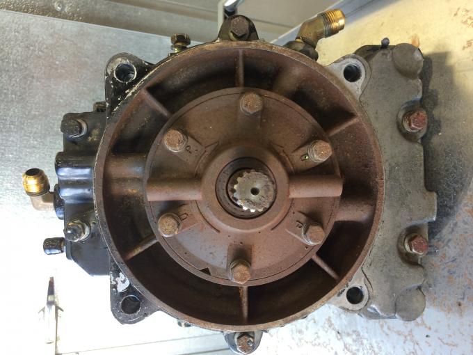

        When test drive my boat it ran fine but I remembered it sounded super loud when I test drove it. I had never drove a nautique before so at the time I thought that was normal. What it was I think was the fact that there was no oil in the Vdrive to dampen the noise of the gears meshing. When I saw it had no oil that's when I pulled it out and took it half way apart. The water chamber was all slugged up and corroded and the bottom oil cover was cracked and the exterior was all rusted so I called waltergear and they said they can make it like new and rebuild it for me and that's what started me on this "make everything new" journey.
        Yes sae 30 is what I'm putting back in mine when I'm ready to install it back into boat.

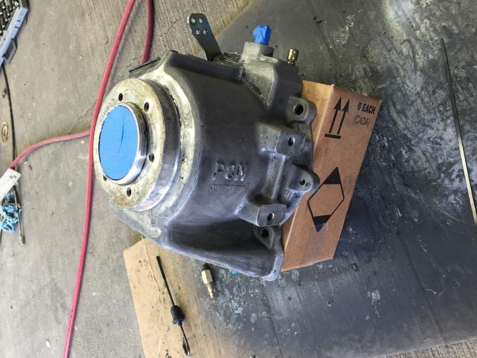

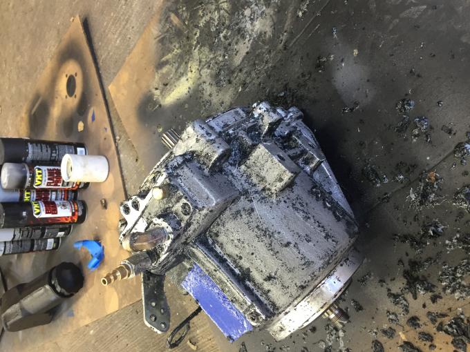

              Because the water pump and transmission have bearings I'm having to strip them with spray can paint remover, a wire brush and lots of brake cleaner.... very messy and time consuming when compared to sand blasting but it's a lot safer for the bearings and moving parts.

                Britt let me get back to my boat tomorrow and take a bunch of pictures of my Vdrive and the adapter housing and coupling that connects it to the transmission. I remember it being kind of a pain to remove only because there is not much room to get an open ended wrench in to take the coupling bolts apart. It was so long ago I need to look at the parts again to recall exactly what I did and it will be good if you have the pics in front of you while I'm explaining what I did. I will call you tomorrow when I get off work around 5 pm PST. In mean time send me your email address and I'll email you a copy of the Walter service manual you may find the answers to your questions in there it has exploded view diagrams of the all the parts.

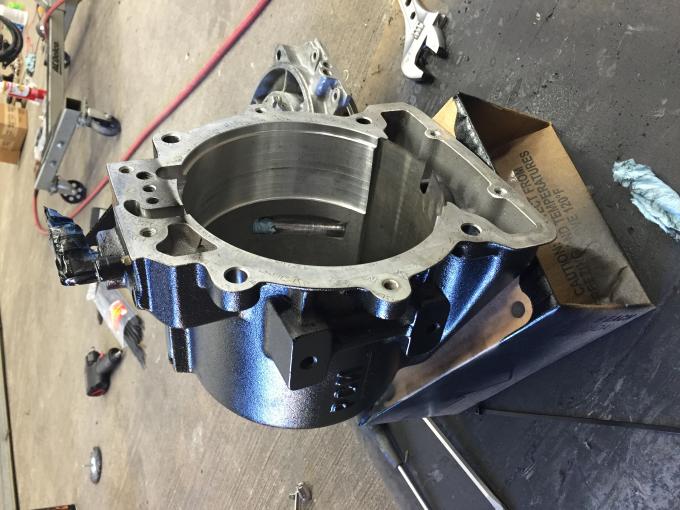

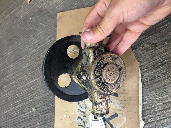

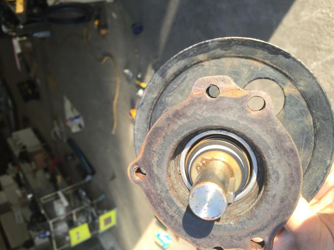

                  This is a pic with the brass pump housing removed. The rebuild kit for these Sherwood pumps consists of a press fit aluminum cup that contains a spring and a carbon faced bearing. Used a screw driver to pry out the old rusted cup and spring and removed the old cracked carbon bearing and installed new.

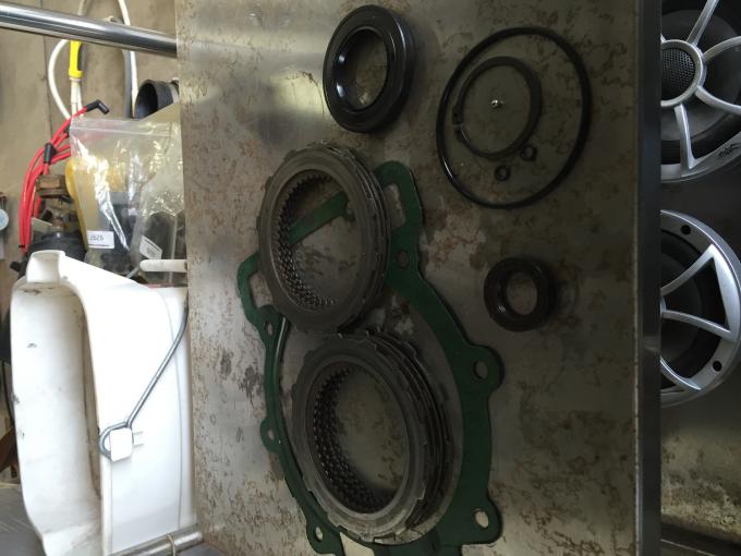

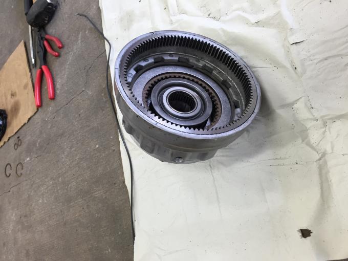

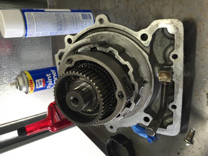

                    Transmission had slightly warped clutch plates as the prop would spin when in neutral so I rebuilt. Bought a gasket, input/output oil seal and Oring kit along with forward and reverse clutch plates and stripped the transmission for repainting. You can also replace the needle bearings and main bearing but those were in good shape so I reused them.

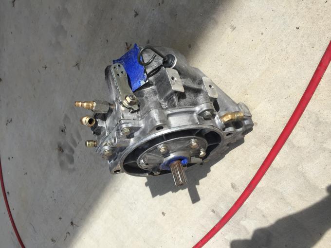

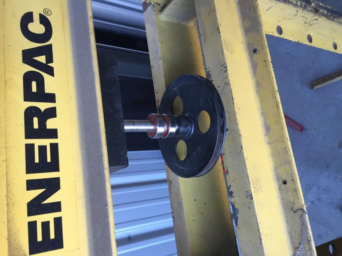

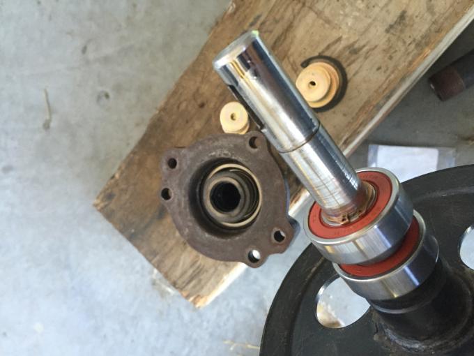

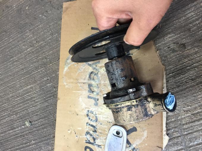

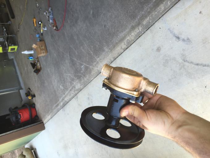

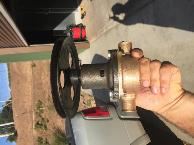

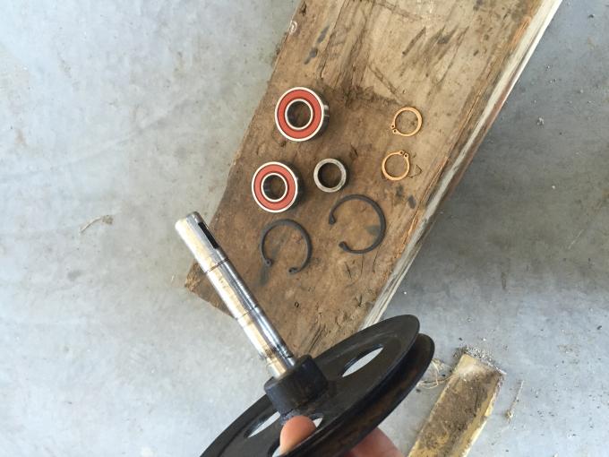

                            Replaced the 2 bearings in the water pump also found these pics so I'll post them... And thanks for the encouragement glad there are nautique freaks out there like me that like to see people do there resto work! sometimes I get burnt out on this project and just have to take a break for a week or two... Almost done with all the drive train though so moving onto the interior and gel coat will be a nice change to get me excited again.

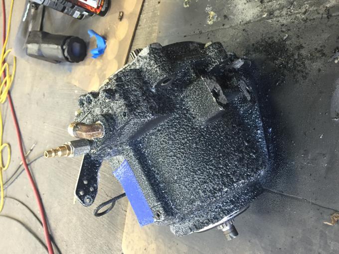

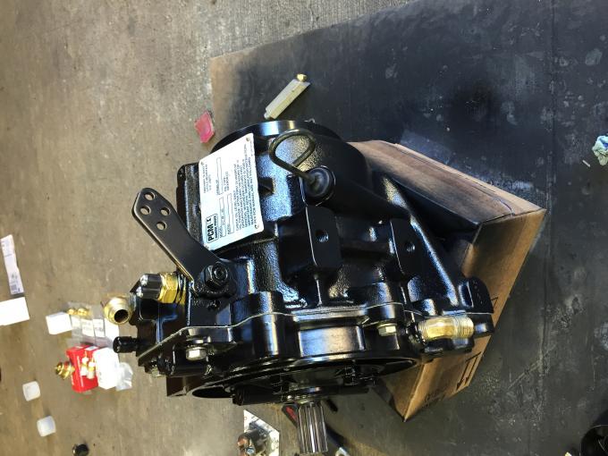

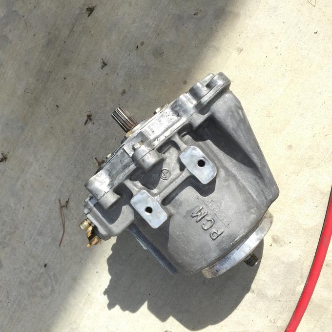

                              Tranny and water pump are all overhauled and painted. Ready to go back in the boat.

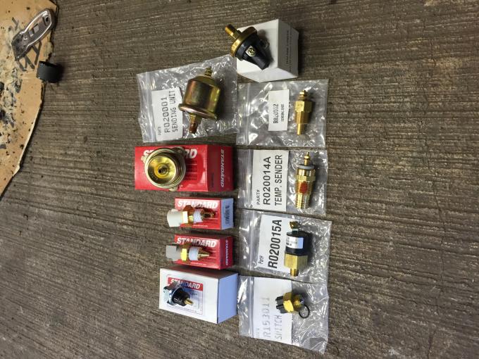

                                #45
