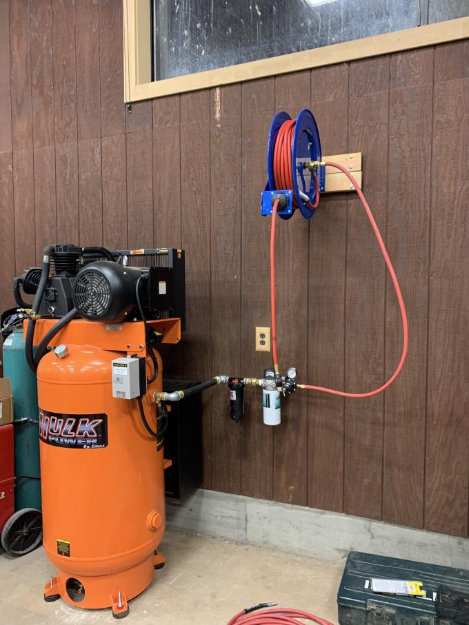

                      I’ve been working on it a little bit at a time yes. But just more fairing and sanding which I’ve already posted about. I did get equipped to spray the gel coat. Purchased a 80 gallon 2 Stage 7.5 Hp compressor this bad boy will push 25 CFM at 100 psi continuously!!

                      Should make spraying an entire hull seamless. Took some tips from the long horn build I’ve been watching. Gunna need a lot more gel coat than I originally thought and gunna try to color match the gel coat myself using a small sample of the expensive pre matched stuff and having my local paint shop scan it with the gun and give me the breakdown and percentages of colors. Then I’ll have a good starting point and know what pigments to buy to try and mix it myself. It so much cheaper it’s worth a try at least. I need 5 gallons of gel and the color matched stuff is $300 a gallon or more.

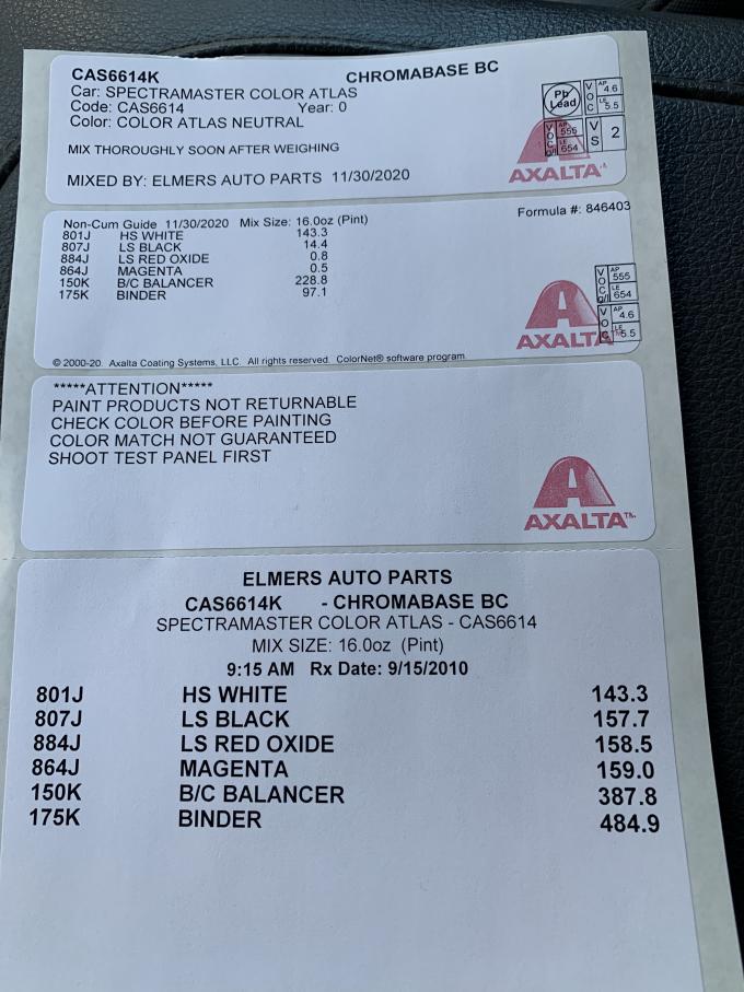

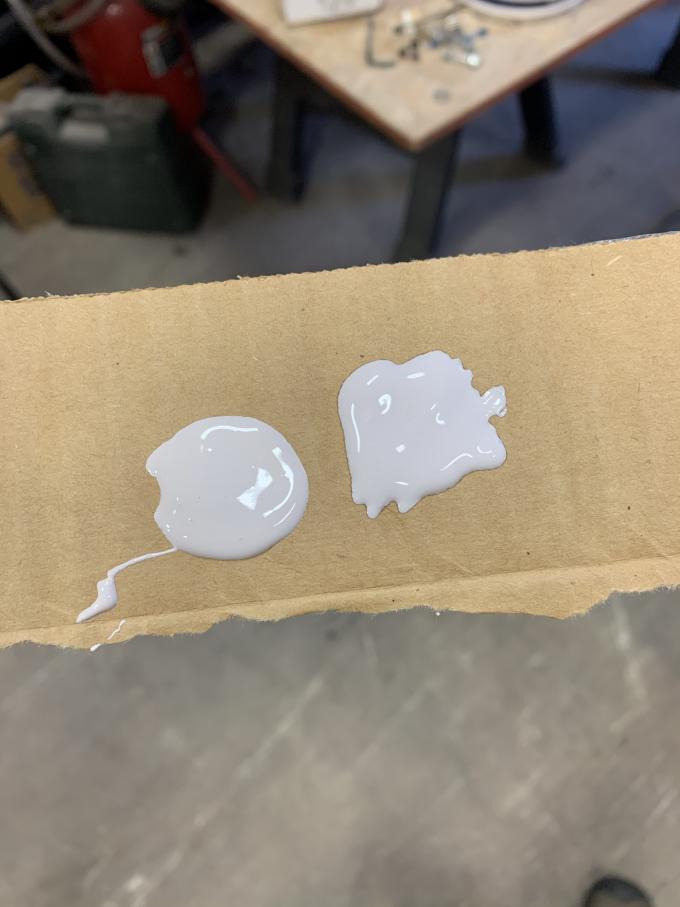

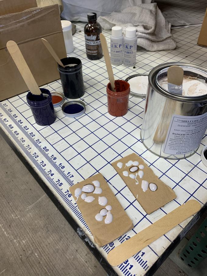

                        I took one of the seat bases from my boat and took it to my local paint store and had them scan it. This is the breakdown of colors in the 93-02 nautique silver cloud gel coat color. I found a an old pint of white gel coat and pigment kit I had purchased years ago from US Composites, apparently this isn’t the first time I’ve thought to color match the gel coat myself... I think after buying this kit I found out spectrum made the nautique 93-02 silver cloud gel coat pre mixed. I bought a few gallons, never got to the point to spray it and it all expired. So today with the scan breakdown I gave it a quick try mixing it myself and got very close. Close enough to believe I can mix this stuff myself. So now next step is to order plain white gel coat and the pigments, black, oxide red, blue and red (to make the magenta). I did this small batch and compared it to the expired expensive stuff I had on hand and could hardly tell the difference. This will add to the fun and save me a lot of money not forking out $300+ a gallon for the pre mixed stuff. Once I get a fresh batch of supplies I’ll fine tune it and record the formula so I can easily make all 5 gallons needed. The two samples on the cardboard is the expensive stuff compared to what I was able to mix up today.

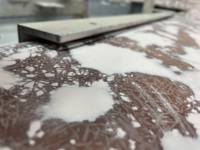

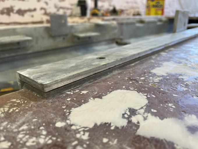

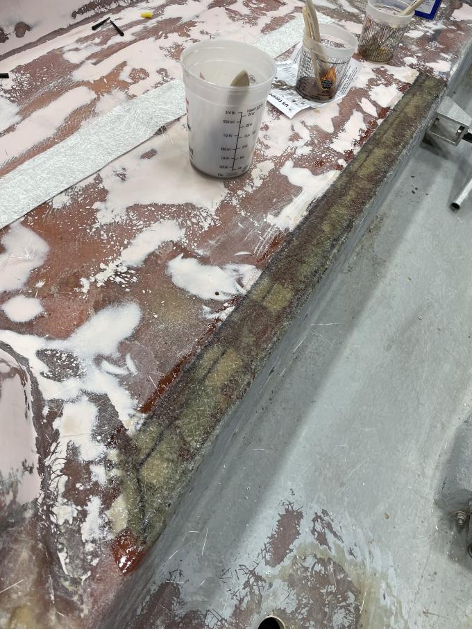

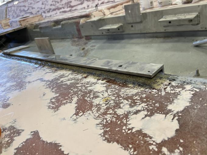

                          Was about to shoot primer and then gel coat on the inside of the hull and remembered to fit up the engine frame and make sure everything fits up good before I start spraying everything. Without the carpet there’s quite a gap to fill and needs to be built up with fiberglass so the engine frame is mounted properly. Not looking forward to anymore fiberglass work I’ve had my fair share of that to this point but it needs to be done...

                              6 layers of CSM mat filled the gap from the carpet. I think now I can move onto primer and gel coat spraying…. I think….
