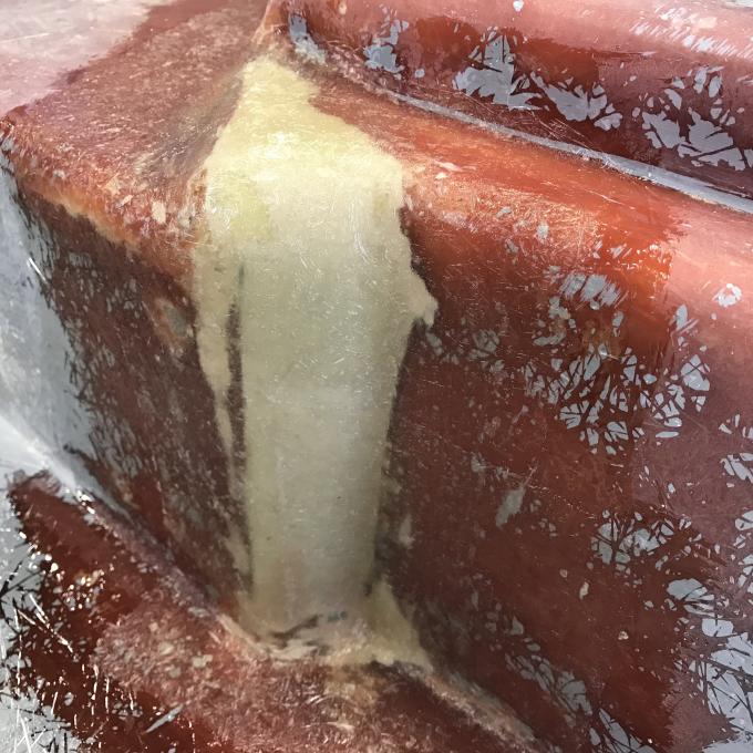

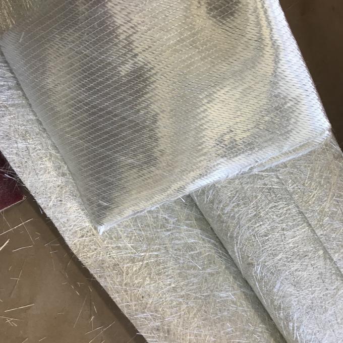

        i got the foam poured for the caps on the engine bay stringers. Shaped it, filleted the corners with some P14 polyester based material then began building the fiberglass up. I went overkill because I don’t want any chance of cracks developing here again. The factory just used a couple layers of CSM and left some air pockets which led to the cracks in my opinion. So I started with a layer of CSM backed biaxial cloth then went over that with another thick layer of CSM. Made sure there were no air pockets this time. I went with laminating resin so I could let each layer cure and add the next next layer a day or two later without having to go back and sand before the next application. Once the final layer is cured I will seal it with some PVA to allow the tacked surface to fully cure and then that should complete this repair.

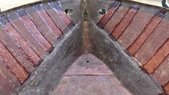

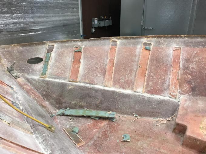

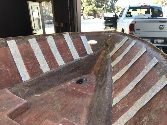

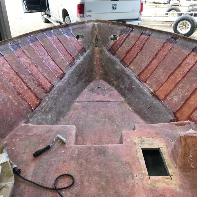

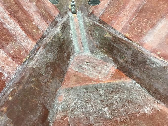

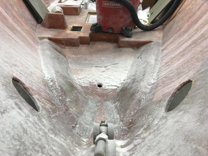

              In the bow area I removed the vertical stringers. Again there was lots of air pockets and it appeared the foam cores had shrunk over time and pulled away from the fiberglass so really these bow stringers were not doing much of anything structural wise in my opinion (at least they weren’t in the current condition they were in). I think these stringers really provided something for the bow flotation foam to hold onto which was carpeted over. Anyway, with the foam and carpet gone for my project these stringers had to go so I can get a nice flat surface to gel coat over. I did glass in some CSM to bring the surface up flush with the surrounding bow area.

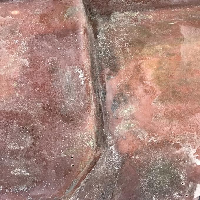

                Ran into some tedious cleanup of the bow and a few other areas on the boat where I had to level uneven areas mostly in the bow in order to get semi close to a flat surface so that the gelcoat will layout flat and smooth and the sea deck will have a flat surface to adhere to. Instead of building up with bondo I went ahead and fiberglassed wth CSM to build up all the uneven areas and then sanded to get it all to blend in.

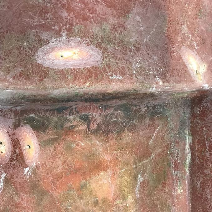

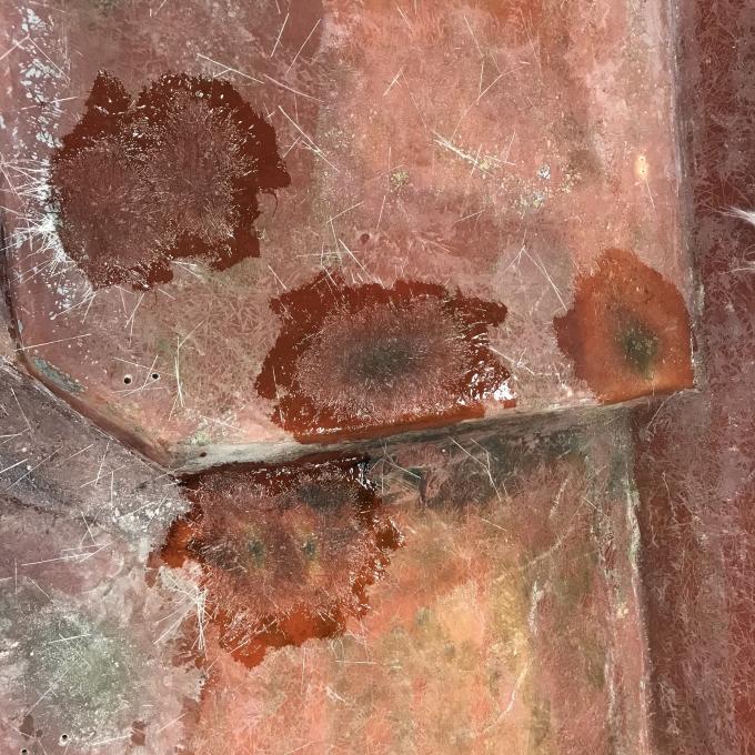

                        Patched all the miscellaneous screw holes (couple dozen or so) that were in the floor all throughout the boat from past disassembly and reassembly and factory installation of certain trim components. I did leave the screw holes for things such as hinge brackets for belly hatch, screw holes for top deck support brackets and engine frame bolt holes because I think those will be crucial to accurately lining everything back up when it goes back together. Next step is to make new belly hatch and gas tank floor panels which will be wider to take up the gaps left by the carpet removal.
