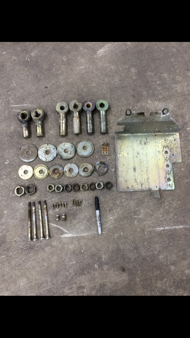

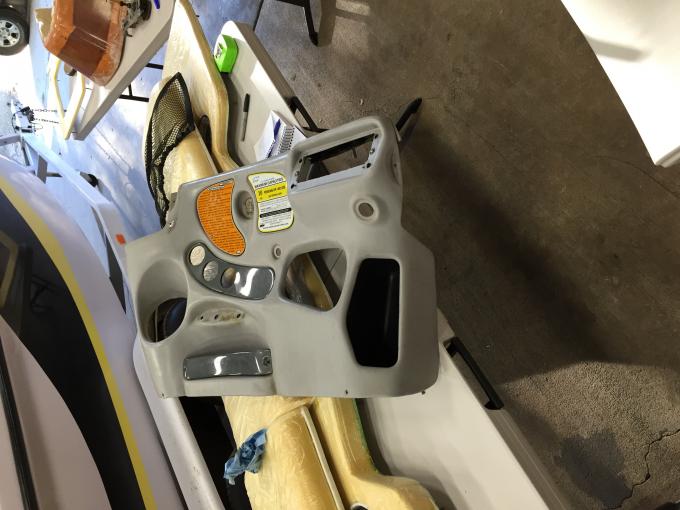

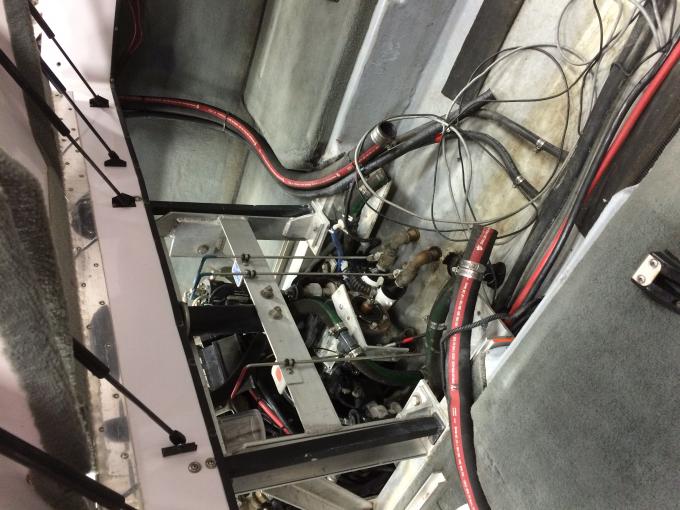

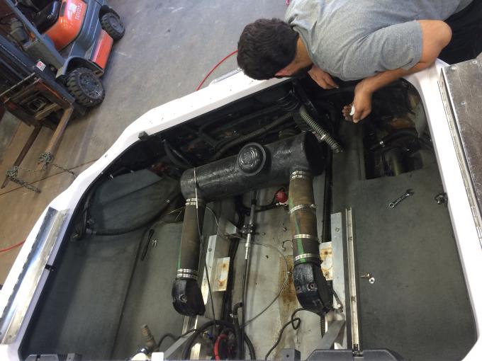

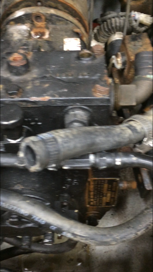

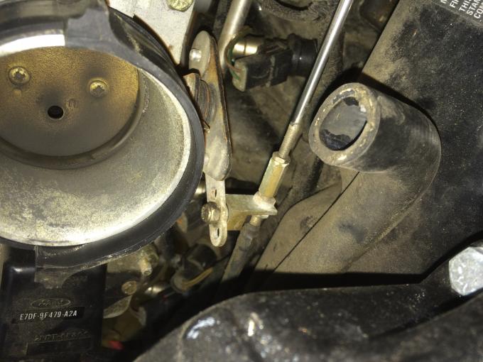

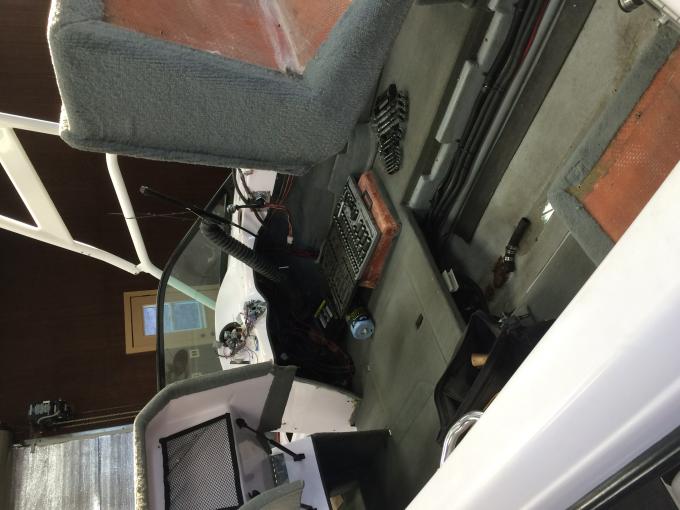

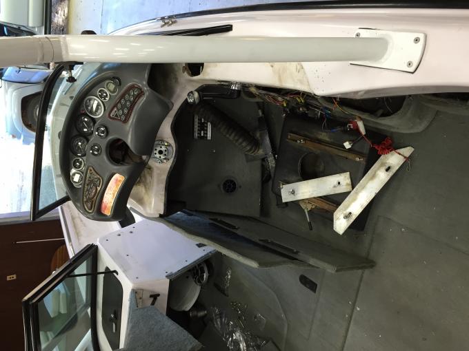

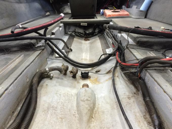

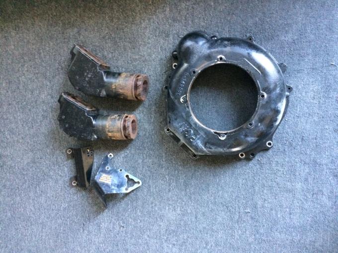

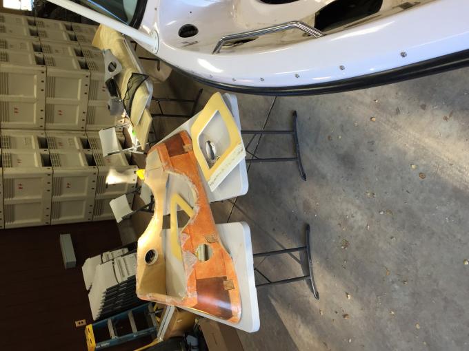

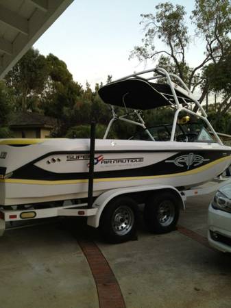

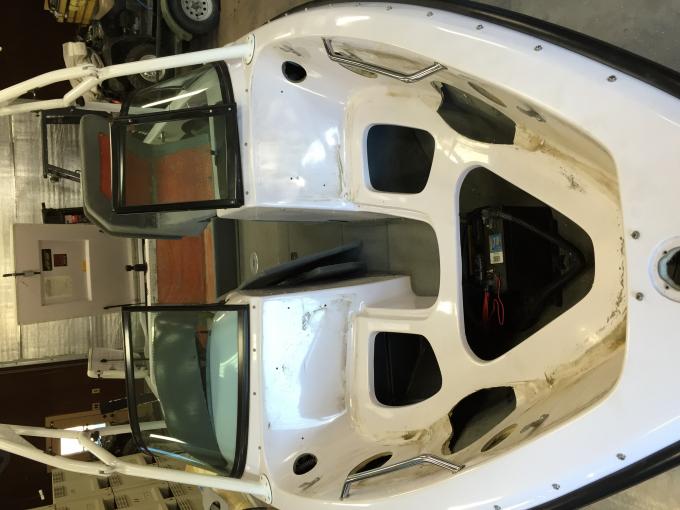

There we go... Okay wish I had more before shots but these are all I got to show the condition of everything before... not too bad really, some rust, some dust, expected from a 12 or so year old boat I suppose.

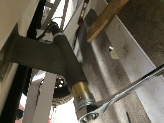

One of the first things I did after disassembling everything was press in new cutlass bearings. Just made my own tool out of thread stock, washers and nuts and used that to press out the old besrings and press in the new ones. Biggest thing here was using a thick thread stock and long handled socket wrench to get the leverage needed. Broke several thread stocks and lots of sweat laying under the boat trying to work around the prop cage.

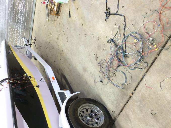

Also pulled out all the original stereo wiring and am going with 4 wet sounds 6.5s (probably not going to install the bow speakers) and a wet sounds 10" free air in the factory location bulkhead looking thing under the passager seat so I keep as much storage as possible by mounting it the free air configuration like the factory. Probably won't sound nearly as good but I can always switch to a box later on if I don't like it. Going to power everything with a 6 ch wet sounds amp which should provide maximum power for only 4 in boat speakers and a single sub plus I can expand and add the bow speakers if I decide to do that or maybe even add a pair of small tower speakers that will all run of one amp.

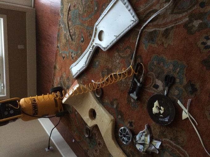

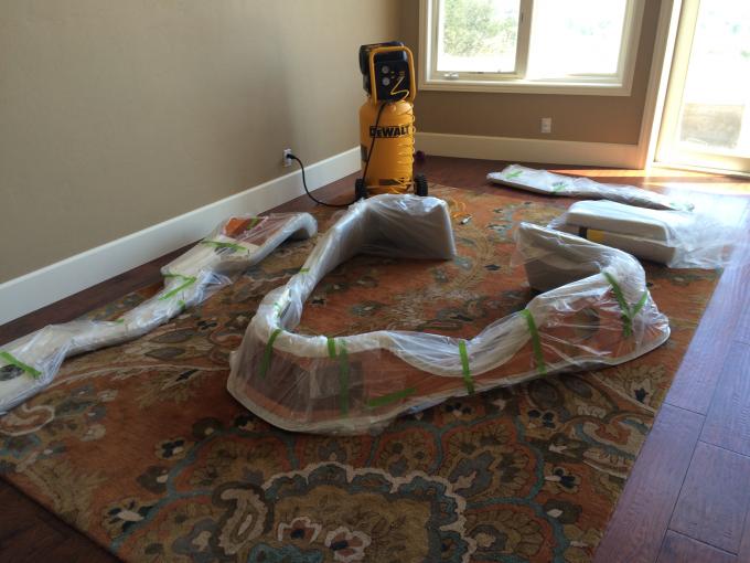

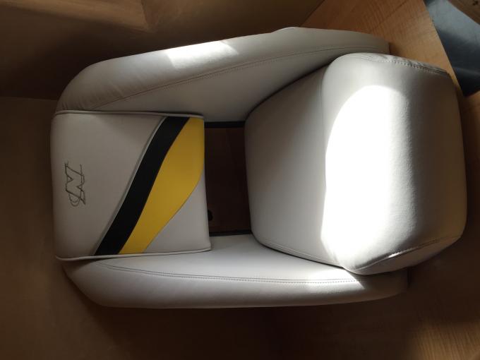

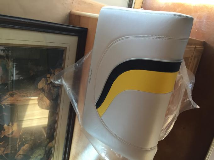

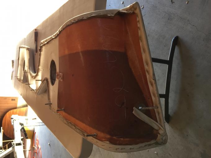

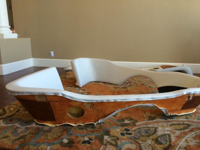

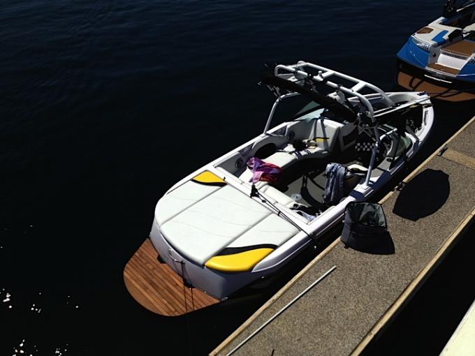

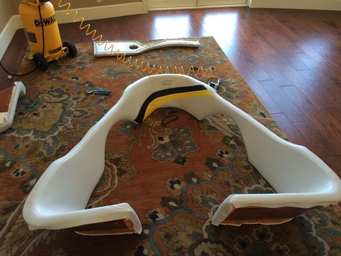

The Christine's marine vinyl turned out very good. The fact that they can replicate the nautique logo was crucial as I tend to like factory configuration restoration projects of any kind weather it be a boat, car, airplane. The colors were just about factory replicated in fact the off white I liked better as it has just a little more Grey in it than the stock vinyls. Installation was time consuming but doable. I did the most difficult peices first like the drivers seat and bow backrest. Really happy with how it's coming out. Still have to do some seats and the rear hatches. The bow backrest I considering not cutting the speaker holes and instead cutting foam to fill them in from the back. The kids fall asleep and end up napping while we are out boating so the bow will be a great spot for them to nap plus no speakers I think looks cleaner. I can always cut them out and add speakers up there at a later time.

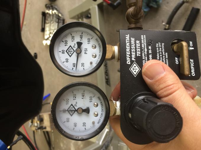

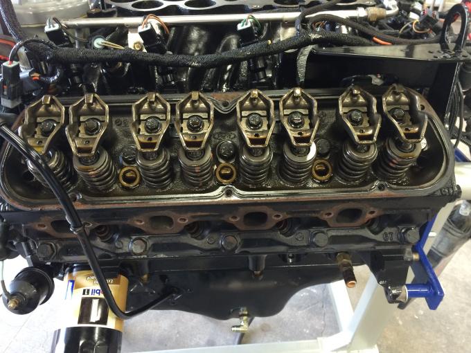

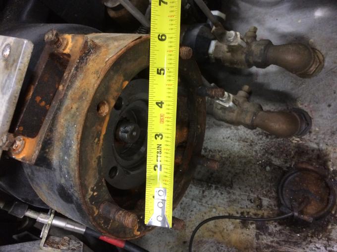

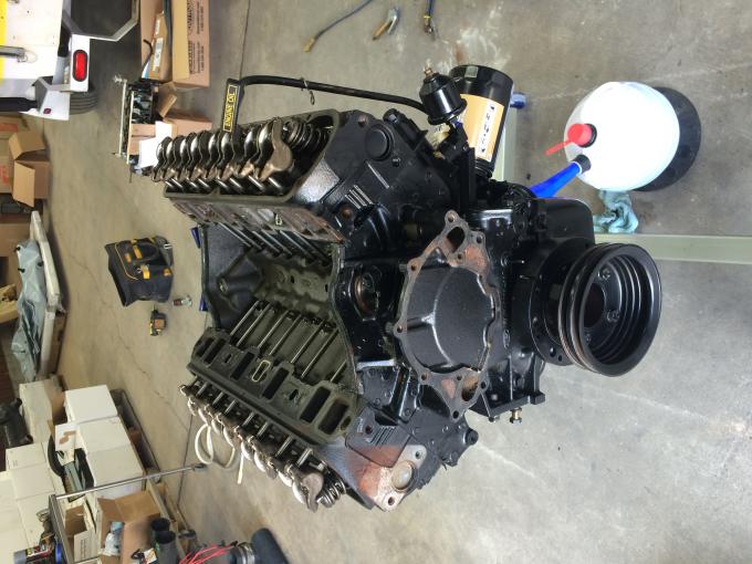

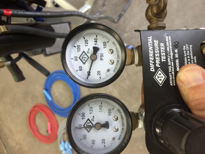

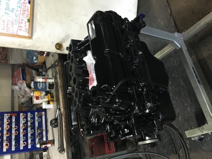

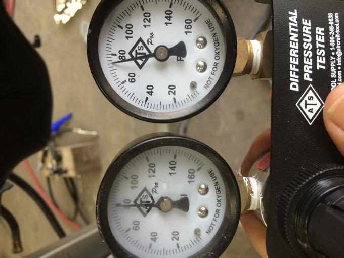

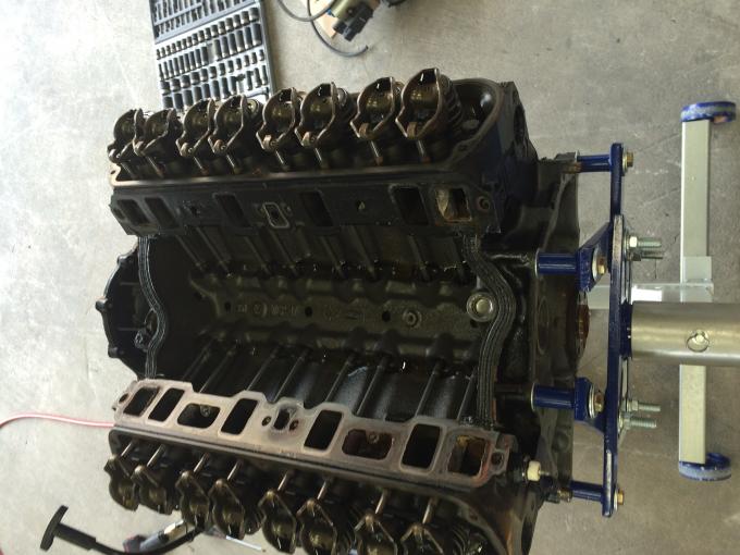

The motor disassembly and rebuild has been my latest project. I took it out of the boat and did a cold leak down test. 3 of the cylinders were leaking 50+% and the other 5 were perfect. I stripped the GT-40 down to the block and heads and trucked it over to my local machinist who spec'd everything out and in the end said it was in very good shape. Super clean inside just needed a valve job which he said is common in marine engines because often they really don't get used enough to keep the valve seals and seats free of rust and build up. I had him replace all the bearings on the cam shaft and crank since we had it opened up and also put new piston rings on. Also stripped the block and heads and repainted them and put on all new felpro marine gasket kit and both crank seals. Below are pics of the disassembly and leak down.

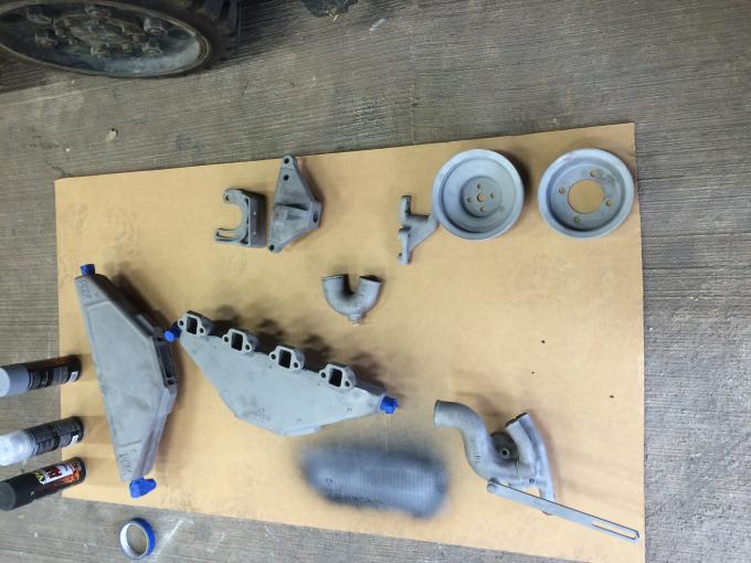

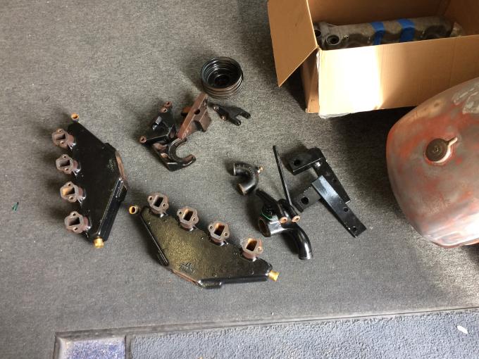

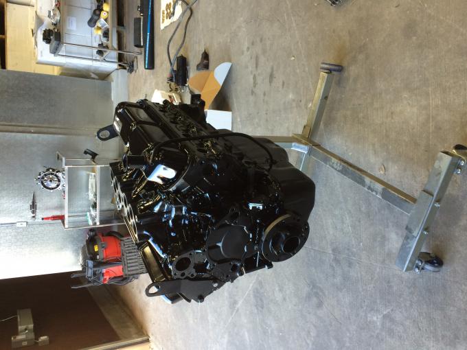

With engine block and heads back I started on all the external engine components. Every engine component got sandblasted and painted individually so that I could get full coverage of each part. Hopefully it will cut down on and future rust and corrosion that gets started with time. The sandblasting really cleaned up the water jackets on the exhaust manifolds and risers.
