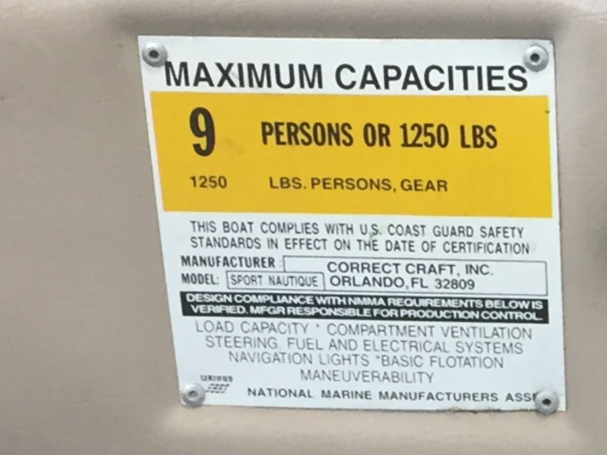

    My 2000 Sport has a 1250 lb. max weight limit/rating that includes persons and gear, if I fill my 2 650 lb. bags I’m technically already over weight. The law enforcement at my lake can be real sticklers (putting it nicely) on laws/regulations.
    I have seen threads of guys putting crazy amounts of weight in smaller boats like mine to try and get a better surf wave and it makes me wonder if anyone has been ticketed or the like for being over the boats max weight.
    Sooo… my question is, has anyone had any issues with law enforcement when weighted down over the boats max weight to surf?

      That’s a coast guard rating. In some states it’s legally enforceable if you go over the weight. In some states it’s not. Not sure about PA.

              This always comes up and is a huge “gray “ area as enforcement and laws. It truly is a jurisdictional dependent answer.
              1) Coast Guard placards on boats are not law , they are guidelines. Simply using that as the basis for a ticket depends on local state ordinances , but again there is no hard a fast quantification used for those placards that is absolute or law . It’s a simple generic estimate , nothing to do with actual design from MFG’s. There is quite a bit of subjectivity in those.
              2) water weight is neutrally bouyant. Fill your tank or fatsac and throw it overboard( kidding don’t ) it will float , well the tank will but the fat sac will just sit below waterline and stay bouyant . Its been relayed from industry people that this is the reason wakeboat capacity plates don’t include ballast on their “nomenclature “. Is that gospel ? IDK , but seems to have validity.
              3) A huge majority of overloaded boat tickets are based on waterline distance to rub rail , or safe operations based on the amount of available seating, where people are positioned , and operation. It’s mostly “officer’s discretion “ and they need to simply note how or why they think you’re overloaded in areas that don’t treat the placard as law .
              with that said
              PA law adapts the capacity plate as “law” according to their language in subsection D
              5501. Reckless and negligent operation of watercraft.
              (a) Reckless operation.--No person shall operate a watercraft in, upon or through the waters of this Commonwealth in a reckless manner. For the purposes of this subsection, reckless operation means operating a watercraft in a manner that consciously, willfully and wantonly disregards a substantial and unjustifiable risk to the safety of persons or property in, upon or along the waters of this Commonwealth. Reckless operation of a watercraft involves a gross deviation from the standard of care that a reasonable operator of a watercraft should observe under the circumstances. A person who violates this subsection commits a misdemeanor of the third degree.
              (b) Negligent operation.--No person shall operate a watercraft in, upon or through the waters of this Commonwealth in a negligent manner. A person commits negligent operation of a watercraft if he operates the watercraft without due regard for the safety of persons or property in, upon or along the waters of this Commonwealth. Negligent operation of a watercraft involves a deviation from the ordinary standard of care that a reasonable operator of a watercraft should observe under the circumstances. A person who violates this subsection commits a summary offense of the first degree. Negligent operation is a lesser included offense of reckless operation of a watercraft.
              (c) Aquaplanes and similar devices.--No person shall operate or manipulate any boat, tow rope, aquaplane or similar device in such a way as to cause the device or person thereon to collide with or strike against any object or person or in any way cause damage or injury to any object or person. A person who violates this subsection commits a summary offense of the first degree.
              (d) Exceeding capacity prima facie evidence of negligence.--Exceeding the loading and horsepower limits for a boat as provided on the capacity plate issued for the boat is prima facie evidence of negligent operation of the boat.
                This is what I was referring to but the lake we frequent is in Maryland so I was not sure if the capacity plate is law in all states I would think it is.
                Click image for larger version  Name:	F285C048-0C11-49A9-8194-6E70193BB1AF.png Views:	0 Size:	437.0 KB ID:	653645
