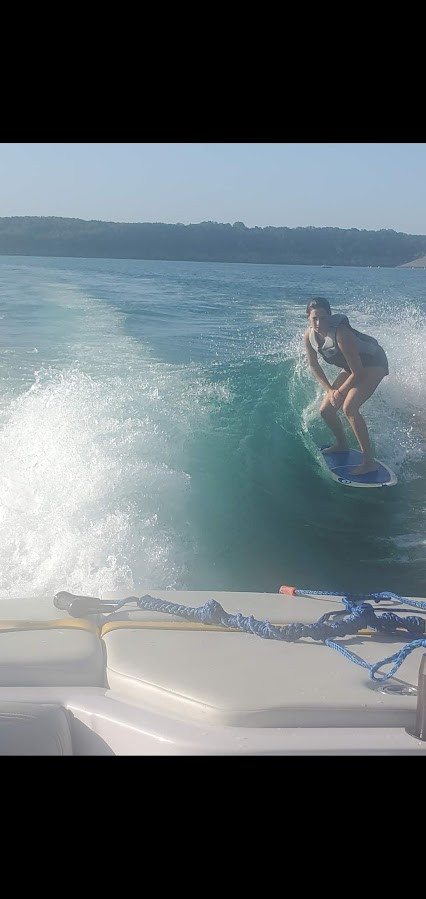

I have a 2006 220 TE SANTE. I pulled my hard tanks, put 1100's in the rear, piggybacked a integrated nose sac off the stock belly tank and use a swell 2.0 shaper. This is the portside wave now. I used to piggyback the stock tanks with 400's but the wave now is WAY beefier, longer, higher. However one of the biggest upgrades to getting a consistent wave quickly was upgrading my prop to the 1234 from the stock 644. The 644 was trash for my Zr6 6.0.
