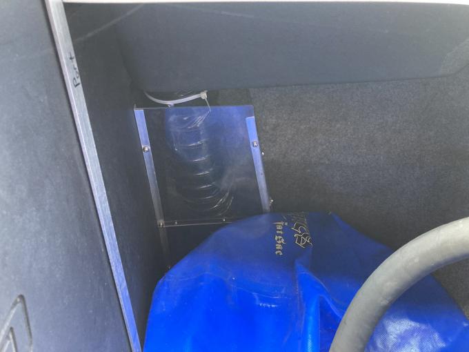

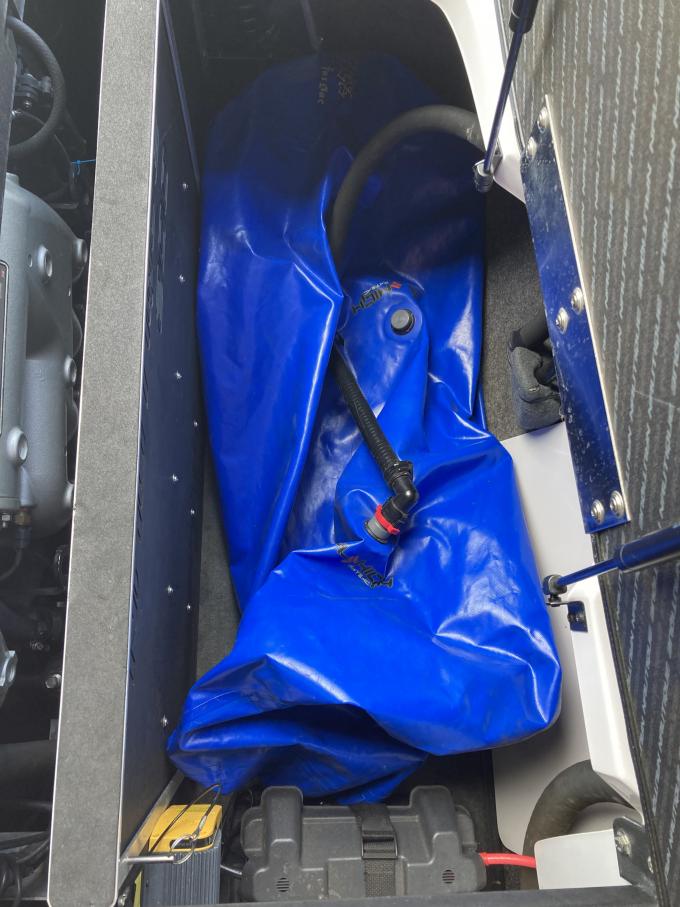

    I have seen some posts about surfing this boat so I figured I would post our setup. We have 750 lb bags in the rear lockers. Full on surf side only. I have found that listed produces the best wake. Tried using a wake shaper but I didn’t think the wave was as clean as listed. Belly tank full. Depending on crew I will add a 400 pound bag between the driver and observer seats. Speed about 10.2. Hydro gate forward when surfing port and back when surfing starboard. Will post videos when I figure out how.

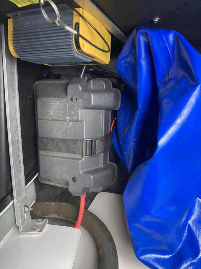

    Where is your battery located? Part of the issue I have with pulling the tanks is that my battery is sitting near the front of the left locker and I'm not sure how that would effect the battery location if the tank were pulled.

        Bturner. Battery is in the same place. I just moved it forward in the locker so that it is up against the back seat. I’ll post a pic later

          Pics of battery and rear ballst

            Did you pull your hard tanks out?
            • Lakejackson
              • May 2012
              • 160
              • Lake
              • 2011 Sport 200
              Yes.
