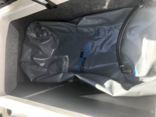

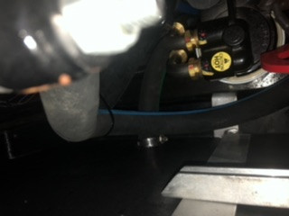

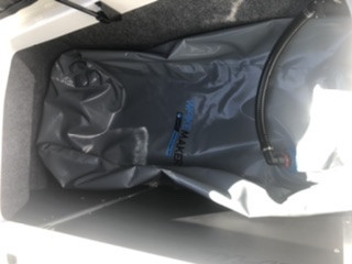

      #32
      here are a few pics of the install from wakemakers

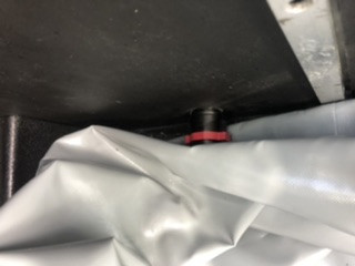

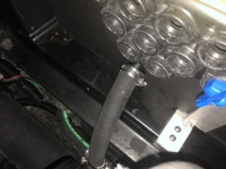

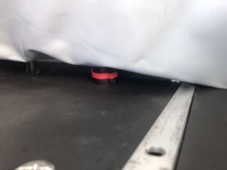

                        #41
                        Does anyone else feel the four 90 degree elbow quick-release connectors that come with the WakeMaker ballast upgrade bags is not the best option? The fill/drain hose coming out of the engine bay on my boat barely clears the divider between the engine bay and rear locker. So when I put the WakeMaker 90 degree quick-release connector on it, it sits facing upwards and the bag gets pinched between the connector and the divider wall. It seems to me that it would be a lot less strain on the bags (and the connector), if they sent it with two straight connectors (for the fill/drain tube) and two 90 degree elbows (for the overflow). When I reached out to WakeMakers, they literally told me they've sold hundreds of these kits and nobody has complained about the setup.
                        Am I missing something? The ProBallast bags had a straight connector between the fill/drain hose and the bag, which seems to make more sense from a longevity standpoint. Perhaps it doesn't really make a difference?
                        • kylant
                          • May 2010
                          • 560
                          • Lake Tahoe
                          • 2014 210 2019 GS22, 2017 GS20, 2000 Air Nautique
                          #42
                          sounds like you may have the old designed bags. my bags (the new design) have a straight fitting on the side, but at the rear of the bag. they point straight at the fill drain hoses and use a straight connect fitting. there is not really enough slack on the factory hoses. in fact, my starboard bag quick connect kept popping out.
                          i ordered a length of hose and 2 straight union pieces from wakemakers. i tried to lengthen the connections and only used the length of the union, nothing more. that made the set up on the port side too long and was actually pushing the hose into the water pump pulley. so that wasn't going to work.
                          the more I looked at it, I realized that the real issue was the connections were getting hung up on the compartment dividers and not allowing any movement. so i just took a 3" hole saw and made the factory holes bigger. now the hoses and connections have a slight amount of free play. the port hose is still fairly tight, I think I will make that hose slightly longer anyway. But so far, so good
