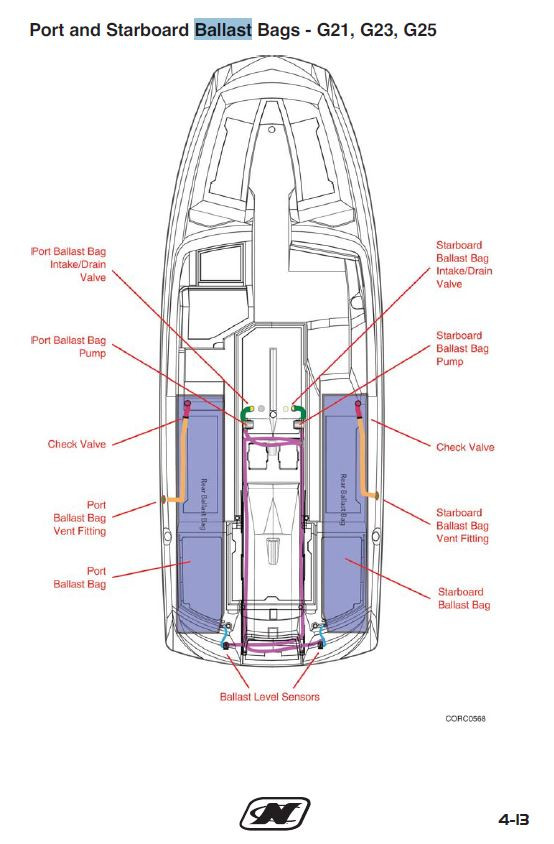

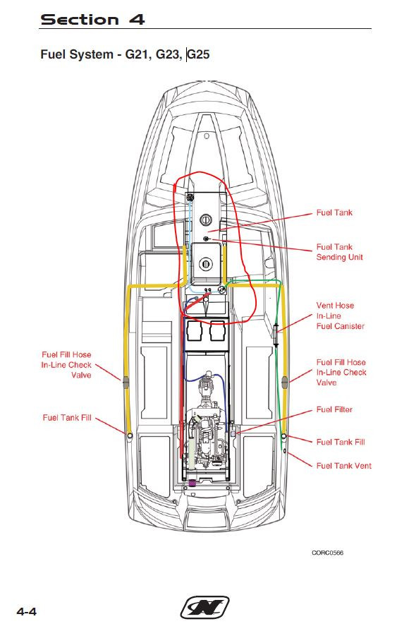

    Originally posted by greggmck View Post
    With such a heavy load I will need to remove rear ballast sooner if my fuel is below 40% because that is weight lost in the forward section of the boat. So I always try to surf with 70% to full fuel.
    I don't think, that your fuel-tank is in your bow.
    I ride with a similar weight distribution. Preferably with a well-filled gas tank about 50-80%. If the gas is completely full, I have to release some ballast from the stern!

      #47
      Its not in bow. Its in the middle of the boat.

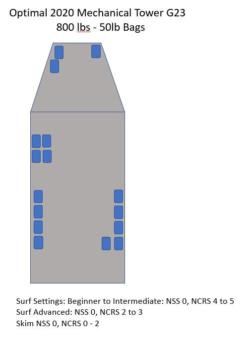

                    #54
                    Today we were surfing the goofy (starboard) side and occasionally we had a washed out wave. The regular (port side) side wave was fine. When the wave washed out I noticed our crew were gathered up in the middle of the boat so I asked one of our crew to move into the bow. The goofy wave became worse, completely washed out. Then I had the one person in the bow move into the rear of the boat on the goofy side. The goofy wave cleaned up completely. With our new 2020 I noticed we had the occasional wave wash out but attributed it to the NCRS not setting properly. However this recent experience had me thinking. My weight configuration was optimized on my 2019 G23 which had the electric tower which has a very large base and is probably much heavier than the mechanical tower we have on our 2020. So I moved some weight into the rear of the boat to compensate for the lighter tower in our 2020. This seemed to clean up the goofy wave so my crew could move around without the wave washing out. Here is the configuration we used today which produced nice clean goofy and regular side waves.
Name:	2020 G23 Weighting Mechanical Tower.JPG

                        #56
                        Originally posted by Daveed View Post
                        NSS 2
                        NCRS 5
                        Speed 11.8
                        • Speed at 11.8 is too much. We ride at 11.5 and that is already on the upper side.
                        • The worst thing you can do, is to move NSS away from 0. Let it stay at 0, so you generate the most out of your hull.
                        • Then with NCRS you can set the level which pushes the stern in or out of the water. With a Crew of 3-4 people:
                          • I ride regular and I mostly go with a 3 on NCRS
                          • My friends are riding goofy, for them we take a 3 or even a 2. If you go on a 4, the wave gets washed out!
                        • Consider the high amount of ballast in the lockers. I wouldn't do that. Mostly, there is at least one guy for the rope (additional weight). Move the weight to the middle of the boat.
                        • Take note about you gas level. It makes differences again.

                            #58
                            The second generation hull (2016 - 2020) does not want weight in the rear lockers for surfing. The goofy wave is clean because prop torque rolls the starboard side of the boat down and lifts the port side of hull. You have put weight in the rear lockers and the port side NSS (the one that makes the goofy wave works efficiently in this attitude especially at the higher speeds you must use to get a clean wave). However, when you switch to regular side, the starboard NSS is completely under water because prop torque pushes that hull side down and you have added too much stern weight. Water washes over the NSS and the wave is washed out. The result is that it is possible to add weight to the stern for goofy wave but not for the regular wave. Rather than have stern weight on one side, most put the weight closer to the tower so that both waves are clean. These ideal weight configurations have been listed above in this thread. If you want to clean up your wave you should understand them and adjust accordingly. All the best.
                            Thank you for that information, and for the previous response from Samu.
                            I have read through the previous posts and, until your reply, never really had a clue as to what the engineering and physics are behind making a surf wave. Obviously, I thought that simply adding more weight would be more better. I was pretty surprised to see how much lead ballast was being thrown around, as I thought my 250 was extreme, but I do see that's it's placed very strategically.
                            First this I will do is properly adjust the surf settings as indicated above and start with factory ballast settings and no auxiliary ballast
