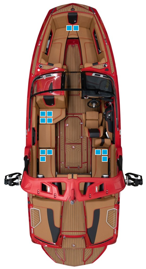

    There are a bunch of different posts with surf recipes - external weight, ballast, settings, etc. I thought maybe we could start a comprehensive thread where people just post what they have found works for them.
    Our current set up:
    '16 G23
    Surf System: Stock surf setting
    Factory Ballast: 100% all around
    Extra Ballast, 12 bags - 100 pounds nose. 200 pounds sub compartment against rear wall, 150 pounds under port flip up bench seat, 150 pounds under starboard flip up bench seat.
    We also swing the Acme 3345 prop with the supercharged engine - lower surf RPM.
    Blueroom Set Up (50 pound bags):

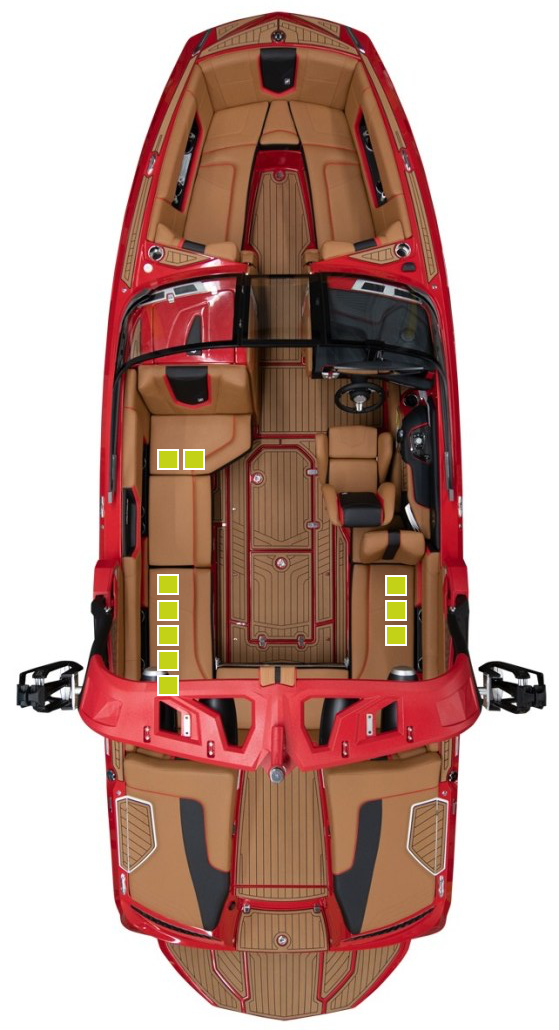

      The Hockley's, both accomplished surfers, shared their G23 recipe on Instagram last year:
      NSS - 0
      NCRS - 2
      Speed - 11.4 to 11.7
      100% in all ballast tanks
      Extra ballast, 10 bags (500 lbs total) - 2 in sub compartment against rear wall, 5 under port flip up bench and 3 under starboard flip up bench. When riding goofy they shift 1-2 bags from the port bench area to the floor in front of the starboard bench.
      They mentioned that the reason they use extra weight is that there is typically only 1-2 people in their boat while surfing, so the weight helps with the empty boat. They don't feel that the G23 really needs the extra weight.
      Hockley Set Up (50 pound bags) - shift two port side bench bags to starboard for goofy wave:
