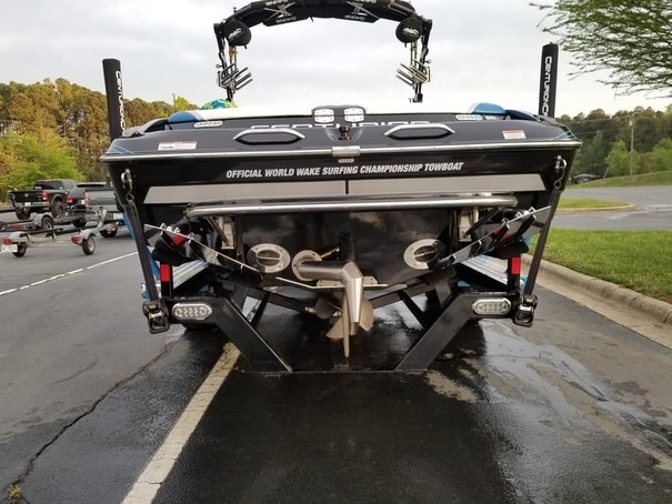

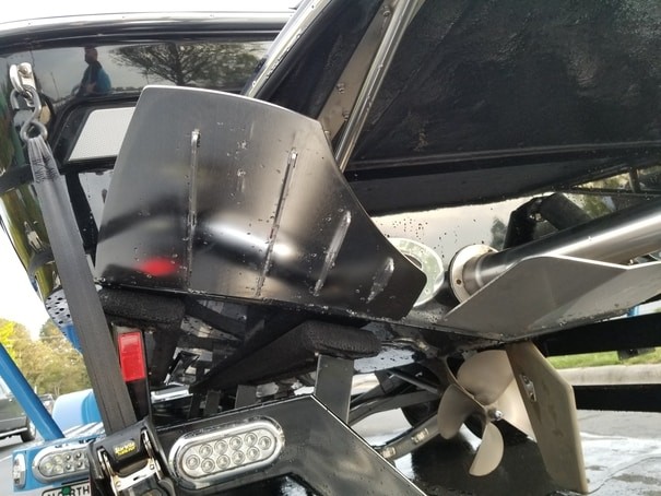

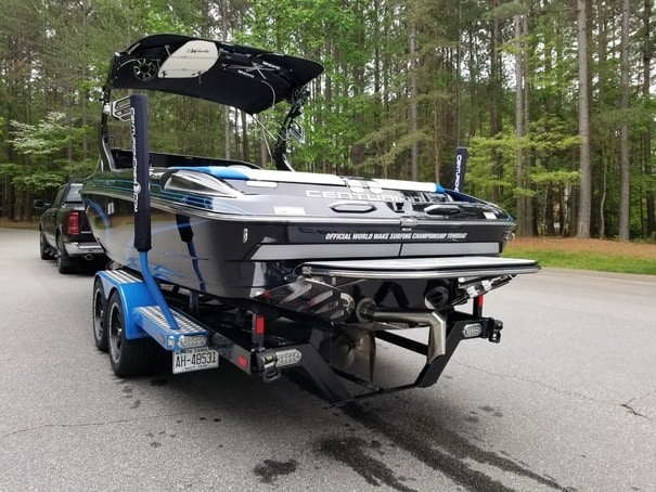

        All the after market surf tabs stick out some that I have seen. I have different surf tabs on my boat from InfinityWave Surf Shop that I installed in April of this year. They produce an awesome wave on my boat too, create excellent push with the fins directing the water toward the wave similar to GSA. I have the surf size swim platform, these tabs are not as long as the GSA but are a bit wider, so that is where they stick out some on my boat. I just make sure anyone new makes sure to watch out for them, not too different from the center trim tab or boats with FAE. I have all 4 and so far no issues with anyone getting hurt.
        Couple pics of the InfinityWave surf tabs on my boat, they work great on my Deep V boat. Newer company so cost is half of GSA @ $2k.

                      There are definitely pluses and minuses to GSA and depending on the boat and use there will be more in one category or the other. With the cost of new or even used boats with Covid pricing added in the case for modifying what you have keeps looking better especially if you have the boat paid for. GSA works well without a doubt but there is a form/function/cost/safety calculation that needs to be worked out on a case by case basis. I've seen these systems implemented on some MCs and they look as if they could have been an OEM system that tucks up nicely under the platform. I've also seen installations like post #18 that look like a nightmare safety issue just waiting to happen. I get the chills just thinking of someone slipping off the platform or worse yet the sundeck and sliding into that meat slicer of a surf tab. There's no way I personally could (or my wife would let me) put a tab system that stuck out past my platform on my boat for fear that someone could slice themselves open. For me personally it just wouldn't be worth it.

                          btuner has a good point about the tabs sticking out. I kind of forget about it now tbh. I'm just used to it. I was very worried about it the first season. Here his is a pic of how mine sits with the warning labels. I personally never had an incident, and we spend a lot of time at the sandbar. For me, and where we surf (narrowish river) not having my steering in both directions with the delta was a bigger safety risk. The GSA automatically retracts and even deployed has was less impact on steering and control. Especially if someone less experienced is driving.
