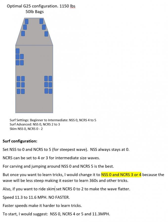

                          Keep in mind surf weighting of the G series very much depends upon the year of the hull design. Pre 2016 hulls can take weight in the rear lockers while the 2016 - 2020 hull wants the weight to be more midship. The 2021+ hull wants weight in the center to rear. Here is the configuration I have found to produce a fantastic surf wave for the 2016 to 2020 G25 Hull. Each blue rectangle represents a 50lb bag. You can use weighted bags or people to achieve a great wave so adjust accordingly to your typical crew size.

                            thanks for the post. I started looking at newer Mastercraft boats, like the Xstar and the X24, because I was concerned that a 19 G25 wave would not be comparable to those boats. I was told that a G25 would need to add a couple thousand pounds of additional ballast to make a similar wave to an Xstar or X24. Which makes sense, considering the G25 has less than 2500lb factory ballast, whereas the Mastercrafts have 4000lb+

                              Gregg - do you have any thoughts on ballast for the '22 G25 with the supplemental ballast package? I'm coming off a '17 G23 and while the wave on the G25 is crazy long, it feels a bit mushy compared to my '17. I can get a lot better pop behind my neighbor's '16 G23. I have 250# under the passenger side and 100# under each tower and am riding 100% on all ballast at 12mph. Going to try backing off the speed next run to see if that makes a difference. Thanks for any thoughts you or anyone else might have!
