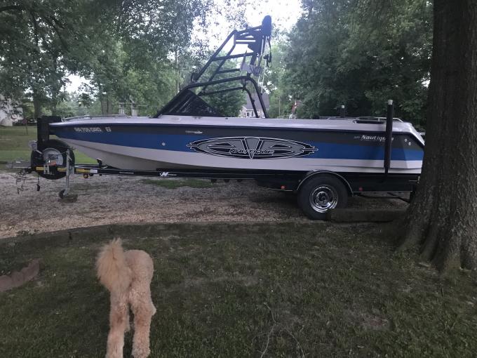

Also, what is a solid price for a 97 SSN. New interior, perfect pass, 458hrs. Just curious what the going price is. Currently only have one pic.
Nice boat! Yes, 750 per side. If you need to purchase more weight, Wakemakers have universal sacks, with all sorts of dimensions, my 910's (45"Lx20"Wx25"H) fit pretty good in the rear lockers. I just don't fill them all the way. My theory was when I don't have a full boat I can still get a nice wave with just 2 people and a rider. FWIW, I noticed a lot more push with the 910s over the 750s. Another thing to consider is board selection, rider weight and overall push of your wave will play a factor in learning how to surf and surfing ropeless.
The SSN and SAN share the same 210 hull. The options such as tower, auto ballast, PP ect make up the SAN!Originally posted by Duckman1 View PostHas air stickers on it. Previous owner did that. It’s a super sport though.

You'll enjoy SS-1997 CC was on the forefront of the V-drive movement. Wakeboard was still in its infancy so towers were all after-market additions. I also own a 97 SS that we bought new, my family has enjoyed it ever since. We don't surf off of it...being I still try to get a few ski runs in. As you noted the only after-market item I see beyond the tower is the newer graphics and the PP (as far as I know it wasn't an option in 97)...came more into being in the early 2000s. One other note many SS use tandem axle trailers.
