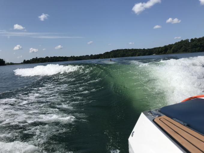

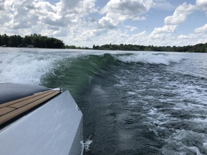

Here are pics of the Starboard and Port wave from our 2018 210. Full Belly, full rear plus 750's near full each side even. Speed 10.6 NSS at 3 and Hydrogate at 5. 2 adults in the boat (1 driver and 1 passenger). I've gotten to the point on our 2018 that I rarely add extra weight in the bow. If I have a passenger up there I'll take some weight out of the belly as it seems to give even more height to the wave and increase push.
Have you just removed your trays or do you fill the 750’s until they start to push on them?Originally posted by F725 View PostHere are pics of the Starboard and Port wave from our 2018 210. Full Belly, full rear plus 750's near full each side even. Speed 10.6 NSS at 3 and Hydrogate at 5. 2 adults in the boat (1 driver and 1 passenger). I've gotten to the point on our 2018 that I rarely add extra weight in the bow. If I have a passenger up there I'll take some weight out of the belly as it seems to give even more height to the wave and increase push.
