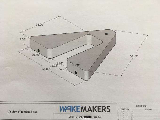

ID:	534646 290 lbs. here's the drawing in case anyone needs it.

                            I don't think I would change a thing about the dimensions. It fits very well without bulging the bow seats like the generic ones can or will do. I spent a fair amount of time taking measurements. I don't need/use the hole on the port side. The fill/drain hole is the bottom rear starboard hole. Rear starboard top goes to the vent through hard 90 degree fitting. Front/bow hole is for burping if it's ever needed.
