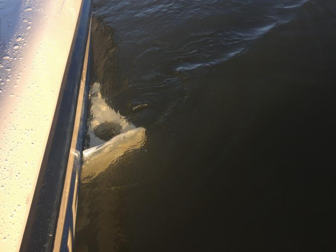

              Here is the shaper I copied, I get it as far back and below water line as possible. I imagine a shaper lower in the water and further back will lengthen the wave as others have posted. Speed is variable for us as we surf in a moving body of water. I have GPS PP and tend to go a little on the slower side, maybe 9.5 - 10.5. The Sport is very finicky, but we surf in deep water 30+ feet, start off slow and avoiding getting on plane, turning the boat (right a little for goofy) a little helps shape it even more, etc...

                  Nice wakeboarding pic! I'm too old for that now. Hah. I also started out with a Mission Delta style shaper. Then made one like Toms/ the Ronix shaper. Had improvement with wake divergence and curve in the wave to give a better and longer pocket. Going to make mine a bit wider as mentioned in the thread come spring. Sounds like we're running close the same weight setup but I need to add 300lbs to the ski locker, on the to do list. Post some vids if you get a chance experimenting with the wave. Glad to see another DD have success surfing.

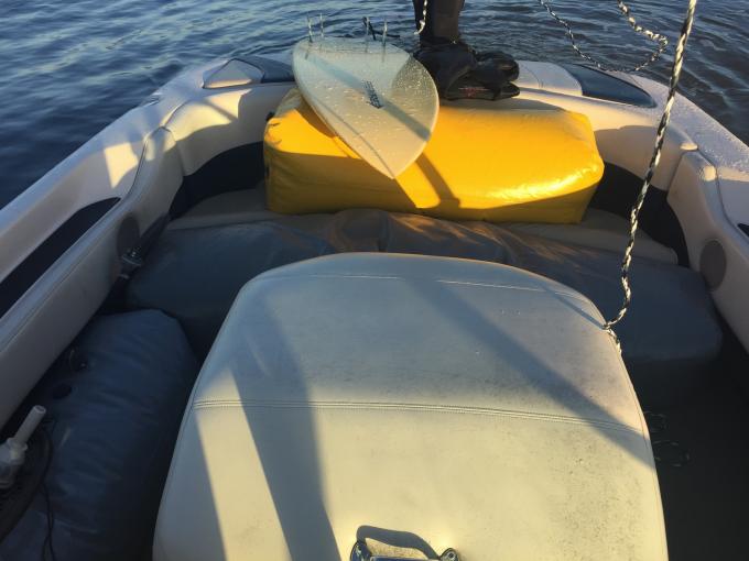

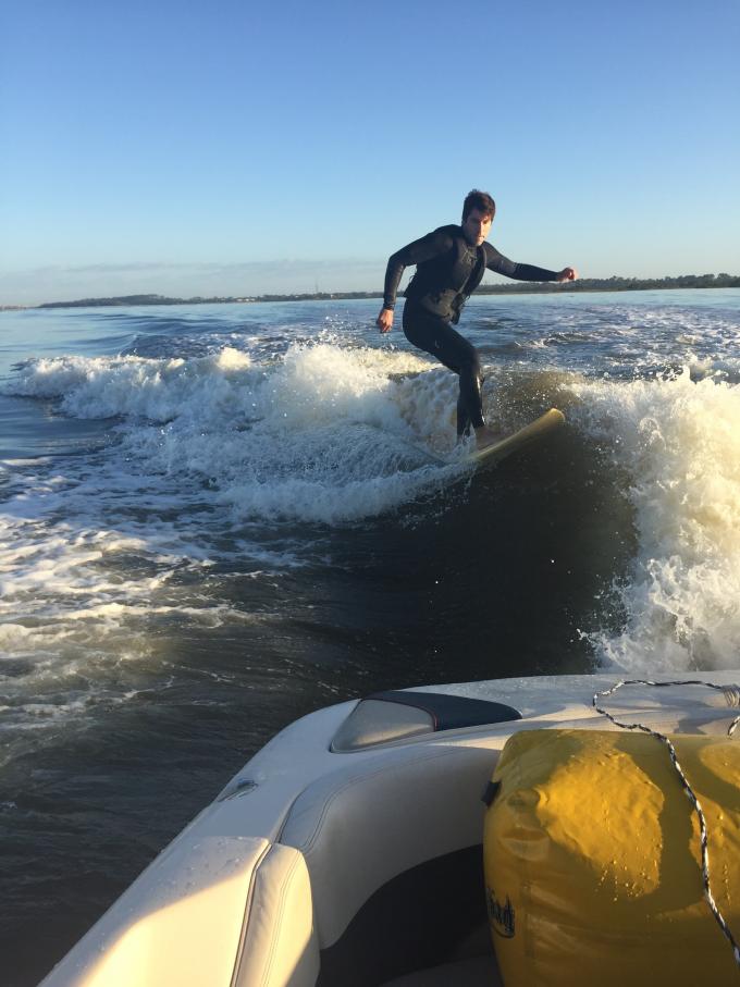

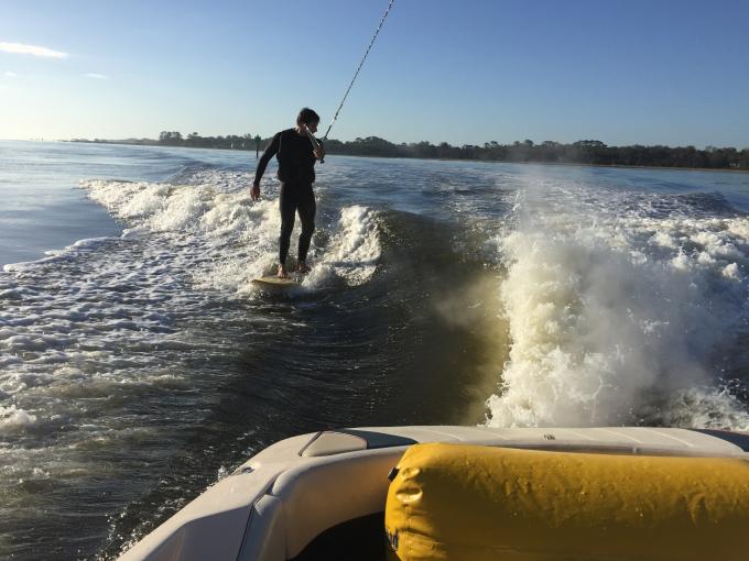

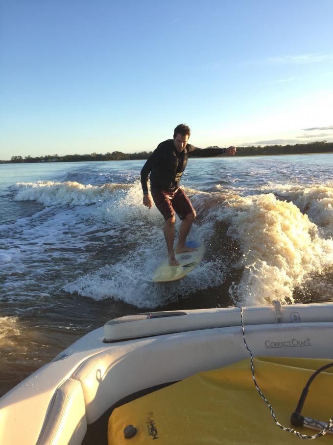

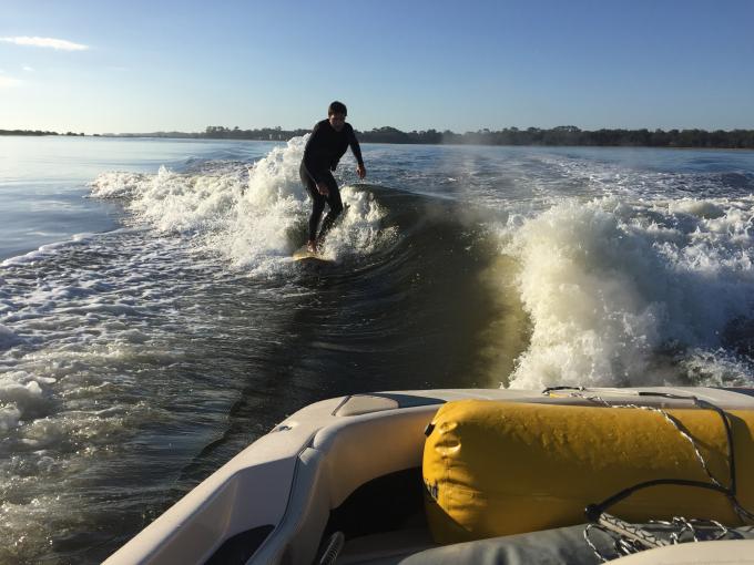

                    You guys inspired me to do better. Added more weight to back and surf side. I'll post video later. Fall riding is great. No one out for over two hours. I also wanted to follow up and say deeper water is definitely better. I'd say 15+ makes a difference. We were able to ride further back than ever before and even had a nice lip curling at times.

                      Nice! That wave looks great!!

                          Wow! That wave is sweet! Best I've seen on the starboard side. Seems much larger than mine. I noticed your floor bag across the back runs the whole length of the bench. I have a fly high 750lb and it doesn't extend that long. Is that a fly high bag? Also, so what was your setup and speed that day? In the first vid when the driver said he sped up a little the wave looked totally perfect. Regarding the shaper pic in the water, was that after filling all the ballast or before? So jealous, I won't be getting out till June but did go cross country skiing in Banff yesterday, hah. Keep the vids coming, with those waves from you and Toms, you guys can try some 360's!

                            Tom, sorry to hijack your thread. First of all...googled banff and seems pretty cool. Scenery must be awesome. The bag is a fly high but randomly bought off eBay. It's super long and kind of narrow. Perfect for behind the engine. Wish I knew the model #. With my ballast system and the (3) bags i couldn't be happier. The shaper is in the water with bags full. It's really hard to suction the wake shaper to the hull so I get it as low as possible, but it's really just below the water line. Kindnof sprays in the boat. need to remodel and make abetter one that fits the step of the boat like you did.'I'll do that this winter. We wakeboard/surf on a river more or less so speed is hard to say. We are between 8.5 and 11 mph depending on current. We start off slow and avoid getting on plane. You're right about the speed n the video, as soon as I sped up the wake got perfect! Happy to keep you stoked all winter . We ride year round!

                              Good stuff. So did you have 300lb in ski locker again? How much on floor surf side and how much on seat? Gonna try to replicate that. Thx.

                                800 in trunk (sumo long)
                                125 1/2 tank gas - usually full, but didn't hit gas station.
                                600 on floor (random fly high) best guess
                                400 on seat (centered)
                                350 (small side sac fly high)
                                350 (ski locker small side sac fly high)
                                50 lb lead wake center on top of ski locker
                                2,675 +/- incl shaper
                                30+ feet of water
                                speed 8.5 - 11 depending on current. Start slow to form shape of wave. Too quick of start will flatten wave. Also have a acme 1868 prop I'm sure an old OJ prop will change the of the wake a little, too. The surf wake is very finicky. You can really feel the water pushing off the rudder. The best wake is when the boat avoids planning off and is in full porpoise mode. If that makes sense.
