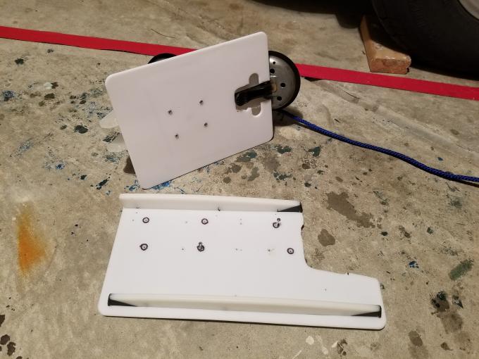

                        #71
                        Yep- pic below- 8.5" high X 11" wide- 45degrees- shown next to other gate for reference .. Also, our lake is down about 3' so was only surfing in 10-12foot depth instead of 13-15'..... So maybe the wave would have been better this time if we had the deeper water.
                        Click image for larger version  Name:	2017-10-10 13.07.23.jpg Views:	1 Size:	50.3 KB ID:	540335
                        1986 Silver Nautique
                        1999 Sport Nautique
                        • zeckto13
                          • Sep 2015
                          • 60
                          • Sherwood Park Alberta
                          • 2020 GS22 ; Past: 2006 SV211 2000 Air Nautique 2003 Malibu 23xti 2000 Four Winns 180OB
                          #72
                          Thanks. I think I'm gonna build the next one at 19" long by 11" high. My last one is 9" high. 11x19 is really close to the Ronix size i think. Will post results in 8 months...hah.
