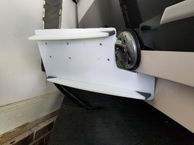

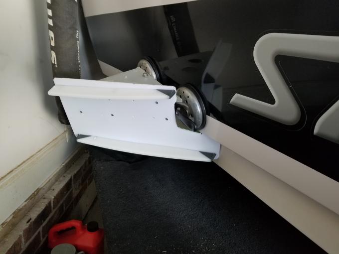

    Here are pics of the gate- along with the side view dimension that you asked about on YouTube:
Name:	2017-08-04 11.08.13.jpg
ID:	533061Click image for larger version
Name:	2017-08-04 11.08.09.jpg
ID:	533062Click image for larger version
Name:	2017-08-04 13.56.14.jpg
    It is at a 45 degree angle and the surface is 8" x 12". That does not include the little extension that goes into the step of the hull...obviously this shaper design cannot switch sides due to this extension but I really wanted to divert the water out of that narrow/lower part of hull. I run it about a foot or two (have tried various distances) forward of where the hull angles toward the swim platform. Also, you may notice that the plate is offset downward on my shaper....this is because the suction cups cannot go any lower thanks to that step in the hull. All of this being said... when I made the in the first post: I was using a previous plate on the shaper that did not reach into the step and was not offset (so it could have been used on either side- and was a little higher since the plate was not offset downward).. But my wave has more push with this newer shaper design. Also, the green plate is just a backer since the white "face" of the shaper is fairly thin and I was not sure if it would hold up- the green cutting board was thicker, but not quite large enough so I just attached the larger white face directly on top of it.
    Well built a shaper like yours...here's some pics. Going out this weekend to test.

      #47
      Nice work! That has much better fit and finish than mine. I have made a test tweak to mine- have not tested yet... this may make it worse, or maybe better. My thinking is that it might help if I reduce the amount of water that slips off of the upper and lower edges of the shaper plate.....or it may make things worse... or spray like crazy, but I will find out.
      (shown farther forward than when in use - because of trailer guide)

        #48
        Also, if you get spray with it mounted like that: just try it with the rear cup a little higher so the shaper is angled downward a bit when the boat is at rest- the raised bow at 10ish mph will angle everything back upwards a good bit- I usually have mine at a decent downward angle to reduce spray:
        about like this is how i run mine: you can see that the rear cup is much higher on the hull color line than the front.
