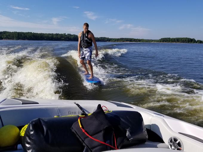

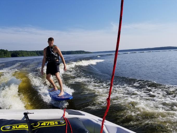

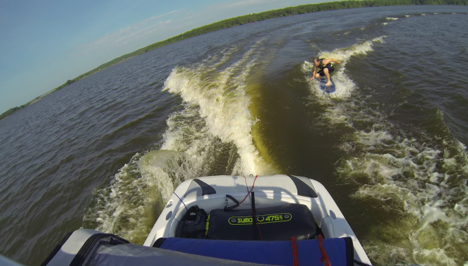

        A few stills Click image for larger version
ID:	533130Click image for larger version
Name:	2017-07-20 09.23.53.jpg
ID:	533131Click image for larger version
Name:	2017-08-04 09.32.57.jpg

          Same here- my 86 surfed fairly well with the gate, 800lbs in place of back seat, and 800lbs next to engine... I had to run the gate fairly far forward though because the hull is rough and the gate would only stick when forward of the 2001 decals.

            Those are great vids and pics. Thanks for posting. Ordered a second suction handle so I can make gates for each side. Hope to finish and get out next week. Before buying a wake surf board you may want to demo a few. I bought the IS Blue Lake, but I actually like my friends Phase Five Danielo Diamond better. Buyers remorse.

              Also, don't forget to drive in a circle (if not already) It seems to REALLY help with my boat (you can see the arc in the pics above) - for example: when we had less ballast and the rider was "fading" a little too far back the driver could turn a little sharper and really help the rider get some more push.....also, the deeper the water the better: I remember riding one time and the wave just totally lost all push and I lost the wave...when the boat came around we realized that we were on a 6' deep spot in the middle of the 15'+ area where we normally ride- it was as if someone turned off the wave when we hit that shallow area.

                Didn't notice the circle but see it now. Good to know! Ya, I've heard that water depth makes a big difference. Will make sure we're in 15+ depth. As an aside, I also have Fresh Air Exhaust coming this week so will report back on my thoughts once installed. Looks like I can't get out this week so hopefully next.
