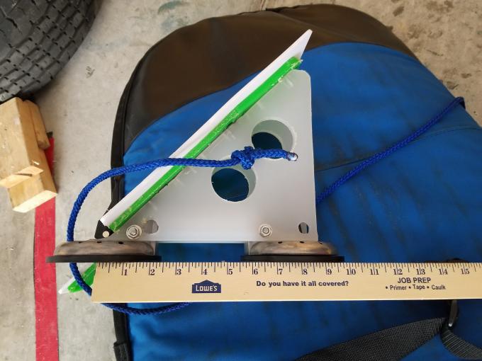

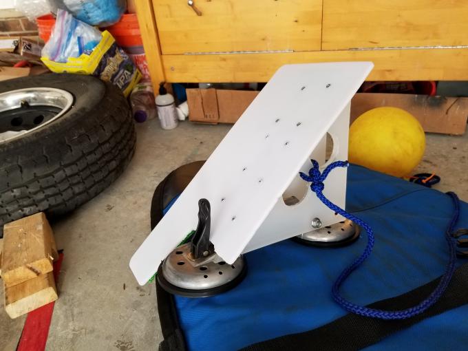

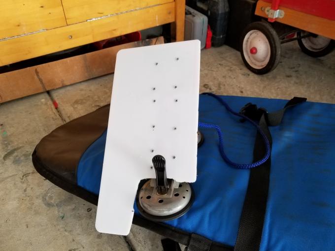

                          Originally posted by zeckto13 View Post
                          Do you happen to have a pic of your gate? And where your putting it on the hull? Headed out this weekend for another go.
                          Here are pics of the gate- along with the side view dimension that you asked about on YouTube:
Name:	2017-08-04 11.08.13.jpg
ID:	533061Click image for larger version
Name:	2017-08-04 11.08.09.jpg
ID:	533062Click image for larger version
Name:	2017-08-04 13.56.14.jpg
                          It is at a 45 degree angle and the surface is 8" x 12". That does not include the little extension that goes into the step of the hull...obviously this shaper design cannot switch sides due to this extension but I really wanted to divert the water out of that narrow/lower part of hull. I run it about a foot or two (have tried various distances) forward of where the hull angles toward the swim platform. Also, you may notice that the plate is offset downward on my shaper....this is because the suction cups cannot go any lower thanks to that step in the hull. All of this being said... when I made the in the first post: I was using a previous plate on the shaper that did not reach into the step and was not offset (so it could have been used on either side- and was a little higher since the plate was not offset downward).. But my wave has more push with this newer shaper design. Also, the green plate is just a backer since the white "face" of the shaper is fairly thin and I was not sure if it would hold up- the green cutting board was thicker, but not quite large enough so I just attached the larger white face directly on top of it.
