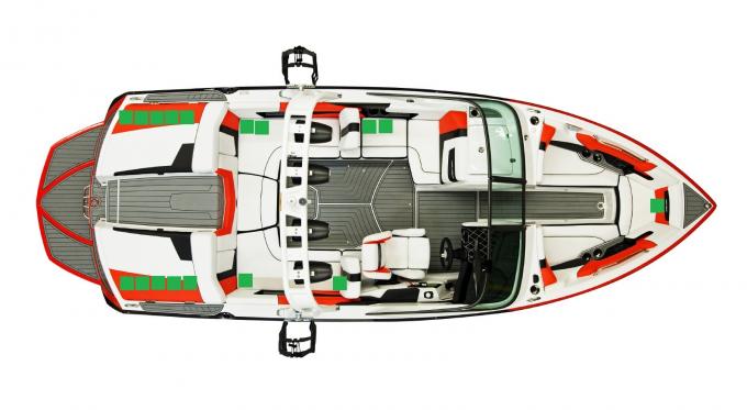

                  Layout of 50-pound shot bags:
