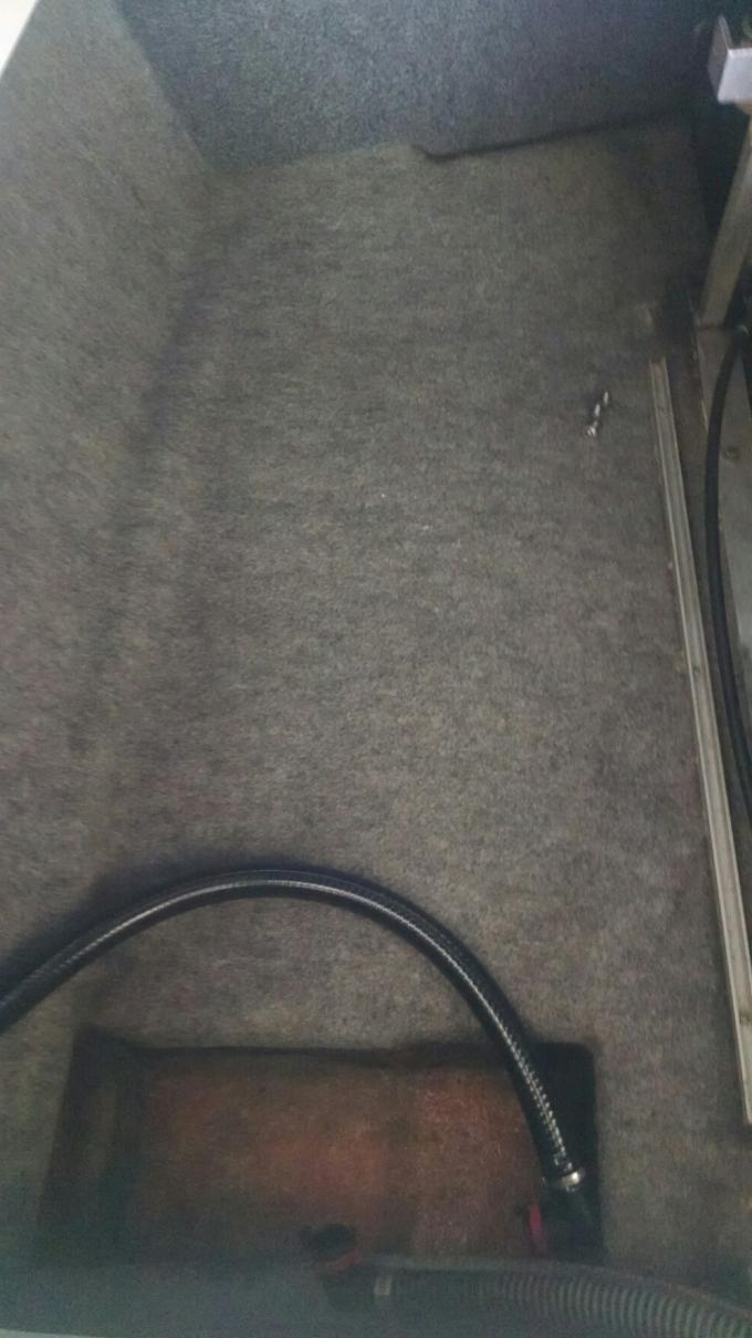

          How do they come out? A bolt through the middle of the holes in the sides and bottom? Is there a bolt left sticking out of the hull that could puncture the bags when they fill?
          So how do you connect the bags? Do you swap the bags tank piggyback connectors to the hard tank feed lines?
          Also, when the tanks come out, is the bottom nice and smooth? Want to make sure nothing is down there to puncture the bags.
          How many ports are required on the bags, 3 or 4?
          How does the electronics work without the level sensors installed? Do you get an error code?

            I can only speak on my 12 but there's L brackets that attach the hard tanks to the floor via lag bolts. The floor has a recessed area in the front of the compartments as the tanks have a drop down section where the fill/drain hose connects. The rest of floor is flat and nothing to puncture the bags.
            I just take the hose of the factory tanks and put a quick connect fitting on it and attach to bags. Don't cut it or anything. I set the factory overflow aside and use a longer aftermarket 1" hose off top of bag to the factory overflow thru hull.
            I use the standard fly high 1100lb sacs they have plenty of ports but only need to use 2.
            I don't get any error codes just need to restart the pumps twice to fill /drain.

                          Empty 230 rear. If I'm feeling really nice I'll inflate my 1100's with air and take another photo

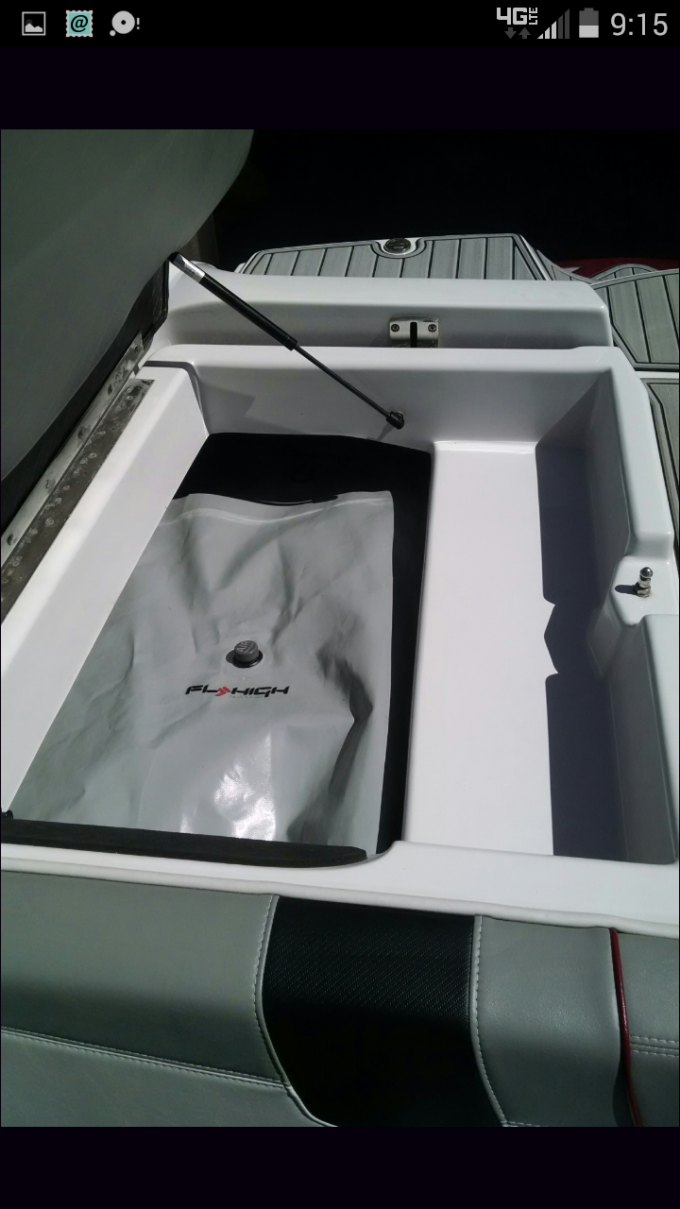

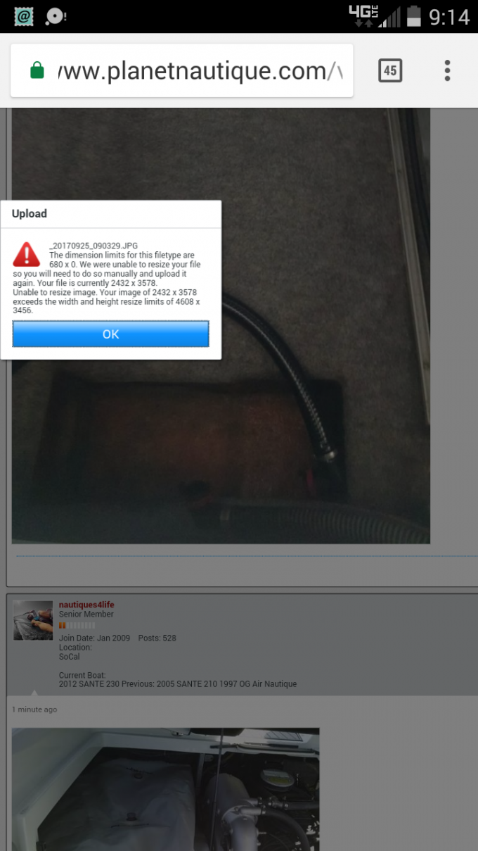

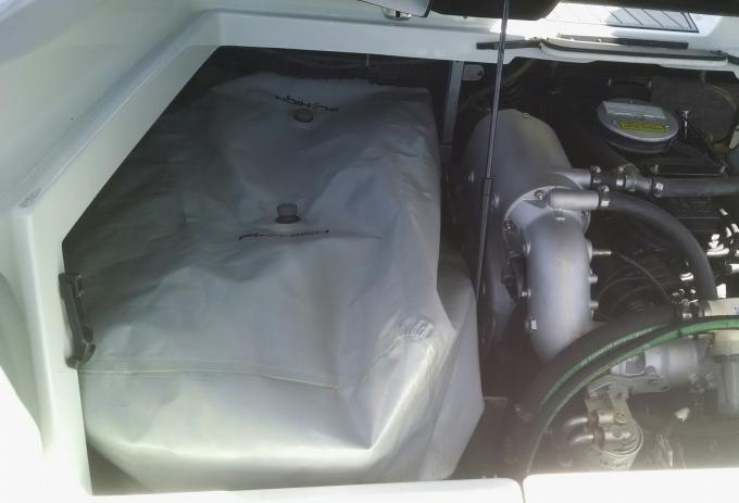

                            Click image for larger version  Name:	_20170925_090404.JPG Views:	1 Size:	29.1 KB ID:	539085 alright, so this was trickier than anticipated, compressor hose doesn't reach the boat... So I filled it up and tried to shove it in. Unfortunately it doesn't fit fully inflated so I had to let some air out. Engine divider is out and it's ~80% full, but it should give everyone an idea of the size/fit of an 1100 in a 2012 230. Took other photos, but this site is a major PITA to upload... Tons of stupid error messages. I give up.
