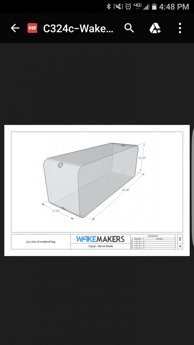

    Got to try out my new 55"X16"X25" custom rear sacks today. So nice and no need for extra support for the dividers either. I also spread 400 lbs of "lead" around too. Hard to believe how much longer this wave is compared to my old 2005 SAN 210 and not having to give up floor space was nice as well. Overall, glad I upgraded to a 230.

        Lead is spread evenly now except an extra 150 lbs is on the port side to compensate for prop rotation. Still playing with it. I wouldn't change anything with the sacks at all. They fit perfectly and I'm so jazzed that I don't have to worry about supporting the dividers. One thing worth noting is there is a limit to how high the vents will allow the sacks to fill. Mine were almost full to the bottom of the hatch lids, but not 100%. There's about 2"-3" of air space left between the top of the sacks and the lids. This is actually okay with me because that means I can still hold a few jackets in there.

                      #70

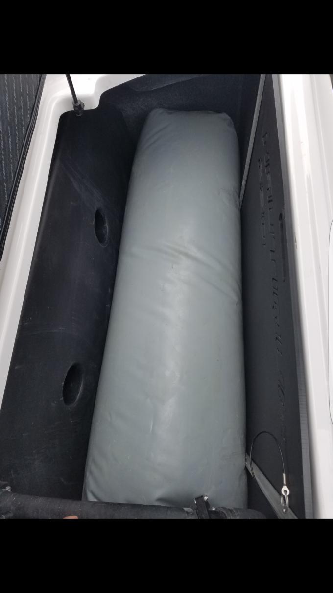

                      Custom bag made

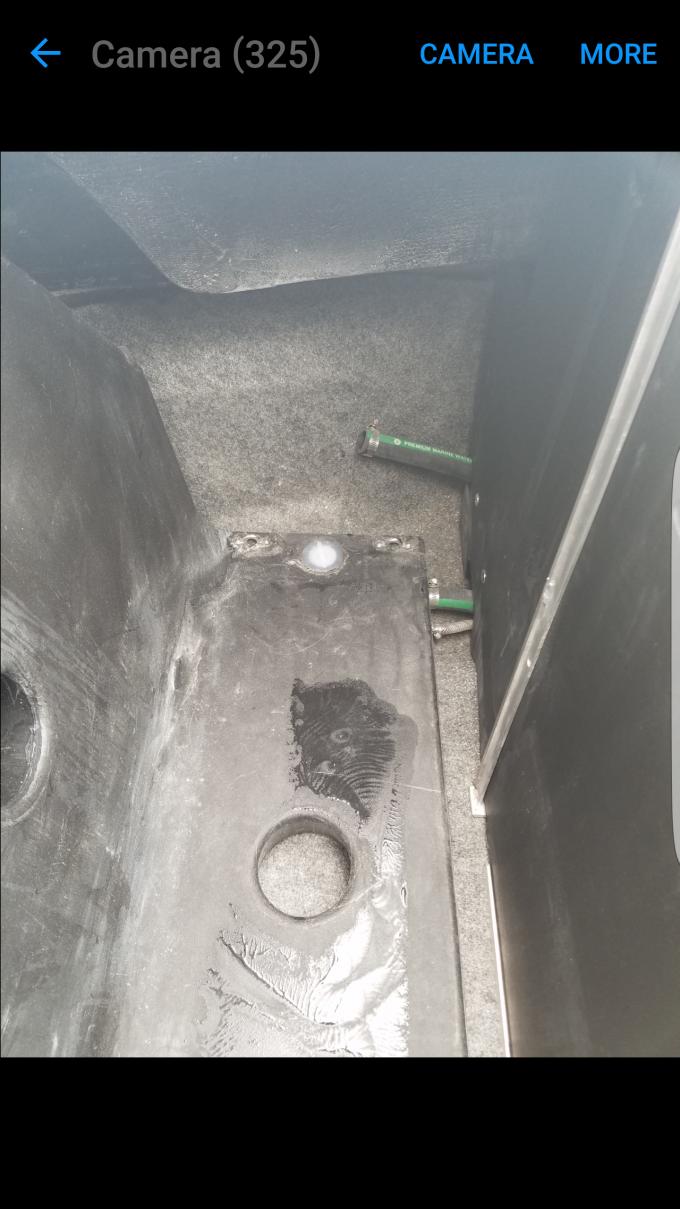

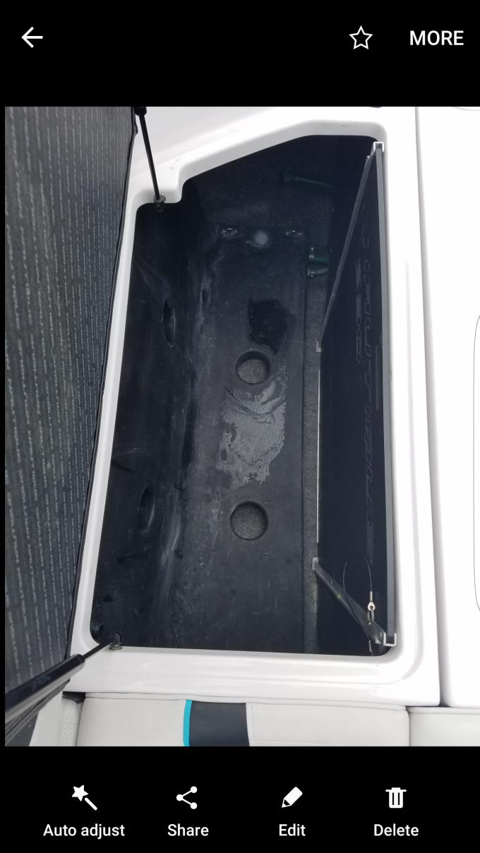

                        Stock bags...notice the extra space in front, behind and above the back of the bags Click image for larger version

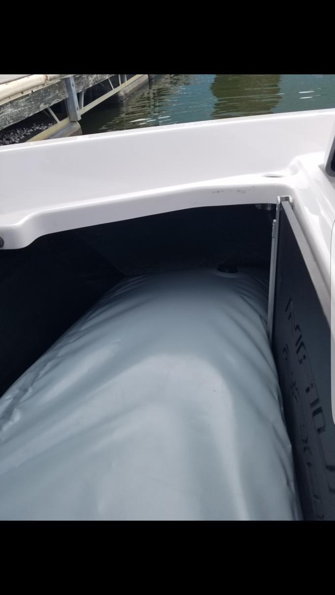

                          #72

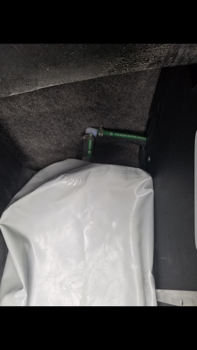

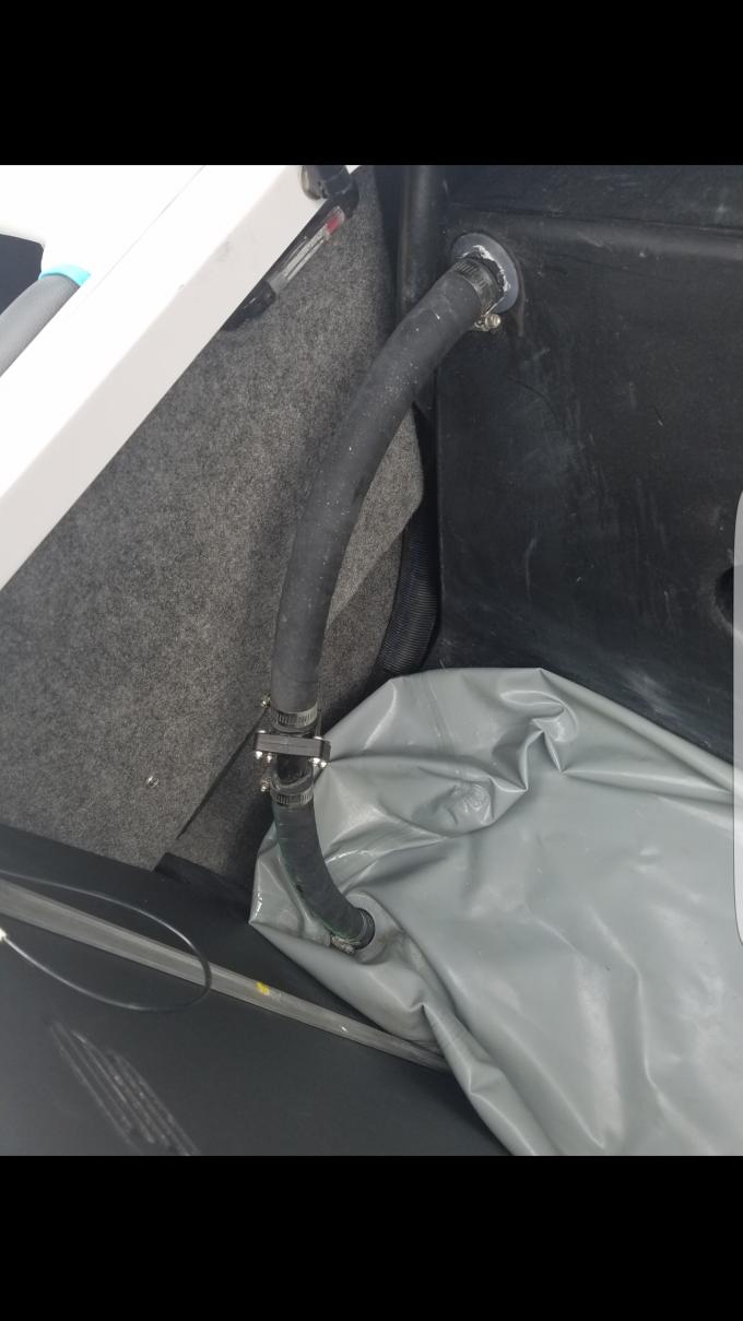

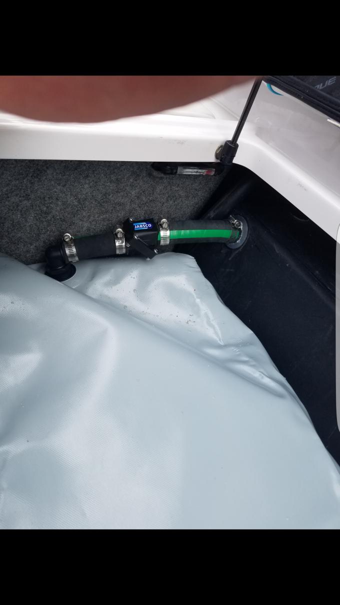

                          Large bag added...the vent hose did have to be shortened significantly so it would not kink when bag is full, HOWEVER, once drained the hose is unable to go down and puts a significant amount of pressure (in my opinion) on the plastic fitting where it goes into the hard tank which i feel in the long run would crack/break this fitting. So the "temp" fix was to attach ties to the hose and to use the back seat screw to mount and hold the hose up so its not overly stressing the hard tank fitting. I do plan to finish this with a better holder the zip ties. I have purchased some thin rope cordage that I plan to finish the project with so it will be flexible and strong (cordage supports about 200lbs so that should be PLENTY to hold and not wear out) Click image for larger version

ID:	487477 . Let me hear if anyone has thoughts/questions/ideas. Also note how much better the bag fill the front and back of the storage areas....I just fill the bag until the trays start to rise then i stop them.

                            I went the opposite way with my vent hose. I put a 90 degree connector on the tank as well as the sack and then used a longer, more flexible hose. The hose came from wakemakers. It's the same hose they use on Malibus. It's easy to work with and very kink resistant too. Mine is around six feet long, just sits in a U shape and goes up and down as it fills/empties.

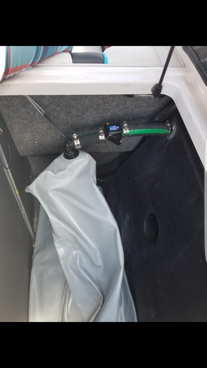

                              • cedarcreek216
                                • Oct 2009
                                • 1009
                                • Dallas, TX
                                • 2018 210 2013 210 2009 216V
                                #75
                                Similar to this.
