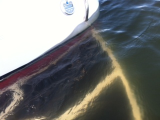

First off, be sure to independently evaluate the geometry (actual volume) of your space -- it is my belief that the stated weight on some sacs include a "swell factor" as opposed to "neat line" volumes of the sac, let alone the actual space you have in mind to place the sac (confined surroundings like a storage locker). (Water is 62.4 lbs. per cu. foot.)
I considered the under seat integrated bow sac (W711) but instead chose the Center Locker Sac (W721) for two reasons: (1) I didn't want to lose the under seat storage which I use for anchor, anchor buddy and anchor rode along with 4 "Wally" style PFDs and 200# of pop products; and (2) having read opinions about boat handling (as well as my experience) with the weight way out on the nose vs. under the floor, decided that the ski locker area was better for me.
I have a "750" (W707) in aech of the two aft lockers plumbed in to the factory tanks, and the W721 to the belly tank.

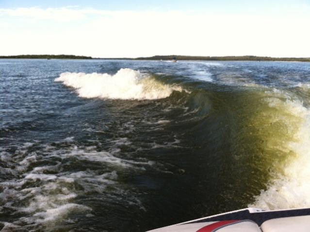

With a few passengers, we have a great surf wave for adults.
For an idea of the size of our wave, the surfer in my Avatar stands about 4'-5"
