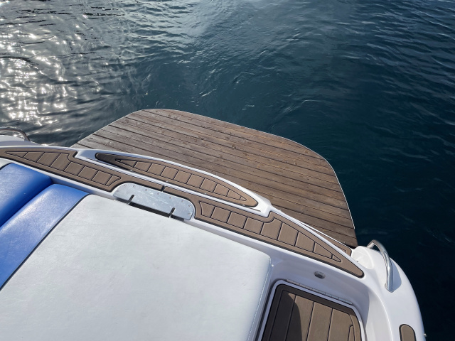

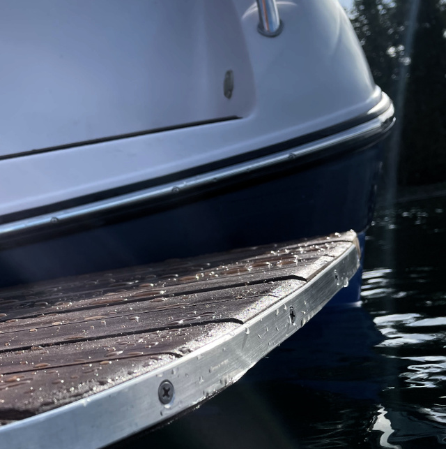

                  I cut 5052 Alum 0.1" sanded & brushed (3M cloth) to make a bump strip. I cut grooves in the planks to make it look like strips. I think it's 1x5" after the cedar is bullnosed and finished. Cedar is a bit janky for sure, being a soft lumber. A harder wood, like teak is more stable. But wood will do if finished with a mix of turpentine, "spar" varnish, and teak oil (33/33/33). that's what the cedar is coated with

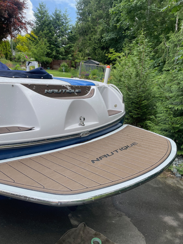

                  Plywood platform with, FG resin, epoxy undercoat, Interlux toplac white topcoat. On the underside screws I wonder about water intrusion since we just sink the platform for surfing.

                      Looks nice!

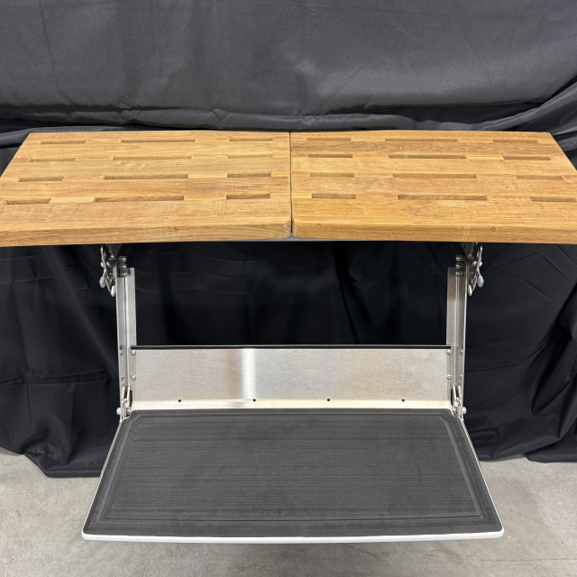

                        Building a wood platform with open slots will reduce the "lift" pressure slightly. Similar to this style. Click image for larger version
