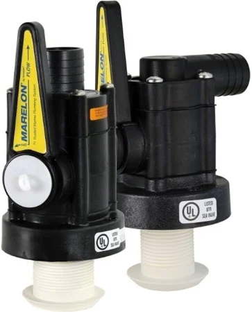

            Yes, there are typically Marelon shutoff valves with integrated thru-hull fittings. And yes if you close those then there is no risk of invasive species due to ballast system.

              Just don't close the one for the engine cooling. There may be multiple of them for the ballast system. There is one for engine cooling.
              And with the valves closed, you could answer that question at the ramp that the "ballast system is disabled".
