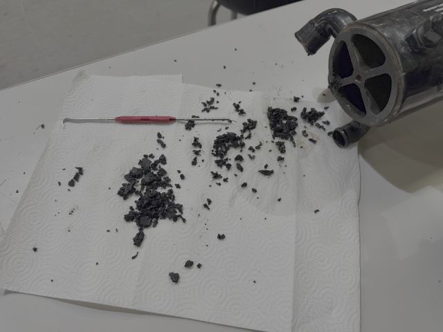

This is a heat exchanger from a friend's ZR6 in his 206 that we were working on today. We had to pull the heat exchanger, use a pick to get as much as we could out of the heat exchanger, and then force the rest out with an air compressor! Major pain, but it is flowing freely now.

Yep. He said he had one fail about TEN YEARS AGO and never found the pieces. We found them!!Please do not PM me directly asking for advice on how to repair your boat. While I would love to help everyone, I simply do not have time to respond to all of the inquiries. Please post your questions on the forum, so that all of our members have a chance to answer.
Dang, that's a mess, compared to a $40 part.
We had a similar experience with a buddy's new to him Centurian this Spring. Dealer said they had replaced the impeller. What they failed to mention was that the old one had blown to pieces. Took a while (multiple lake trips) to figure it out. Fresh water cooling, turned out there were pieces of the impeller lodged in the exhaust manifolds, no bueno.

No real need for a puller on these boats. A couple screwdrivers will easily walk the impeller out.Please do not PM me directly asking for advice on how to repair your boat. While I would love to help everyone, I simply do not have time to respond to all of the inquiries. Please post your questions on the forum, so that all of our members have a chance to answer.
