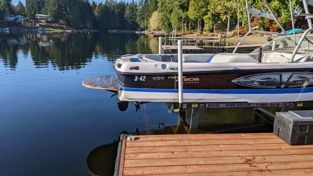

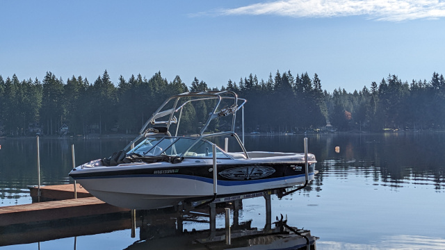

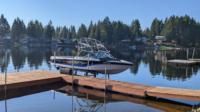

                  $9k for 6k lbs sunstream lift installed? That's a good deal! One year old? Just a baby! My basta's are going on 30 years old...but they are aluminum so I think they last longer. As long as you are salt free, I would guess you have at least 20 years of life in that lift with some basic maintenance. Here in the PNW, Sunstreams are everywhere and are considered a quality brand.
                  Here's a few answers on our setup to bturner questons.
                  - We self installed our lift. Did a few measurements. Assembled on the beach with the correct leg settings, got a crew of about 6 neighbor dudes and just picked it up and walked it in. Easy. Works well if you have a beach and not a bulkhead/seawall. Size of crew depends on the weight of the lift. Ours was about 450lbs.
                  - Getting in/out of the boat is pretty easy. We just lower the boat to the dock level and climb in. A fixed dock helps as you can site the lift closer than a floating dock. But you do need plan this aspect for sure.
                  - No shore power should be needed. All of the late model hydraulic lifts run off a deep cycle battery with a solar charger in a dock box.
                  - Hydraulic lift maintenance for a new lift like this one is simple. Just do a fluid flush every season or two; it's pretty simple for DIYer. Dealer fluid is $$$. We buy 5 gallon pails of a 3rd party marine eco friendly hydraulic fluid to save $. Replacement hoses likely about (conservatively) every 5 years. I think some of the original hoses on my lift where 15+ years old and were OK. At some point, it may need replacement/rebuilt rams and that's more of dealer item. Sunstream's typically have two smaller rams which add a bit complexity. My basta's have a one single big ram.
                  The deep end of our lift is in about 5 1/2 feet of water and shallow end is 4 ft. Lake level goes up/down about 8-10 inches and we have no problems. If you have a lot of water shift and the lift is shallow, you'll need to plan your settings to make sure you can get off in the lowest water and lift the boat out of the water when the lake is at the max level.
                  Our lift has a remote keyfob. Beyond fantastic. You absolutely want this. Typically, this can be retrofitted to the control box if not factory installed.

                    Just for grins...a few pics of our setup. Since these pictures were taken, we have moved liftbox out of the way over to the finger pier.
