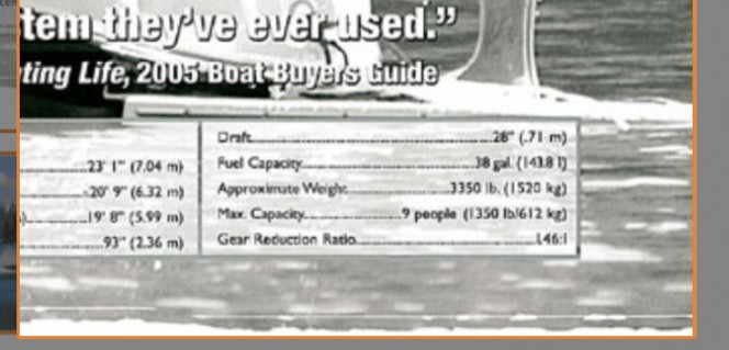

                  Here is the dry weights for 2006 for both boats . 30 lbs different. I know that dryweights can be mis-leading I agree with you that the person who weighed it in the other thread is probably accurate. But I think you would get a similar weight if you took the 210 across the scale. The dry weights are not real life. You could rent or borrow a pickup to go get one or for your long trips (maybe not an option) and I wouldnt worry about towing it to the ramp at 1/4 mile.
