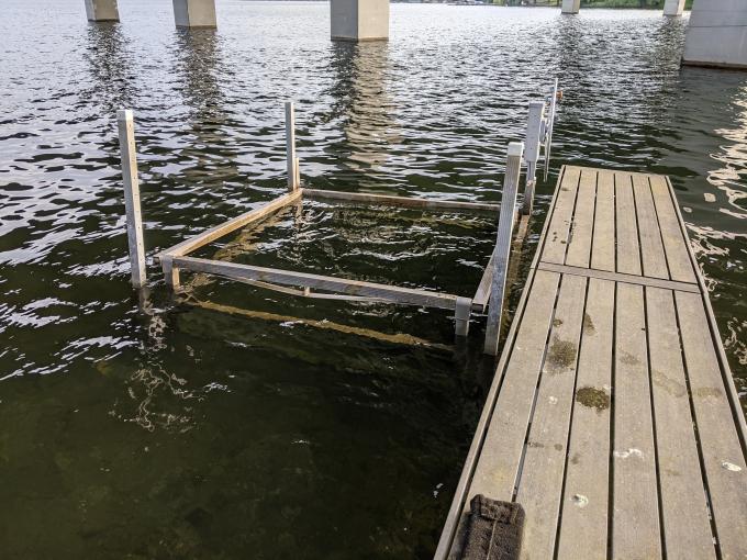

    The lift is in pretty shallow water. I can ratchet strap the barrels on to the exterior, non moving portion of the frame which is at the surface. From there I would 'lift the lift' and push it into deeper water. I think I will float quickly.
    That said, the tube ideas are great...just not sure how to tie them on so they don't twist away and are stable.

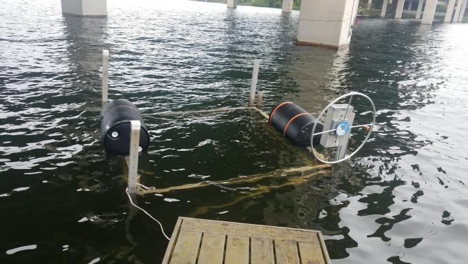

                        Next, strapped on 2 55 gallon poly barrels with ratchet straps. I was concerned about the winch side weight but it turned out to be decently stable.
