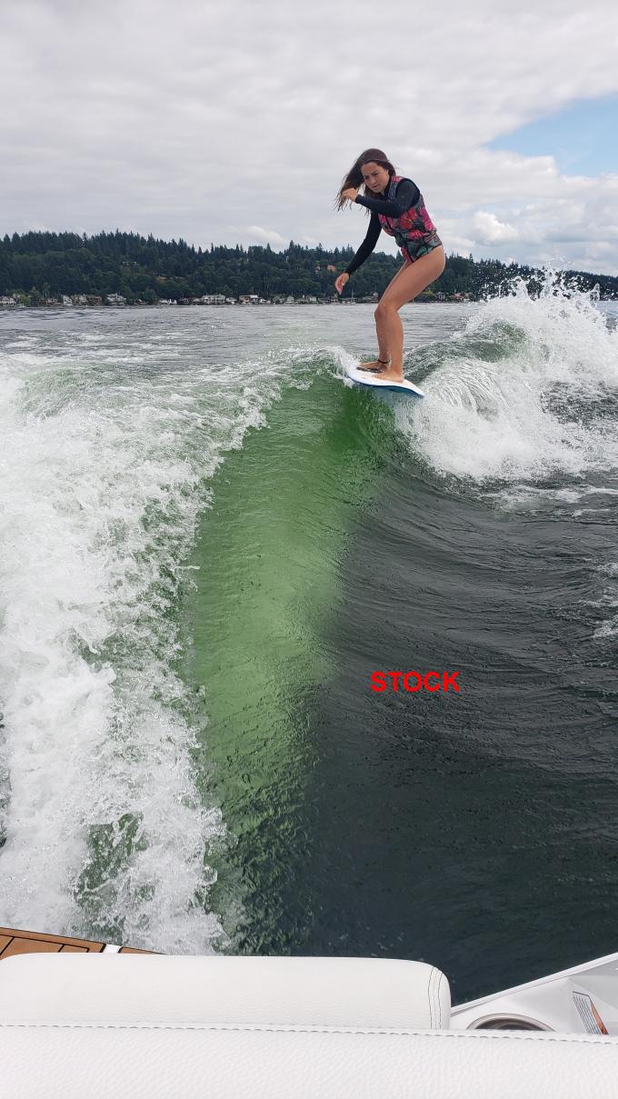

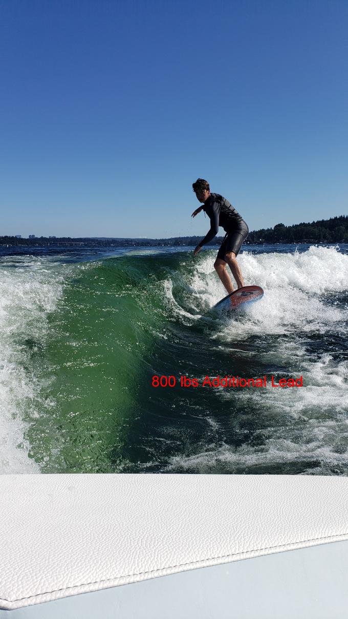

                            I would be thoughtful about adding too much additional ballast to the 21+ G23. In my opinion 2 x 750 lb bags over the stock ballast would be overkill and not in a good way. Perhaps this might be useful for wakeboarding but honestly I would not want that much weight for surf. Take a look at the wave of the stock G23 and the same exact boat with the same 2 person crew but with 800lbs in the second photo. Notice the volume of water of the center section of the wave my son is surfing and the flat, unassuming wave of the stock ballast my daughter is riding. 800 lbs made that much of a difference! I have said it before but never have I seen a hull respond this much to weight. What concerns me is the extra weight made that center section of the wave VERY firm, it felt too hard. After a couple of falls it felt like it could be more painful than I might want. And it wasn't just me. My wife said the wave was enormous but it wasn't fun. My son said landing airs was like landing on concrete. The 210lb local Centurion pro said the shape was awesome but he would want to "tone it down". With 1500 lbs of of additional weight and a decent size crew the boat could put out a fierce wave that may not be that much fun to surf. Just my two cents.
Name:	2021 G23 Stock Ballast.jpg
ID:	632441Click image for larger version
Name:	2021 G23 w 800lbs.jpg
